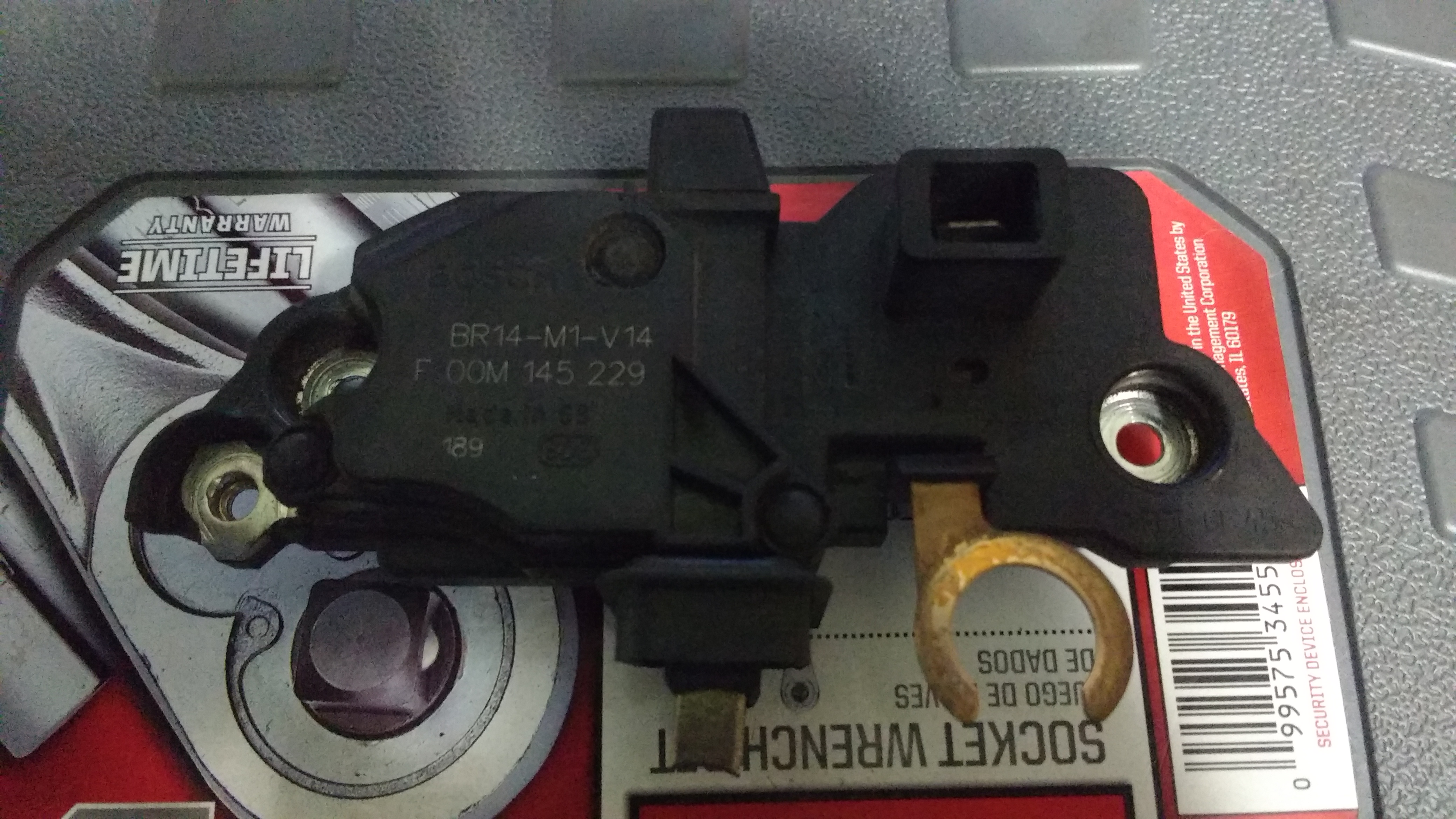

My vote is to replace the voltage regulator with a new one unless you can check to see how worn the brushes are on the voltage regulator on the junkyard alternator.
Here's what the brushes looked like on the original voltage regulator after 235k (new Bosch unit on top, old one on the bottom):
It's been 12 months and 15k miles since the regulator was replaced.

That's got at least 5 k miles left on it, Youre not throwing that away are you??
I tried a two alternators at my nearby pick n pull. Neither worked when i took them to autozone to test them. I finally took mine out this morning to see if it actually is dead. Answer? Yes there was no output when I had that tested also. My brushes looked a bit sunken in like your old one does here's what it looks like
