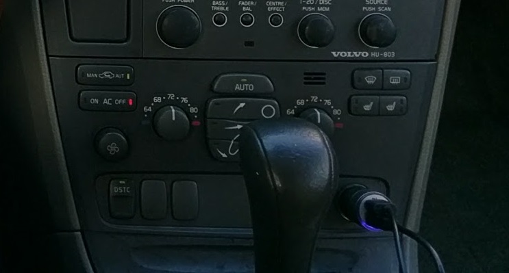

I am looking to Borrow or Buy a ECC for my 2003 V70 T5. I have a CCM-000C error code that I have confirmed is in the Module (motor works on another plug). I've also confirmed via VIDA that the knob does tell the computer to change... there is simply o output on the blue line to the pass damper motor.
Does anyone know something I might be missing?
Here is what I'm looking for...
2003 ECC - DSTC - Heated Seats
I know it's in multiple cars but I couldn't tell you exactly which ones. Hoping someone has a spare or a pull that they'd be willing to part with or part with for a short term to help me confirm the issue (I'll cover shipping).
