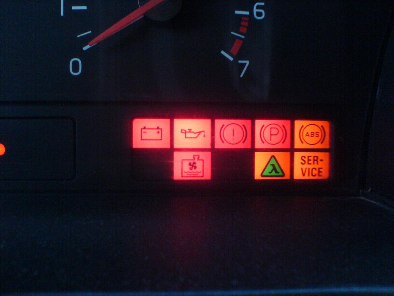

My 1999 V40 (turbo) overheated due to a busted radiator causing the car to come to a halt (dashboard engine lights all lit up)... engine fan came on at high speed during this time.
First thing i did was tow the car home and replaced the radiator, thermostat, spark plugs, engine oil, oil filter, coolant and followed by a burp/bleeding of cooling system. All cooling fuses look fine.
I took the car for a test drive around the block and so far so good... then car stalled mid turn and the "triangular" engine light came on.
Restart but the engine light stayed on. Drove around for approximately 10-15minutes and the temperature started rising! Switch engine off. Fan still not working!

anyone know what this green triangle light means ? OBD scanner shows P1542 which according to various google searches mean A/C System High Pressure High Temperature or emission controls (?) Anyway i'll continue with the elimination of issues and continue to post in case this information is useful for others.

Click the link below.
Its a forum thread which explains the warning light your getting.
http://www.volvoforums.org.uk/showthread.php?t=20505
