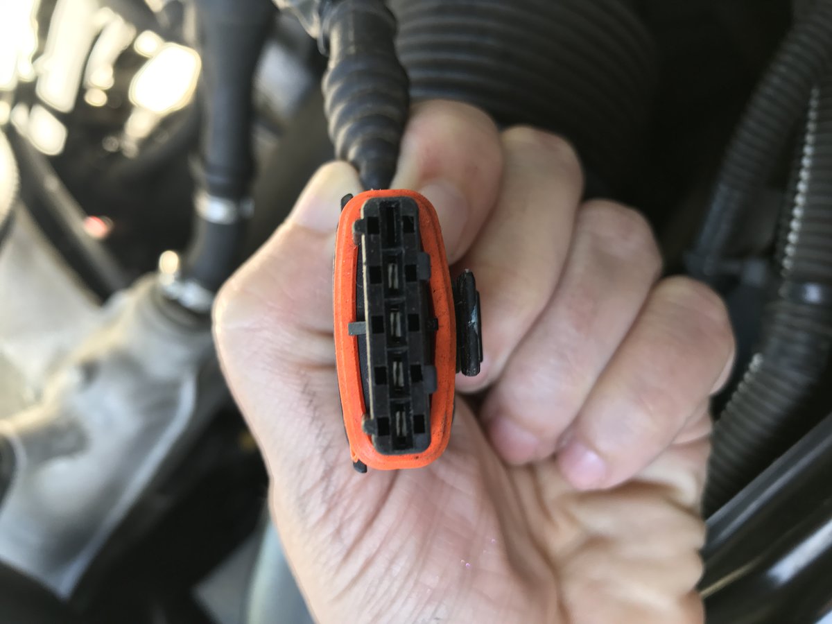

The auto part sites say there are no MAF sensor connectors that work with my car.
ETA: There are only supposed to be that many prongs. Now I know that!
