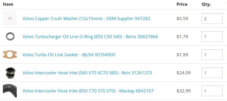

Lastly, I removed the turbo with the exhaust manifold attachment connected, but am having trouble determining which parts I should order from FCPEuro for when I reinstall it. Both turbo water cooling hoses are new, but I'm not clear on gaskets, o-rings, and intercooler hoses. I've attached a jpg of my current cart and would appreciate if anyone could tell me if I am missing or overdoing anything.

The 13T will not fit back on in place of the 15G since the exhaust outlet nozzle is at a different angle. On your parts order you will need six of the copper crush washers and I would replace the coolant hoses while you have it out, it is much easier and they all eventually fail.
You will need a 15G to make this all work so you will likely need to scout the pick n pull lots to find one.

Even if you can get it to fit by changing exhaust flanges, the 13T will not produce as much boost as the 15G and the car's performance will be altered. The only intercooler hose near the turbo is 3126730. If you need intercooler hoses I would buy silicone (Eeuroparts usually has a good supply) or Volvo branded, the cheap MacKay hoses will get oil soaked and fail relatively quickly.
