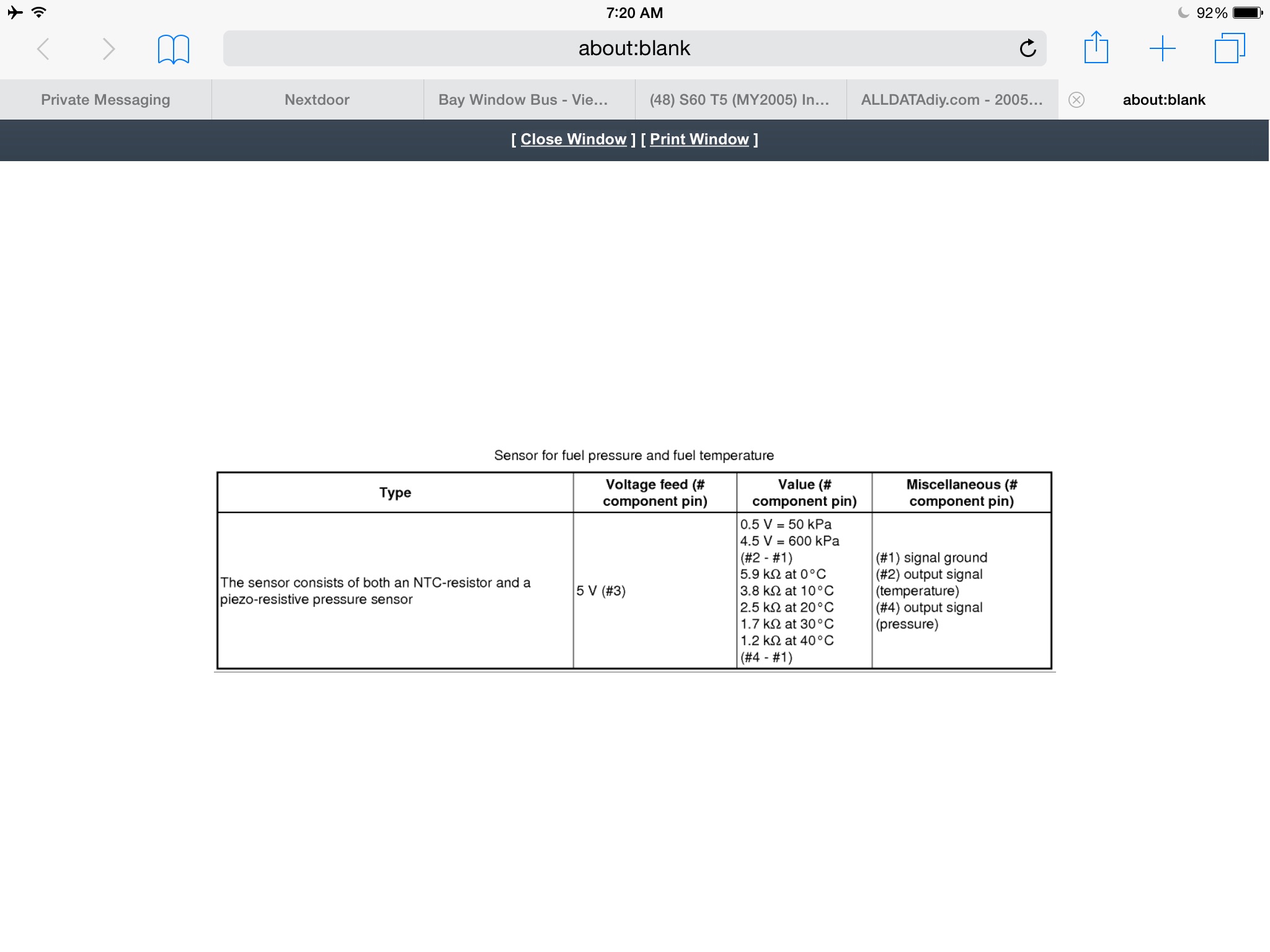

Confirm by measuring the fuel pressure at the rail.
There is a fuel pressure sensor on the rail which you can monitor the voltage to see if it's reporting correctly.
I'll try to find data on this
- Posts: 36147
This is for my 2005 V70 but I guess they are the same
