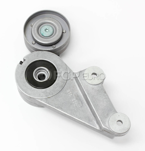

This piece is all you need to correctly set the tension on the serpentine belt. Replacing the pulley is only when the pulley stops spinning. The pulley doesn't set tension. The spring mechanism inside this thing does.
https://www.fcpeuro.com/products/volvo- ... m-1275380s
This is a pretty simple job, you should give it a try!
It's 15 mins.
The only other tensioners and idlers are for the timing belt. Those are separate from this. So all you'd need is this and the belt.
