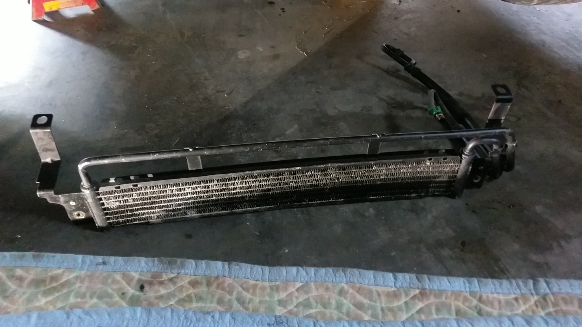

2002 S60 Trans Cooler

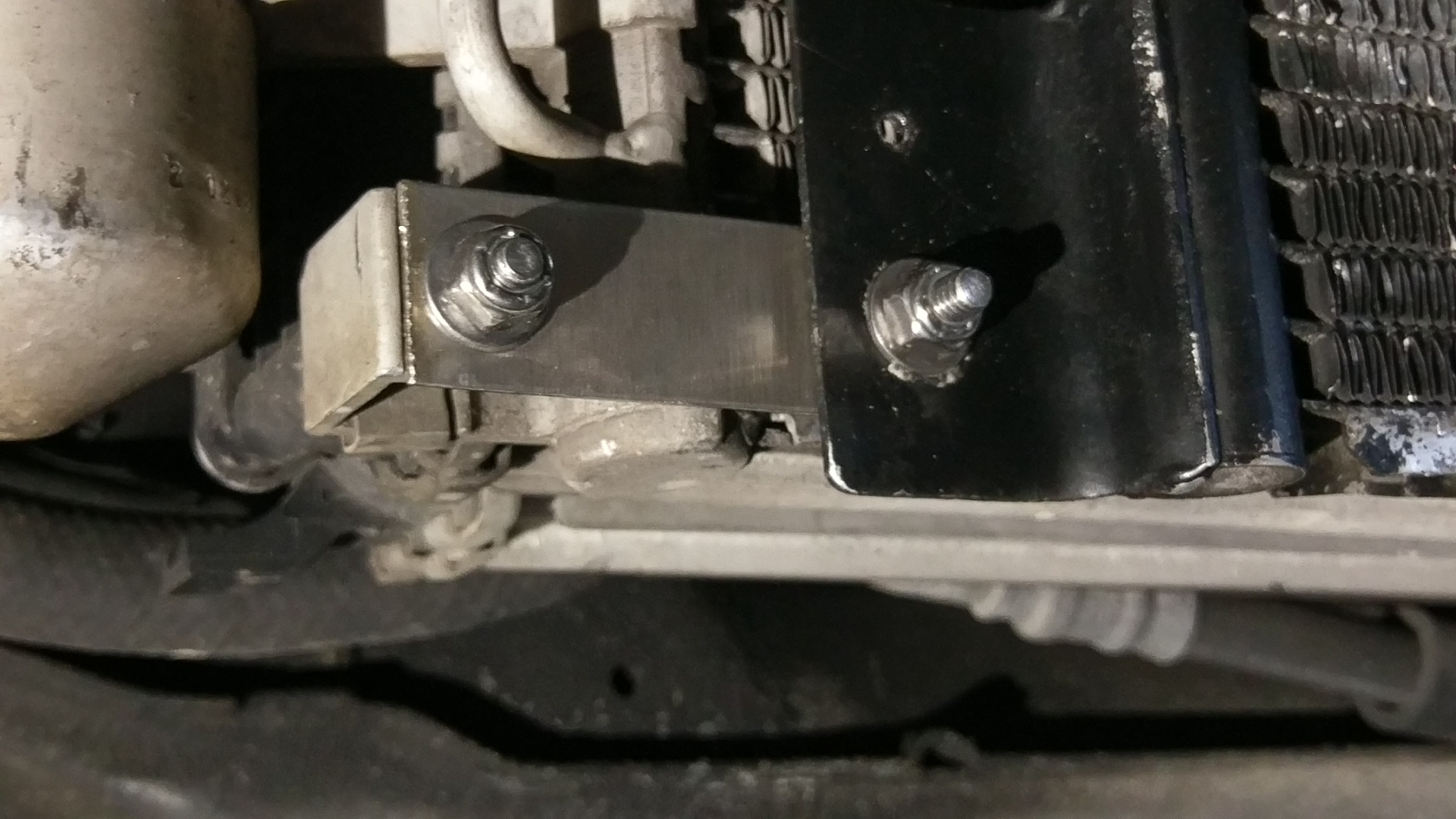

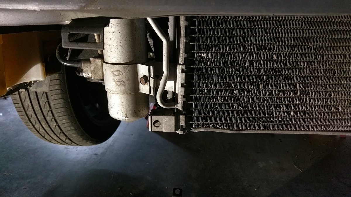

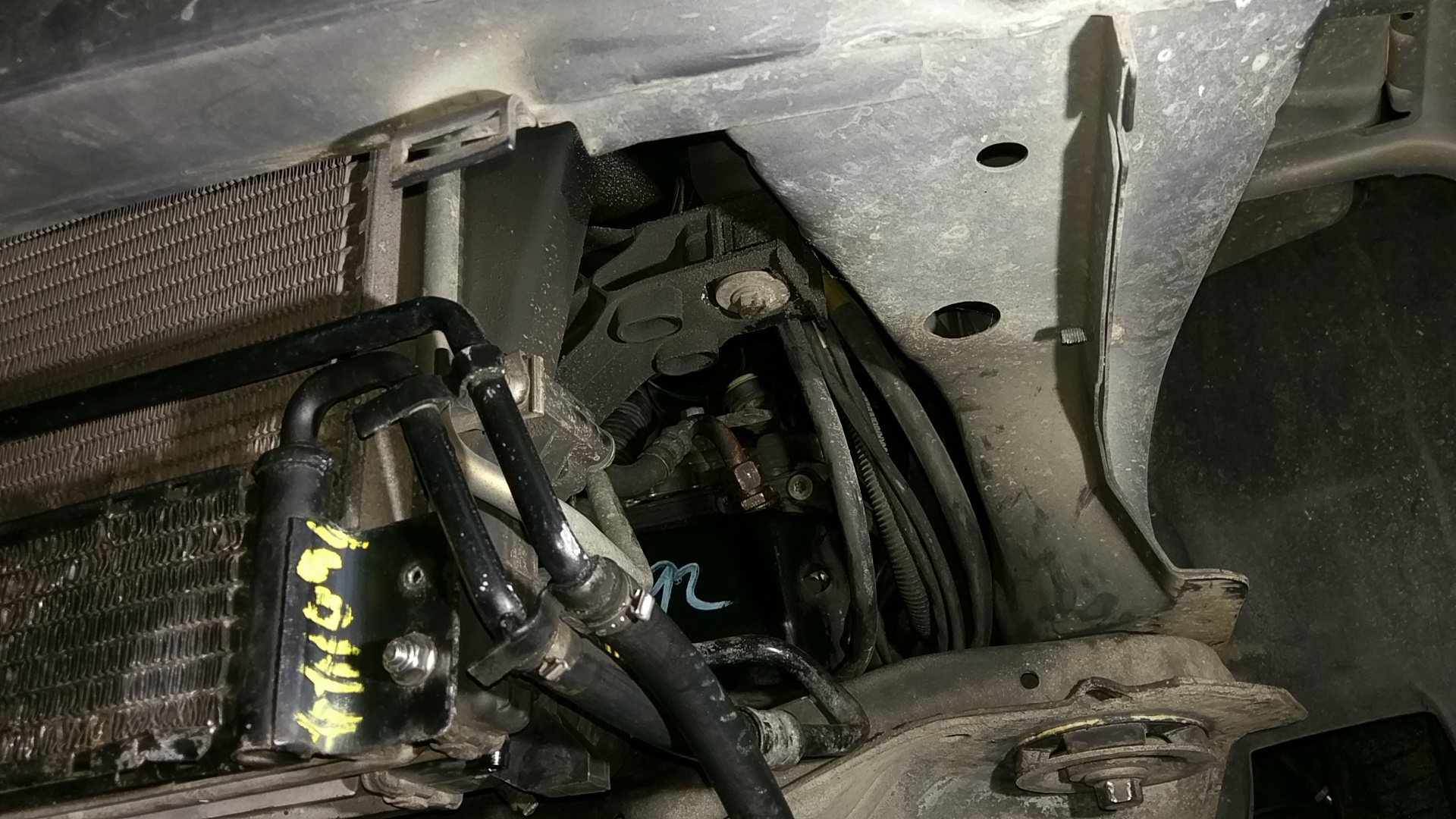

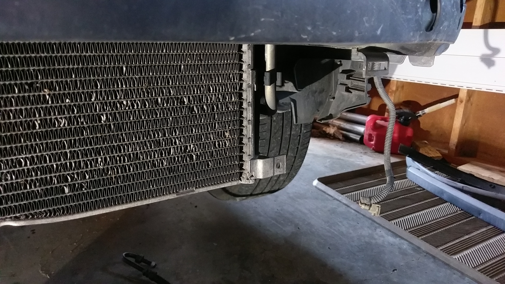

Now I am not sure about all, but mine and my buddies 06 V70R both have what appear to be mounts for a similar set-up which is where I got the idea from. The V70 is a bit wider than the S60, so a bit of adaptation will be required, but I'll show you what I did and in less than an hour I had it ready to roll again!

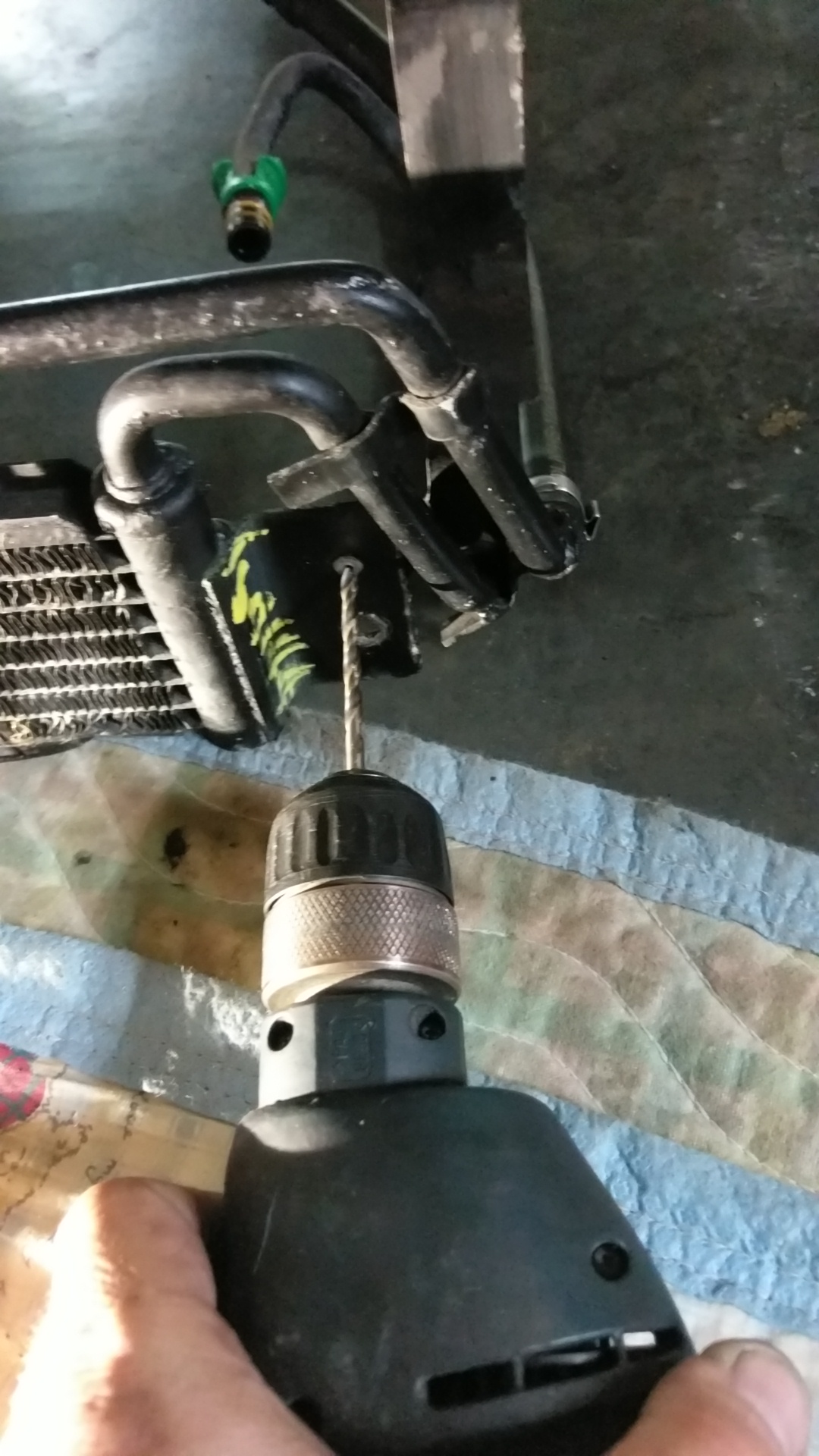

I took the portion of the mounts that would, in a non-turbo car, attach to the radiator mounts and removed them. They are not deep enough and simply won't fit in this application. We're not talking a ton of weight and it's on some serious mounts, so I have no issues with it. You make that call for yourself. Drill out the rivets for the unneeded mounting points. Don't toss them too far yet as they come in handy in a few minutes!!
Drill out the existing rivets and discard the mount.
Take the Drivers Side tab on the cooler and on the radiator and loosely thread the bolt through it. I put the bolt into the Radiator side, so it was much easier to thread and tighten. There is not much room to swing in there! Do not tighten all the way down as you have a lot of manipulation yet to cover. If your car is REALLY high off the ground, a zip tie between the other mounting hose will keep it safe from twisting and damaging the fins.
Drivers side mounting tab
Passenger side mounting tab
Once you have it loosely in place, line up the passenger side with your 1" strip and mark where you will need to drill your holes to make an adapter to stretch between the Rad Mount and the Cooler Mount. You might need an additional set of hands, or amazingly enough, take the old riveted mounts, hold the rivets together and mark the distance between those holes on your strip. They make it exactly the correct length! Volvo... gotta love em!! If you mark it correctly, the edge of your strip fits nicely into a lip on the rad support. This will keep the bracket from drooping. If you want to double down on support, put a second strip on top on that butts up to the cooler the same way, but on the other end will keep it level. Jury is still out on this, but I may weld a little tab on there if I see it sinking! There is plenty of room between the bolt head and the Condenser, so just put the bolt in that way and you are fine!
The mount for the pass side

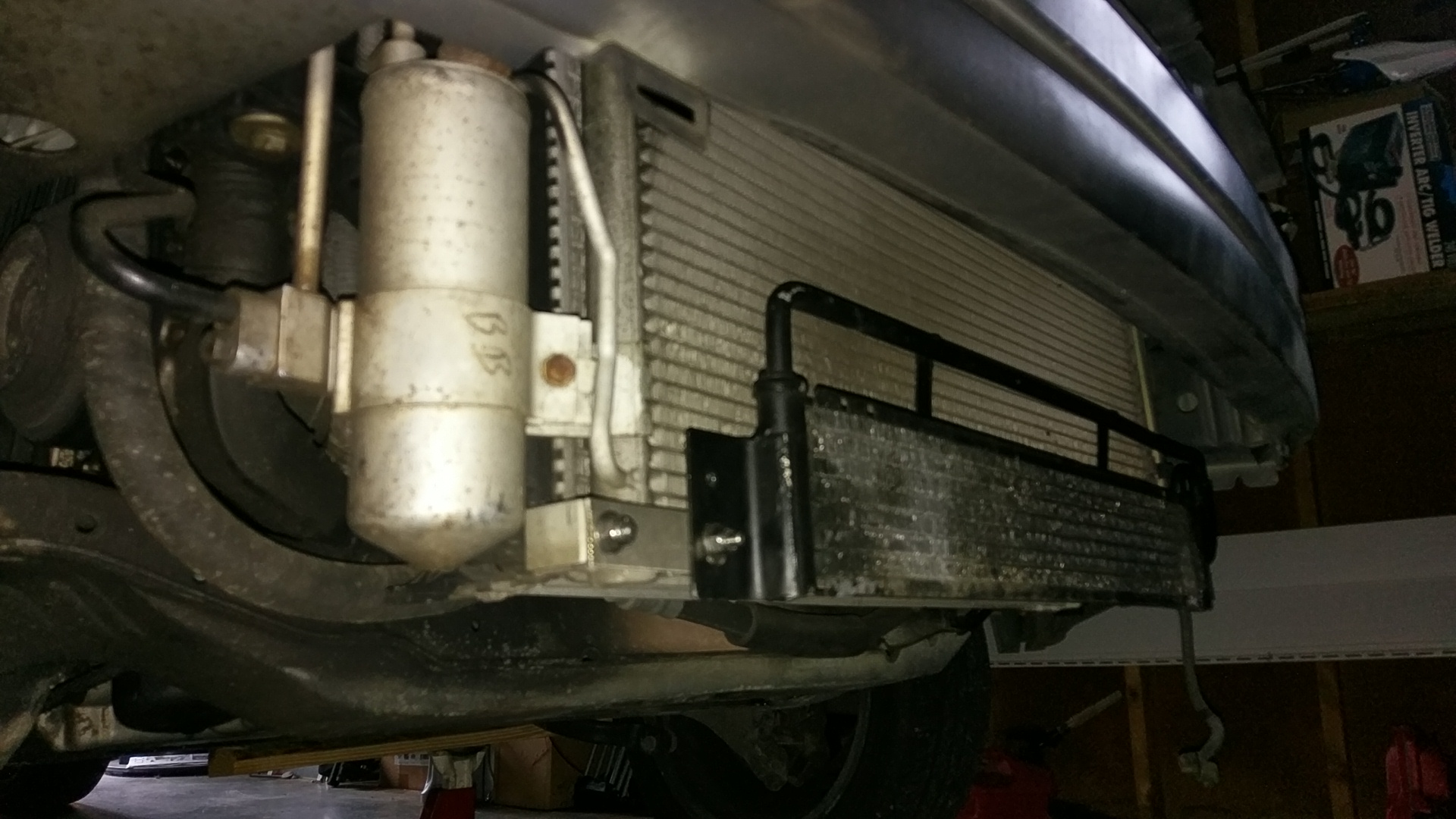

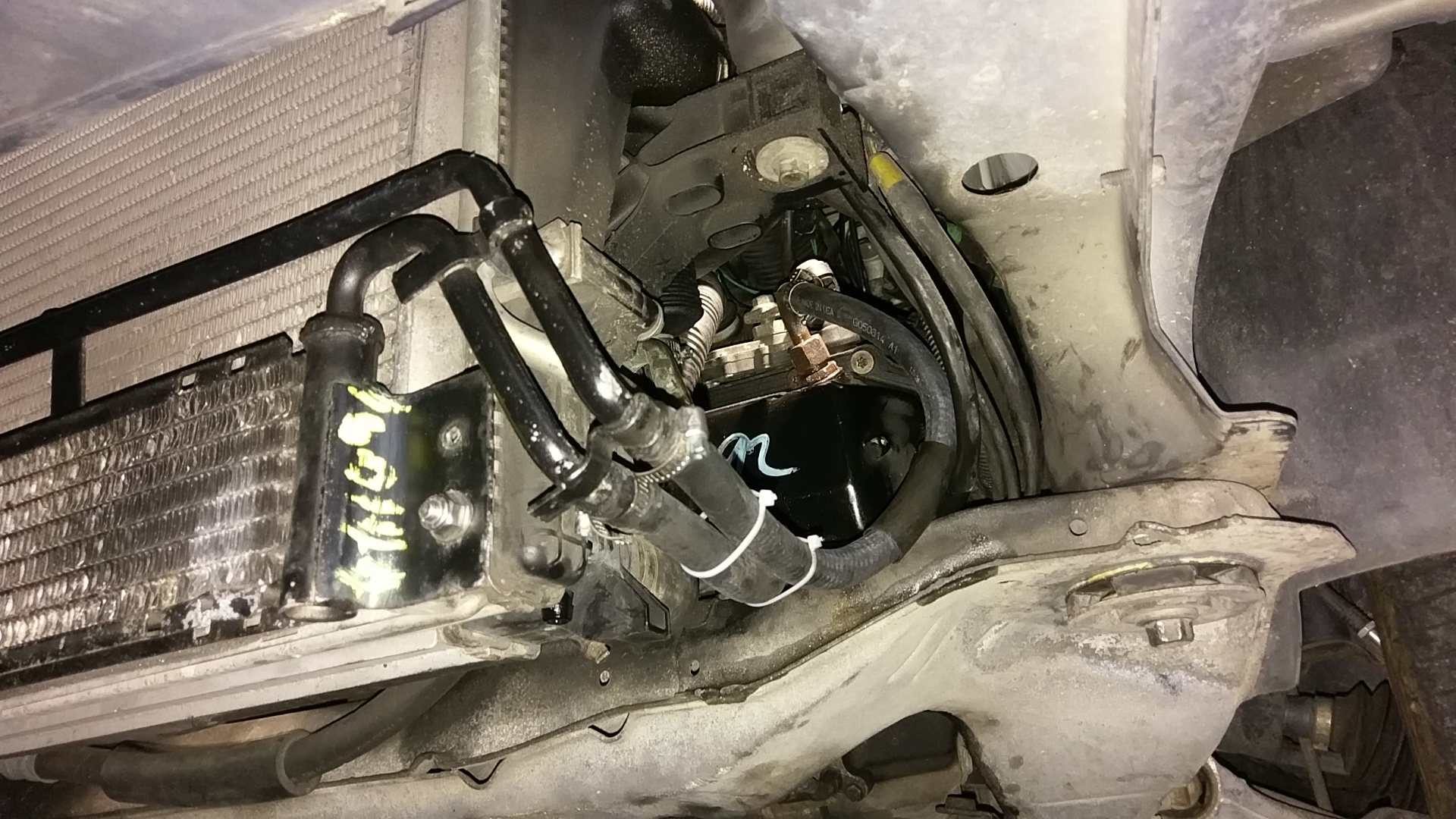

The mounted cooler
The mounted cooler
Drivers side with hoses pointed right at the trans!
Now that you have the cooler on the supports, tighten down lightly until you are sure it's all aligned properly and then cinch it down. Because Volvo intended it to be used like this, the hoses are now positioned for easy manipulation on the drivers side, right in front of the trans and right below the existing cooler!! Too easy, huh?

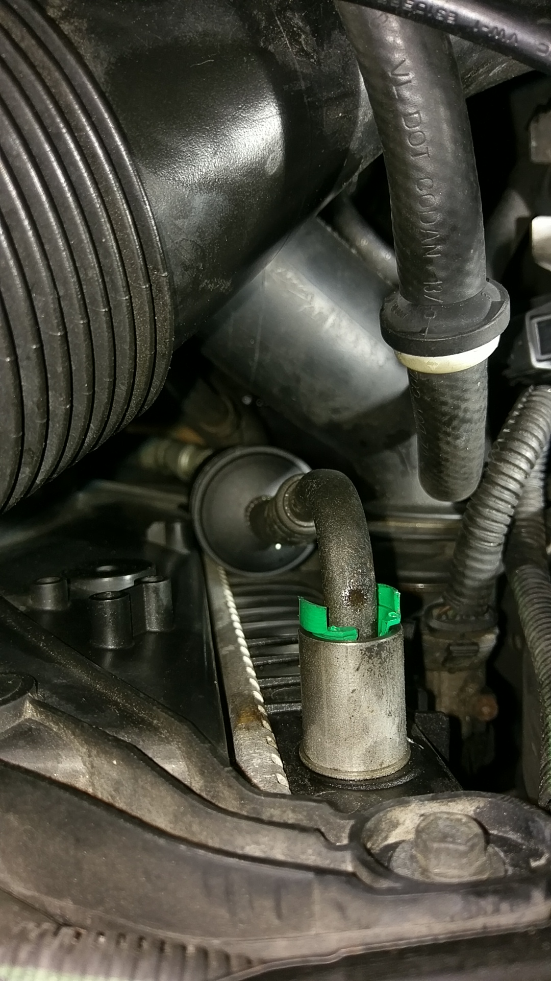

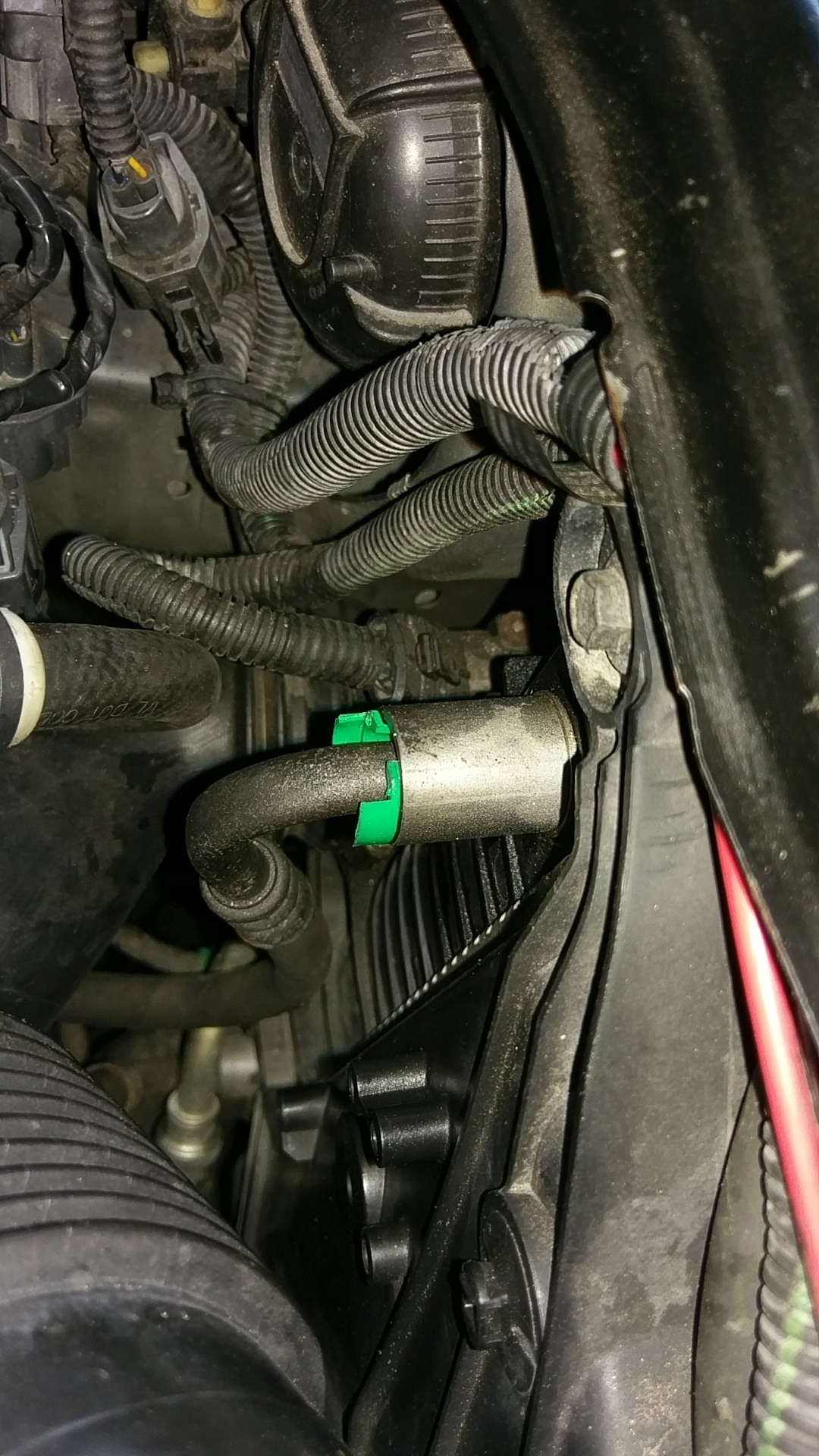

Now you have a couple of choices to make. I decided to simply augment the existing cooler in the car. It's easier and if I really want to I can rework the hoses in the future. For the moment, we are going to just add this cooler to the car. So start by removing the existing return line from the trans side of the system. Undo the upper side of the return first and blow into it to empty the line. If you don't, there is always a little ATF sitting in the loop and it gets everywhere... ask me how I know!!
Looking at the trans return line on the driver side of the car.

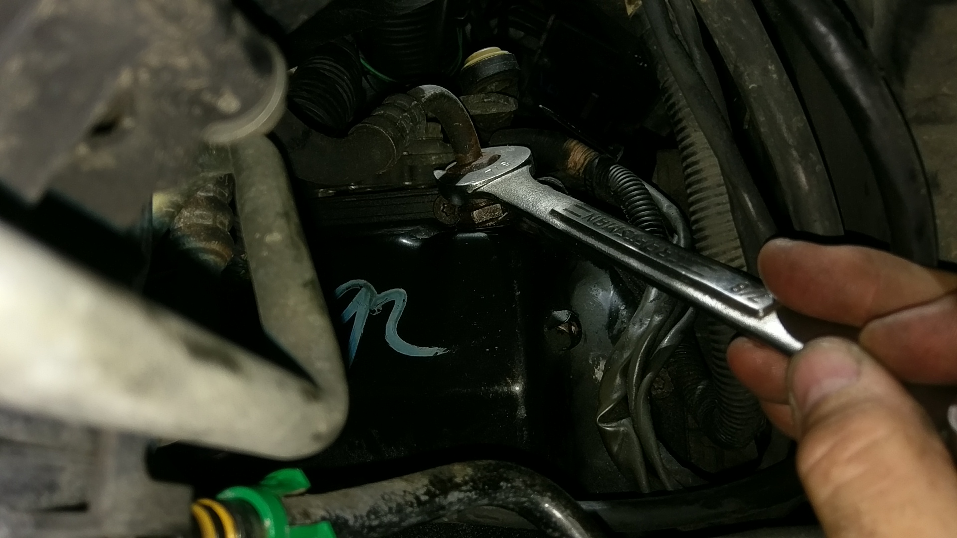

Now grab a pair of 7/8th wrenches. A thin one is required!! Remove the existing return from the car watching for spillage as you rotate the hose to extract it.
Use a back-up wrench or you risk stripping out the hole!!

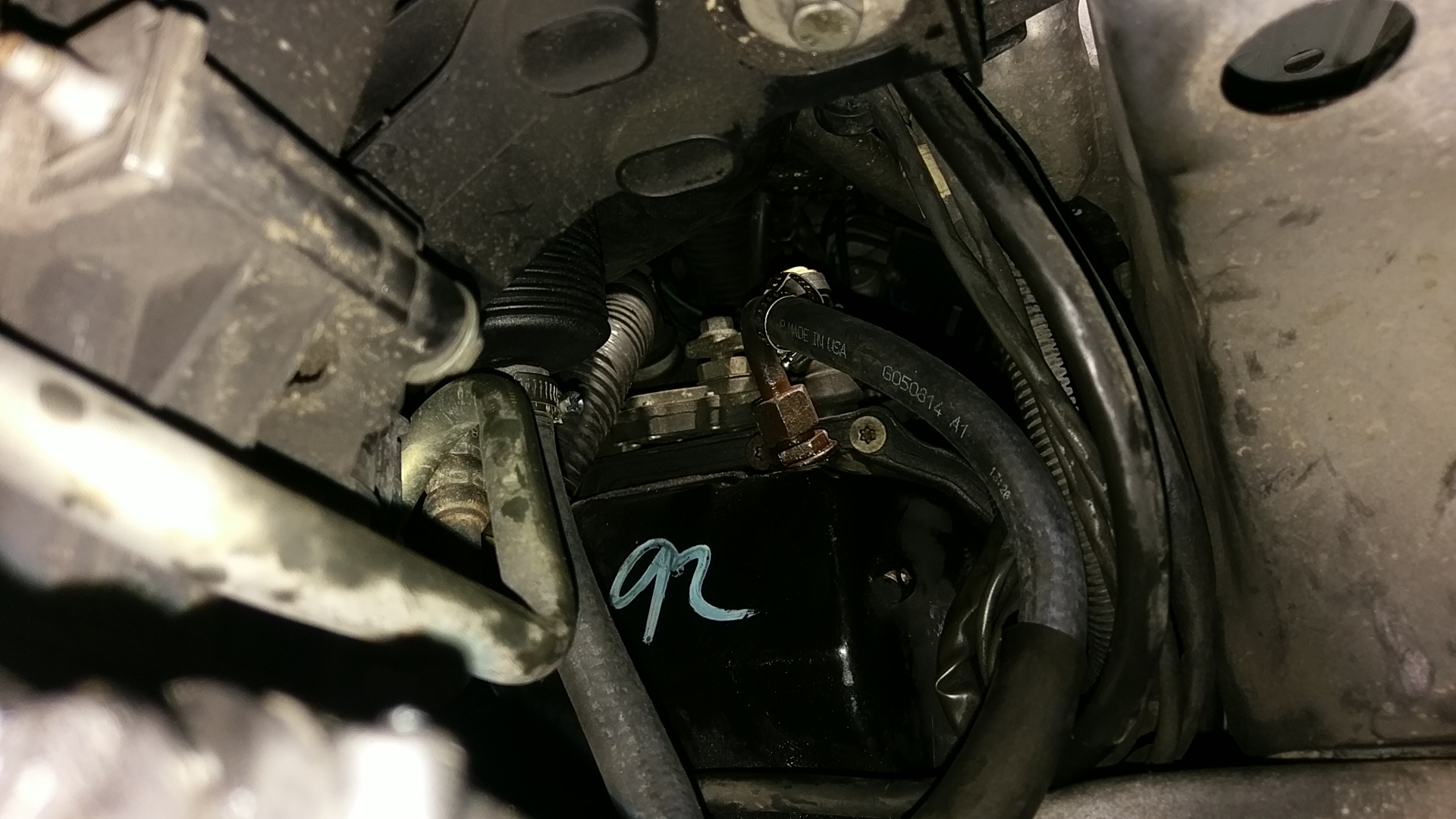

So here is where some decisions for different directions can be made depending on car and DIYers situation. I was going to use the S60 return hose as-is... and it actually fits, but it was a bit tight for my liking on factory mounts. Maybe if I had polly mounts or no intercooler or evaporator, but it vibrates and I don't feel like pouring out my ATF on the street when I snap the hose! It interfered with the intake just a little bit. So I decided to repurpose the existing return line after a little modification.
Look at the existing hoses and accessories in the intake area and determine the best location to place the Magnefine Filter is you decided to put one in. Cut the upper end of the return line and install a clamp and the filter. Make sure there is nothing in the way that moves (like the gear selector!!). Check twice, cut once!!! Feed the hose down through the opening and reinstall the return line with new o-rings and clip if needed.
About 4-5" down the line seems like a nice out of the way place!!
Make sure it won't catch anything!
Once you have it reinstalled on top, come down below and install the hose on to the lower fitting. I put a little ATF on the barb and slipped it right on. I used GATES hoses which can be super stiff and hard to manipulate. Just take your time and make sure that you have a good clamp and a half over the barb before you stop!

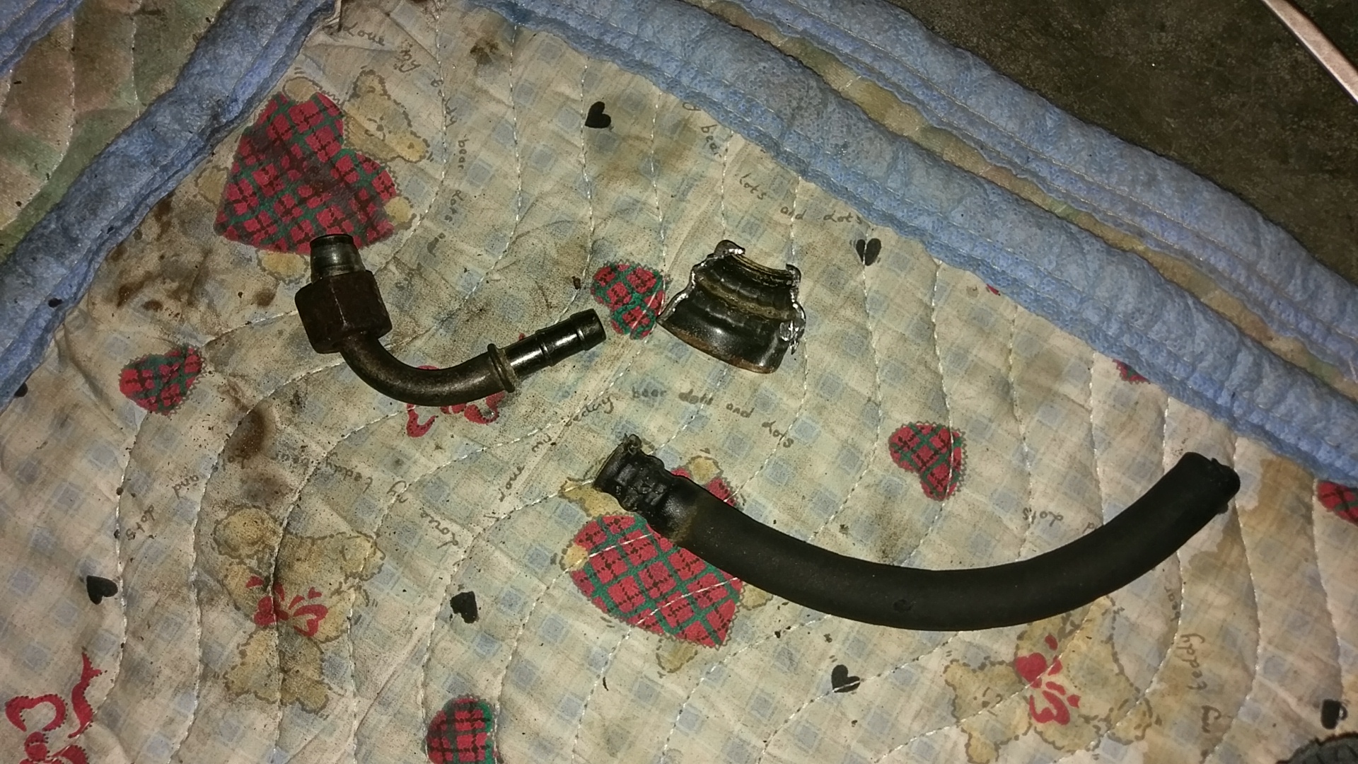

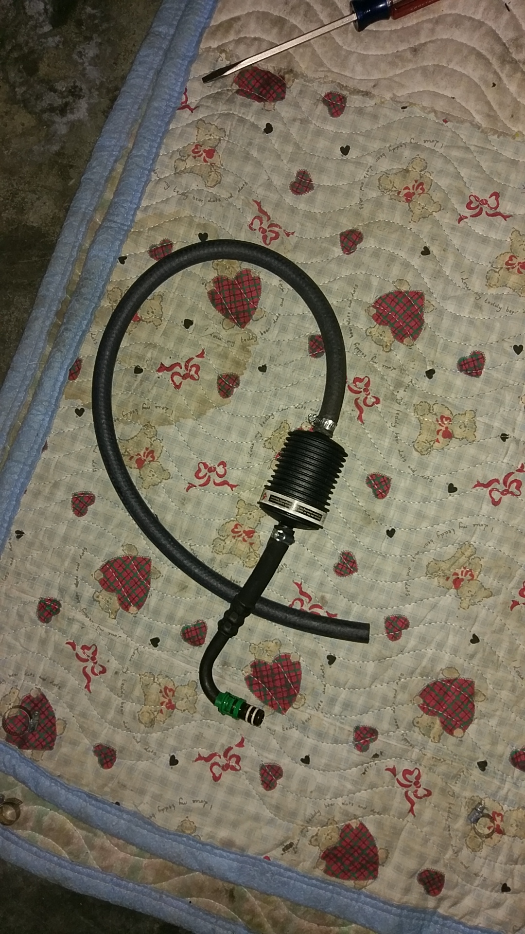

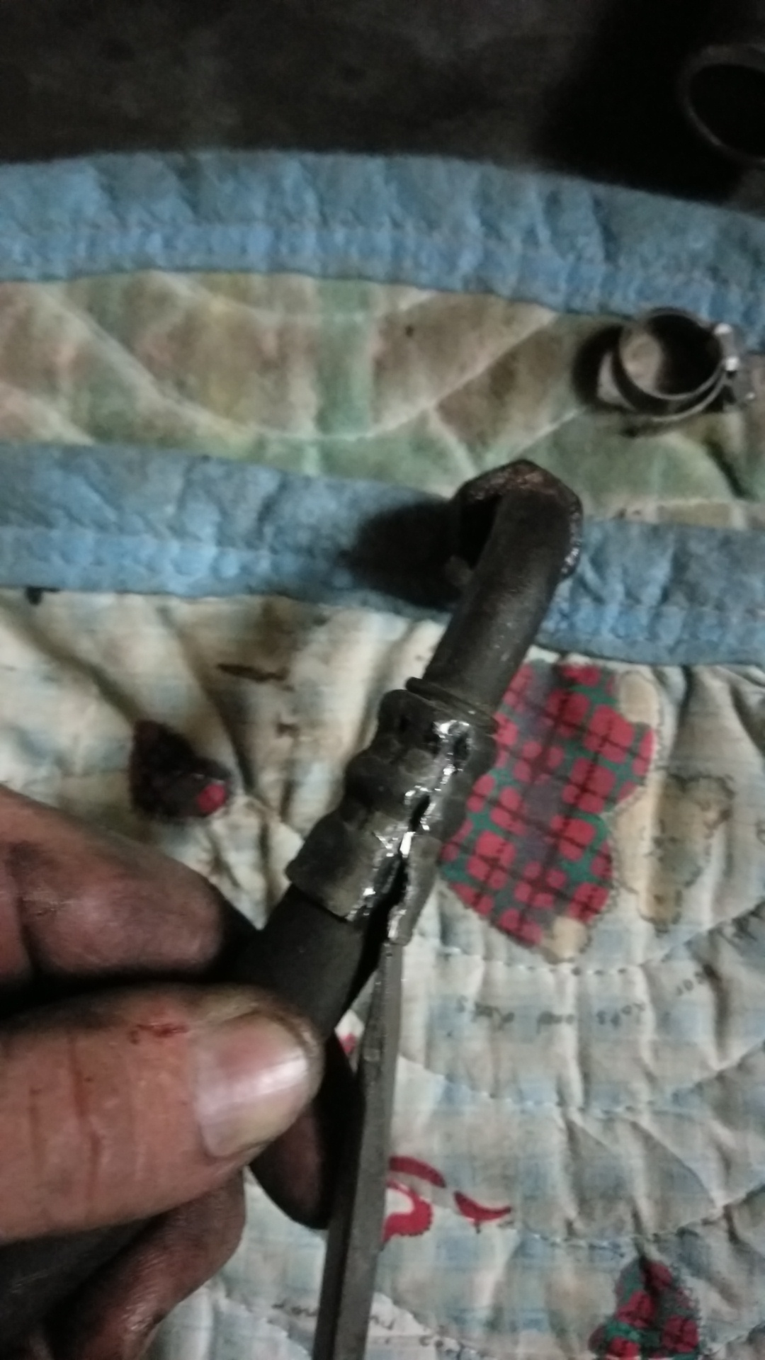

Now because I decided to reuse the existing V70 return line, I had to remove the old hose from the fitting. Take a Dremel or angle grinder and while wearing safety glasses and gloves (safety first, right!), carefully slice the swage off the hose. DO NOT COMPLETELY CUT IT OFF!!!! Only cut down deep enough to make it easy to tear apart. If you cut full depth, you will nick the pipe and damage the barbs! Use a strong screwdriver to wedge and pry. The connectors are easily snapped and it will part!
Don't cut all the way through!!
Done!
Done!
Once you have it off, attach the 3/8th hose and reinstall it on the trans pan. I reused the existing hose protector from the S60 hose as an added benefit!
Use two wrenches to reinstall it!!!!
