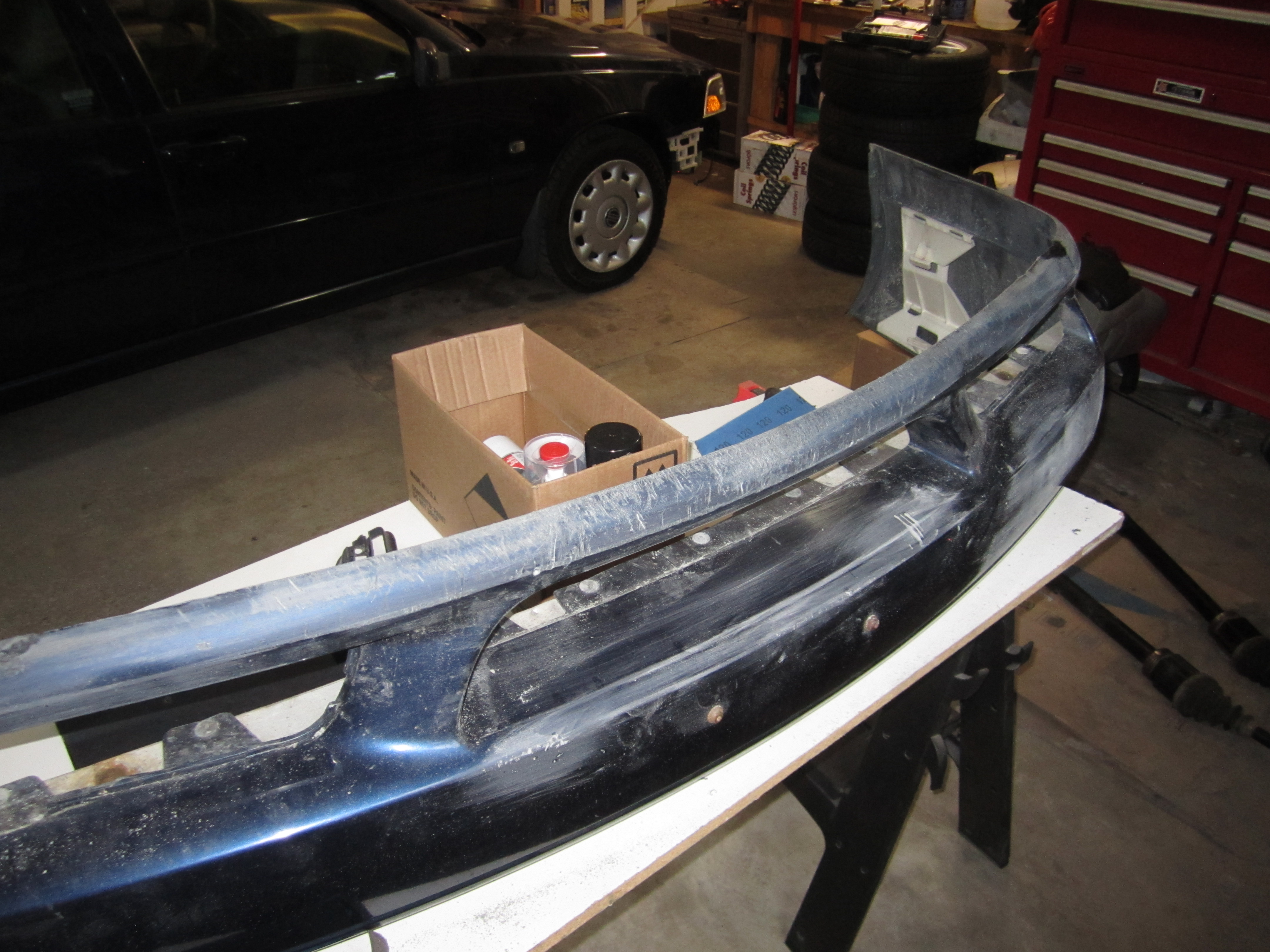

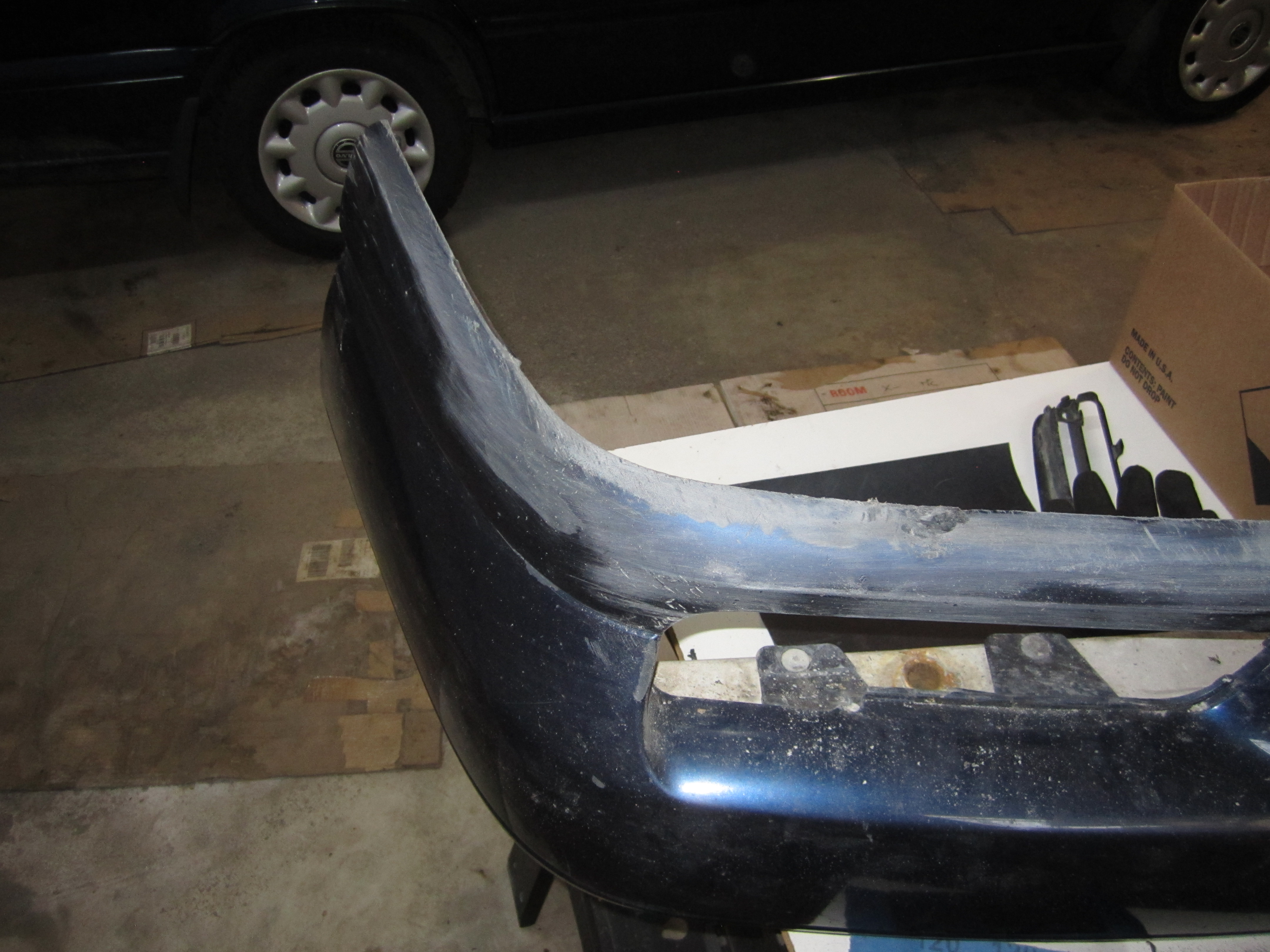

I prepped the cracks by drilling a hole at the end of the cracks to prevent crack propagation, then used a dremel with a small conical grinding stone to grind a 'V' notch on either side of the cracks in the bumper (i.e. front and back).
Then I picked the ABS plastic welding sticks and remove one for use. There is a hole through the welding tip that you pass the plastic welding rod through. It has the plastic rod coming though parallel wit the tip surface. With the tip up to temp., I practiced melting the bumps around the cracks to flatten them first, and then ran a bead of plastic weld down both sides of the crack. Is it pretty, no. Does it work, yes, and with a bit of practice it got easier. I have rubbed the front of the bumper repair down with sandpaper and they are now ready I reckon for filler to hide the front of the repairs.

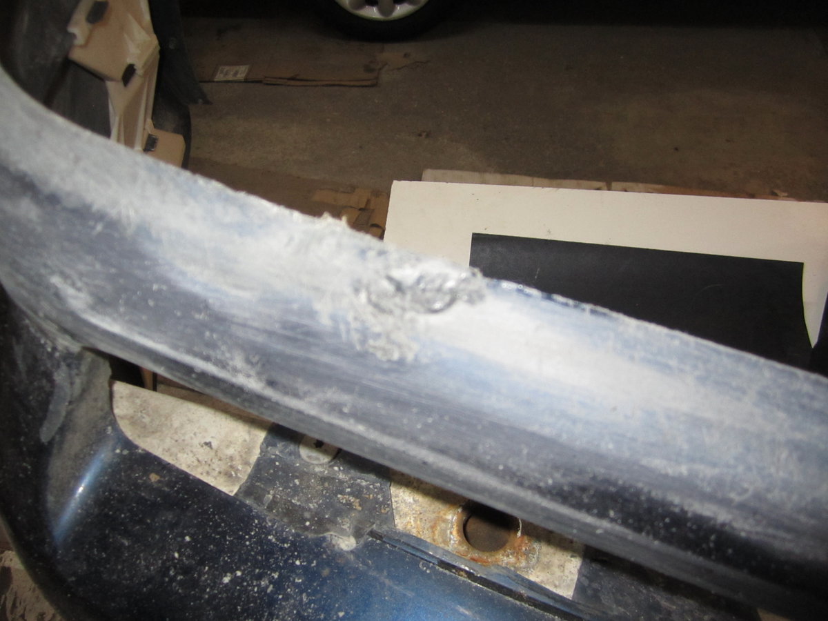

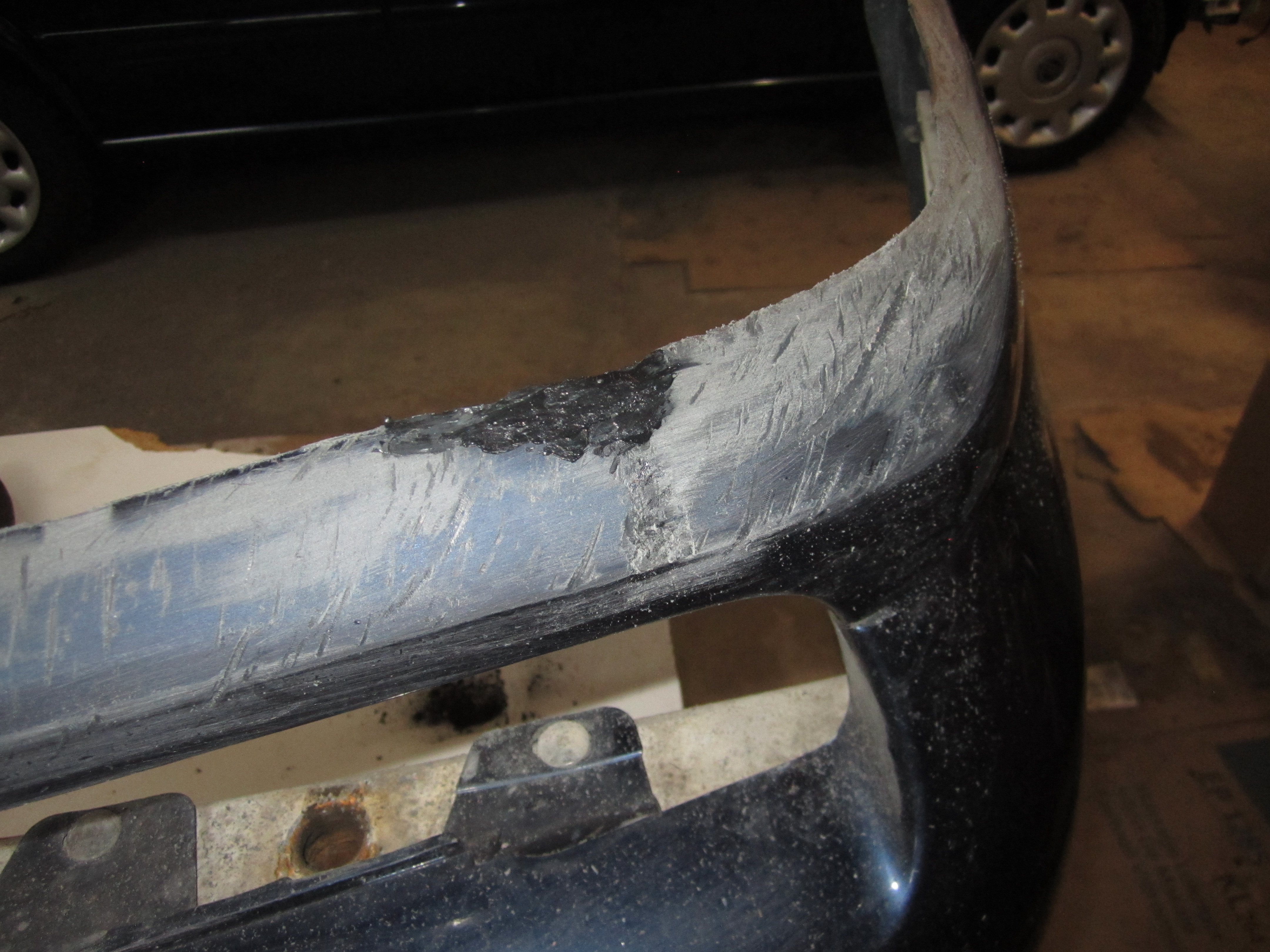

The crack runs vertically down from the top of the picture for about 2" in length. I also had to add more plastic (which has to be rubbed down) to replace plastic in a bad gouge nearer the bottom lip (top of picture) which was also sitting lower than the rest.

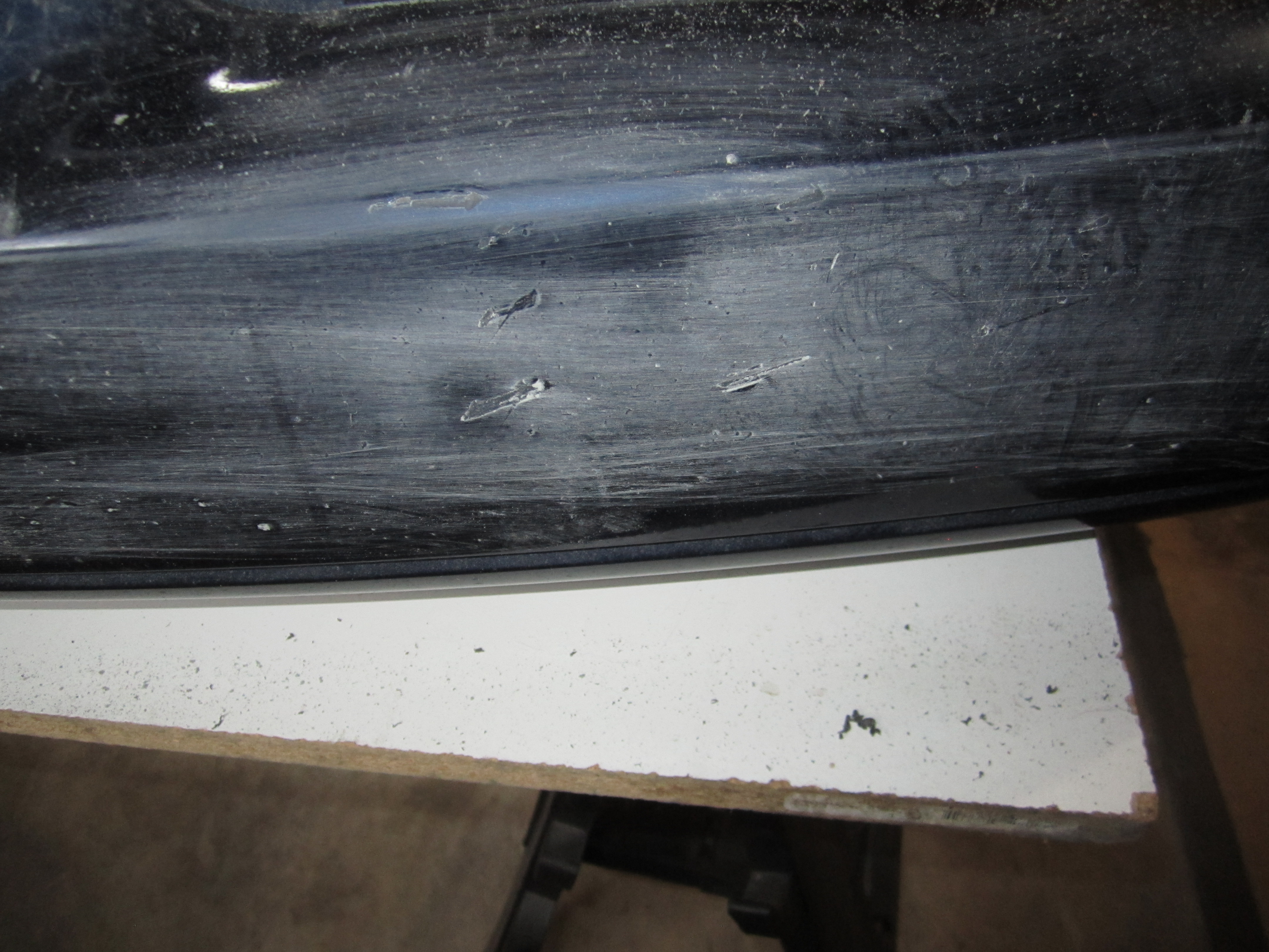

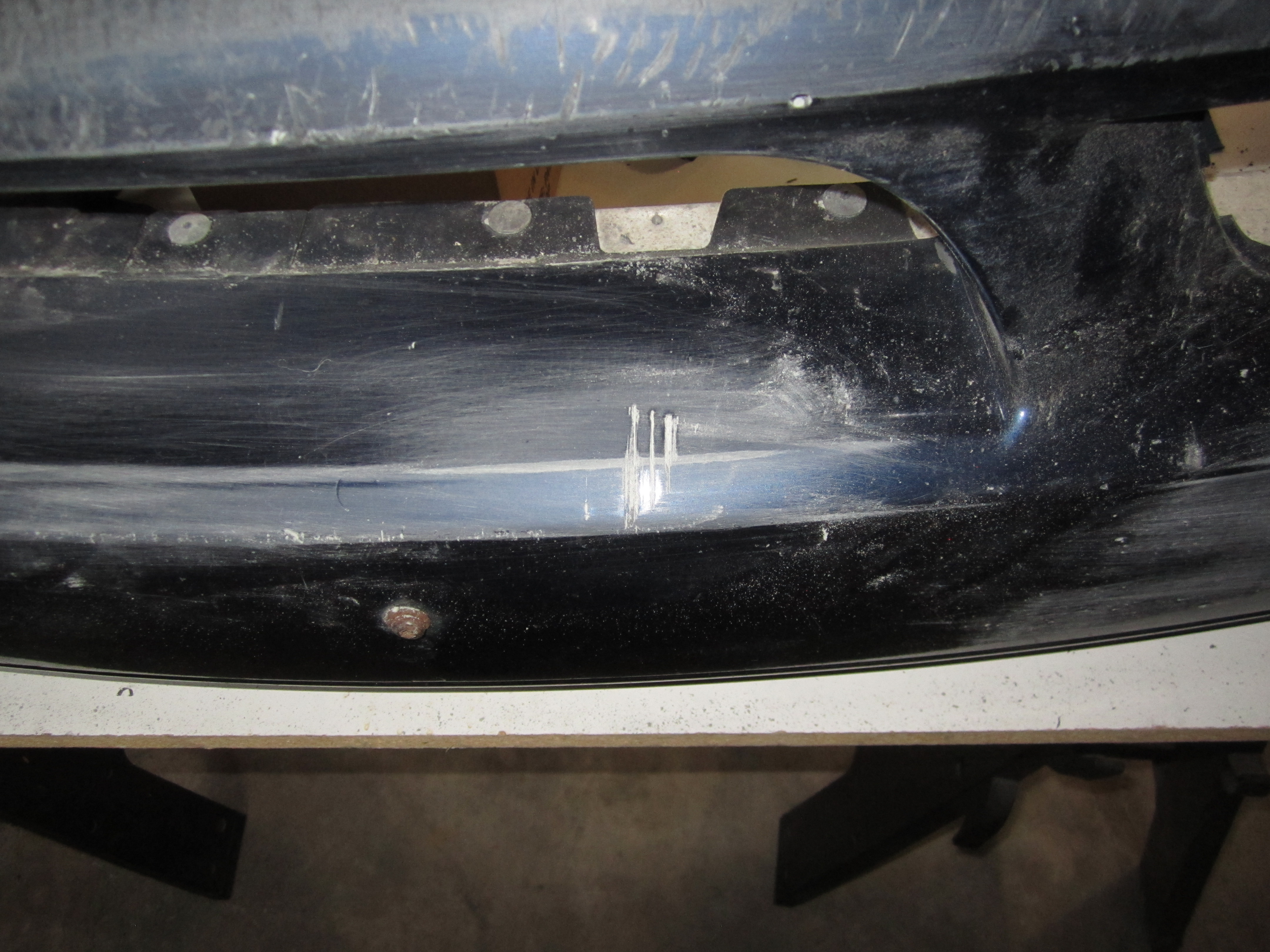

Tomorrow or when time next allows I will tackle the special plastic filler all along the bottom edge of the bumper as the gouges are too deep to repair by rubbing down alone.

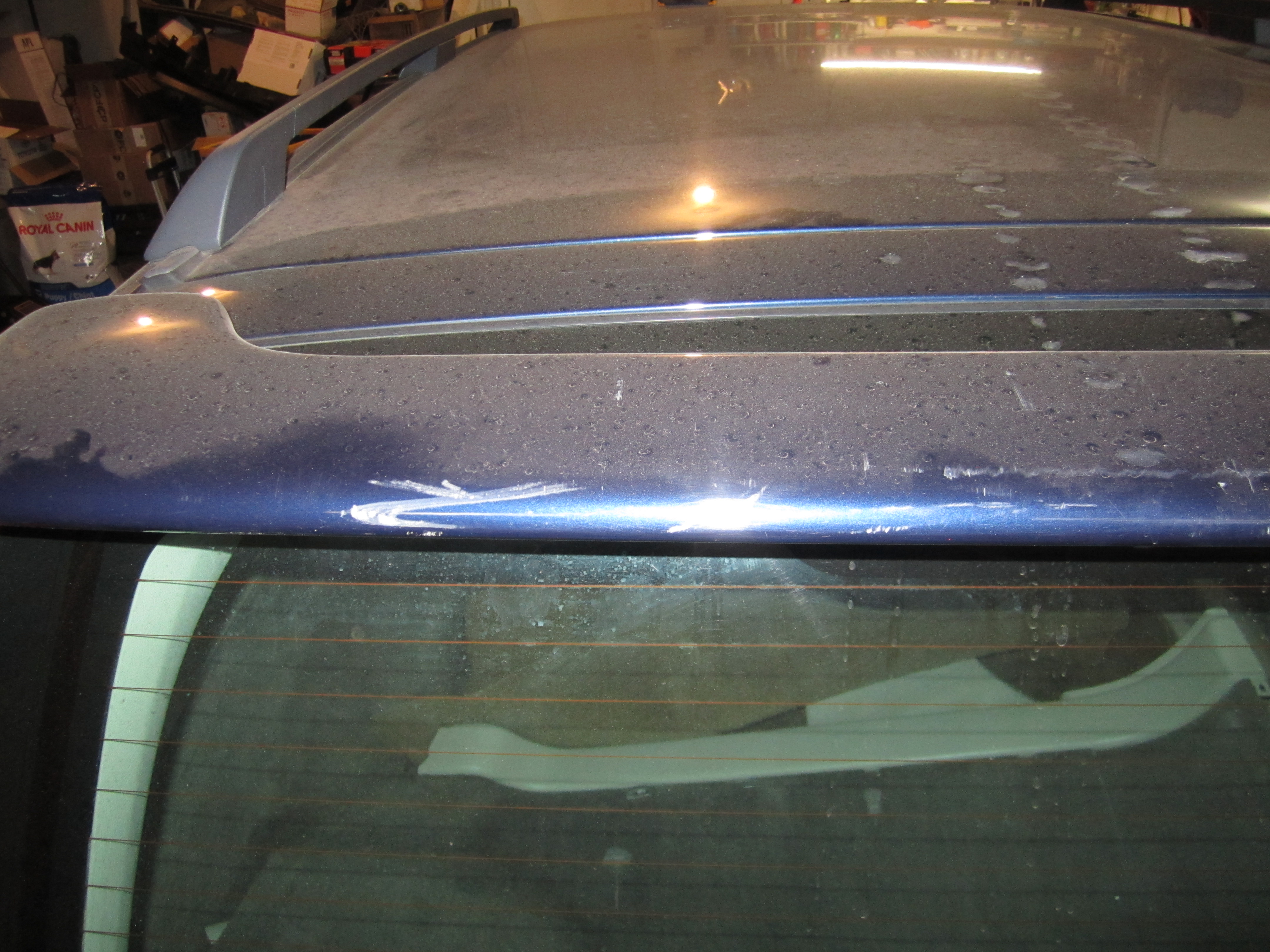

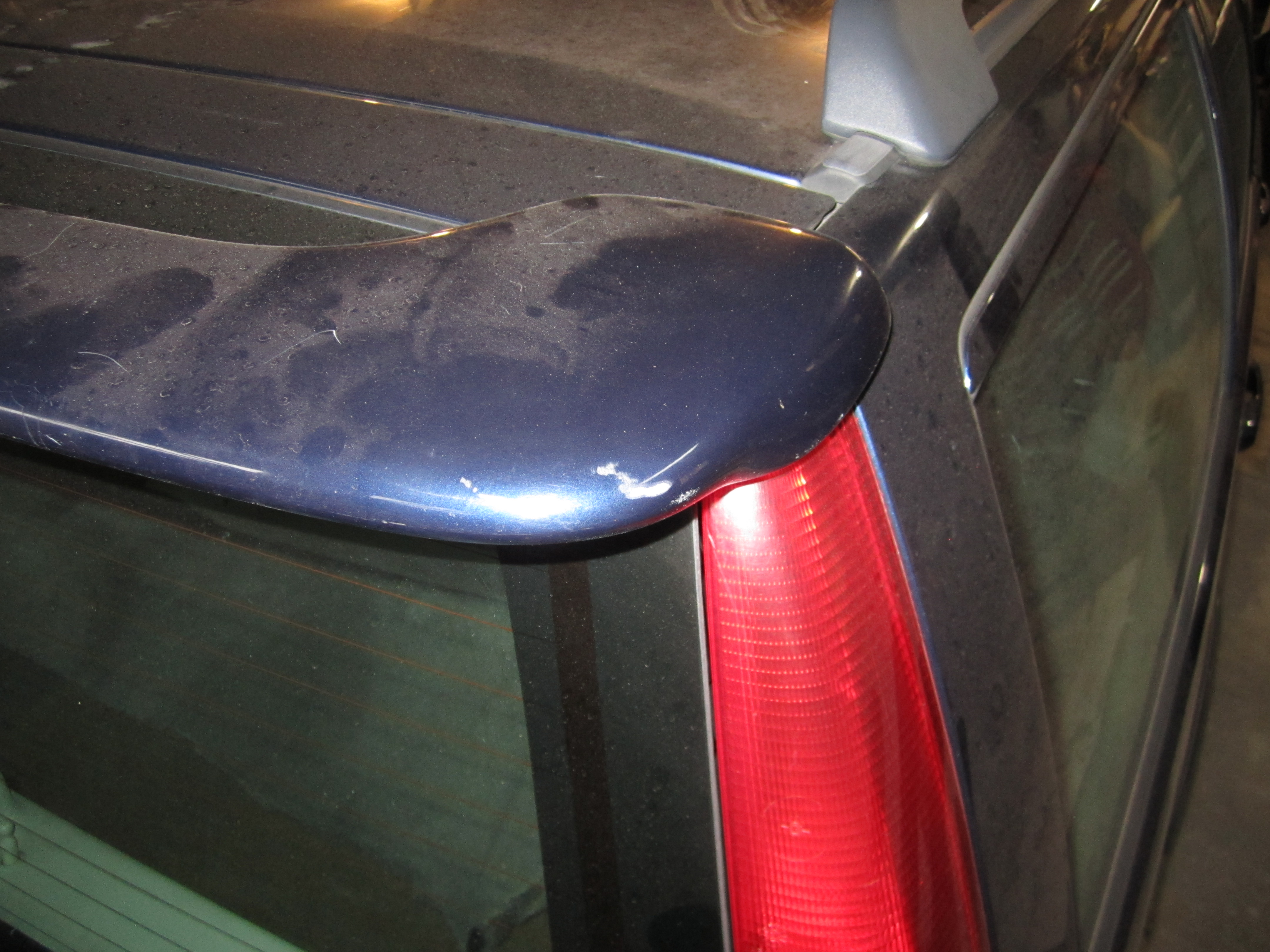

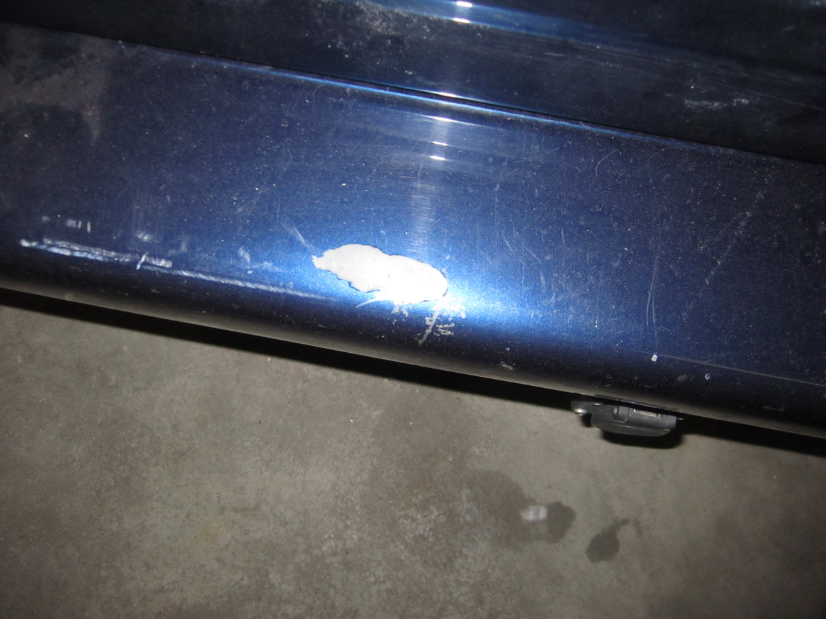

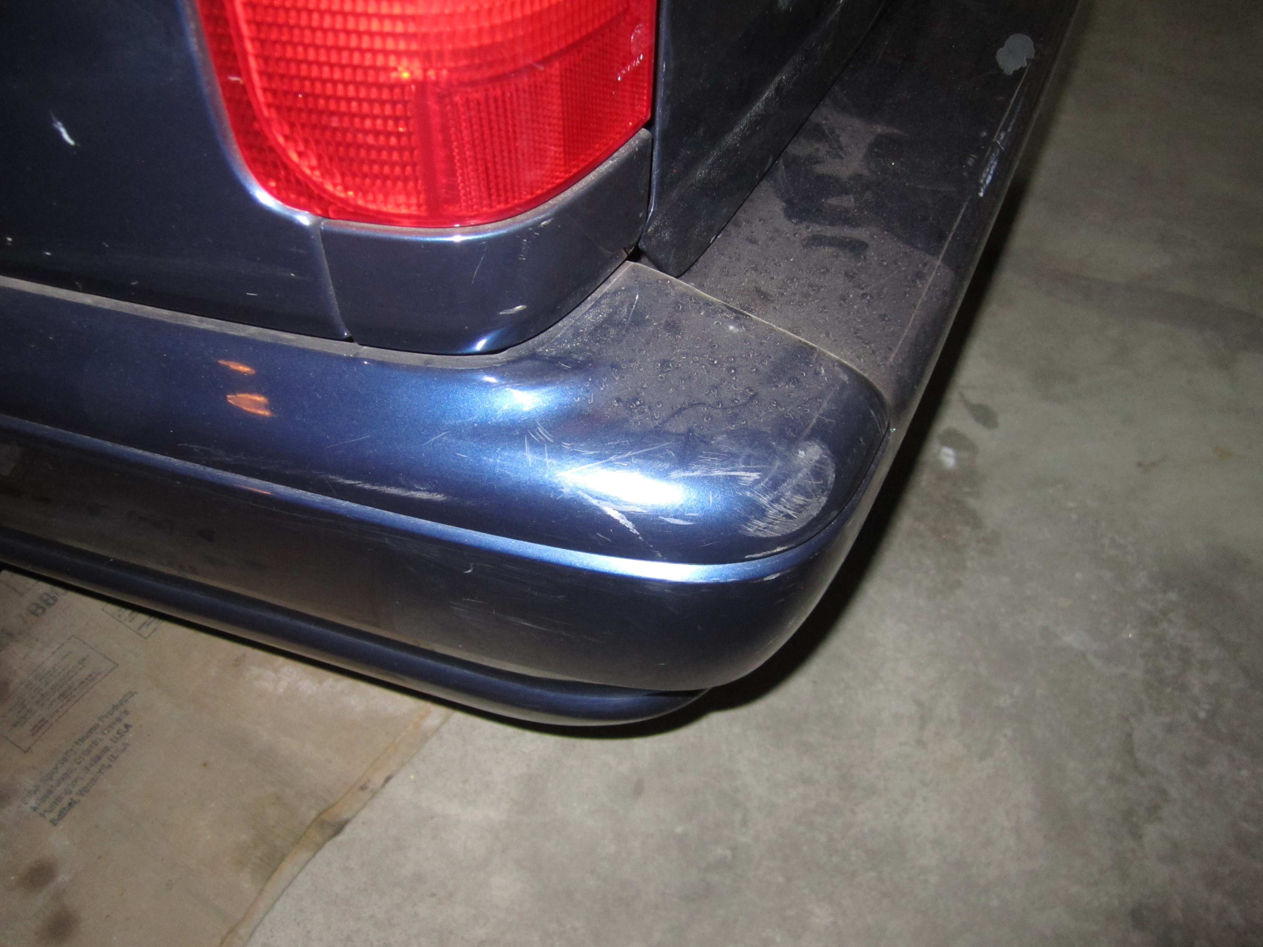

This poor bumper and other areas of the car ( rear tailgate spoiler and rear bumper) also took abuse.
I don't plan to repair the rear bumper and tailgate spoiler just yet, but they are on the plan once the car has been run for a while, along with a buff and polish. But that will be later.
