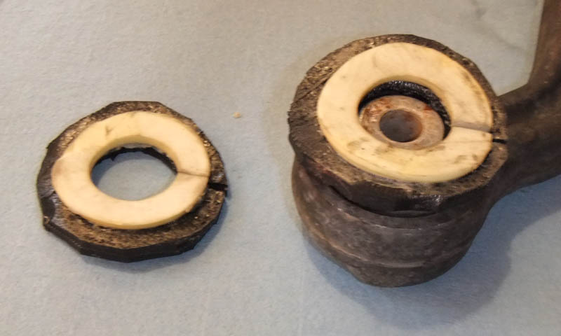

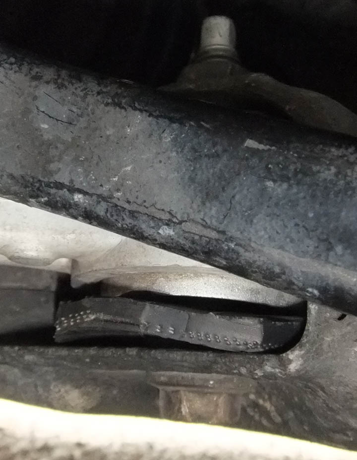

If you have or can get hold of a junk used tire (some tire shops will give tires that are too far gone to be resalable) cut this out from the sidewall and put it in the gap between the rear CA bush and the mount on the subframe as pictured. Note one side is open so you can stuff them in without taking the bolt out. Don't worry about the light peach colored material to test my theory you only need the tire rubber. If this is your problem the noise and wheel shake will become noticeably better (but not go completely away) as it's bouncing against medium hard rubber instead of metal to metal contact with the subframe. I chased around the whole front suspension and subframe bushes etc. pulling my hair out assuming because the LCA/bushes were brand new I was ruling them out as a potential problem. Nope. New LCA/bushes weren't suitable/bad even though they looked just fine. And they were a branded product from a long time Volvo OEM + aftermarket 'enthusiast' site your 30yr Volvo mechanic may well be ordering from. I have since come across a Volvo TSB regarding 'some aftermarket LCA bushes' though the TSB doesn't list specific brands.
30 yr experience on Volvos means he's been working on P80s and older models forever. The LCAs on these older cars are a different design. Virtually any LCA bushes you get your hands on will work fine on those older Volvos with differences merely being NVH and longevity.
With regard to P2 and newer LCA bushes,

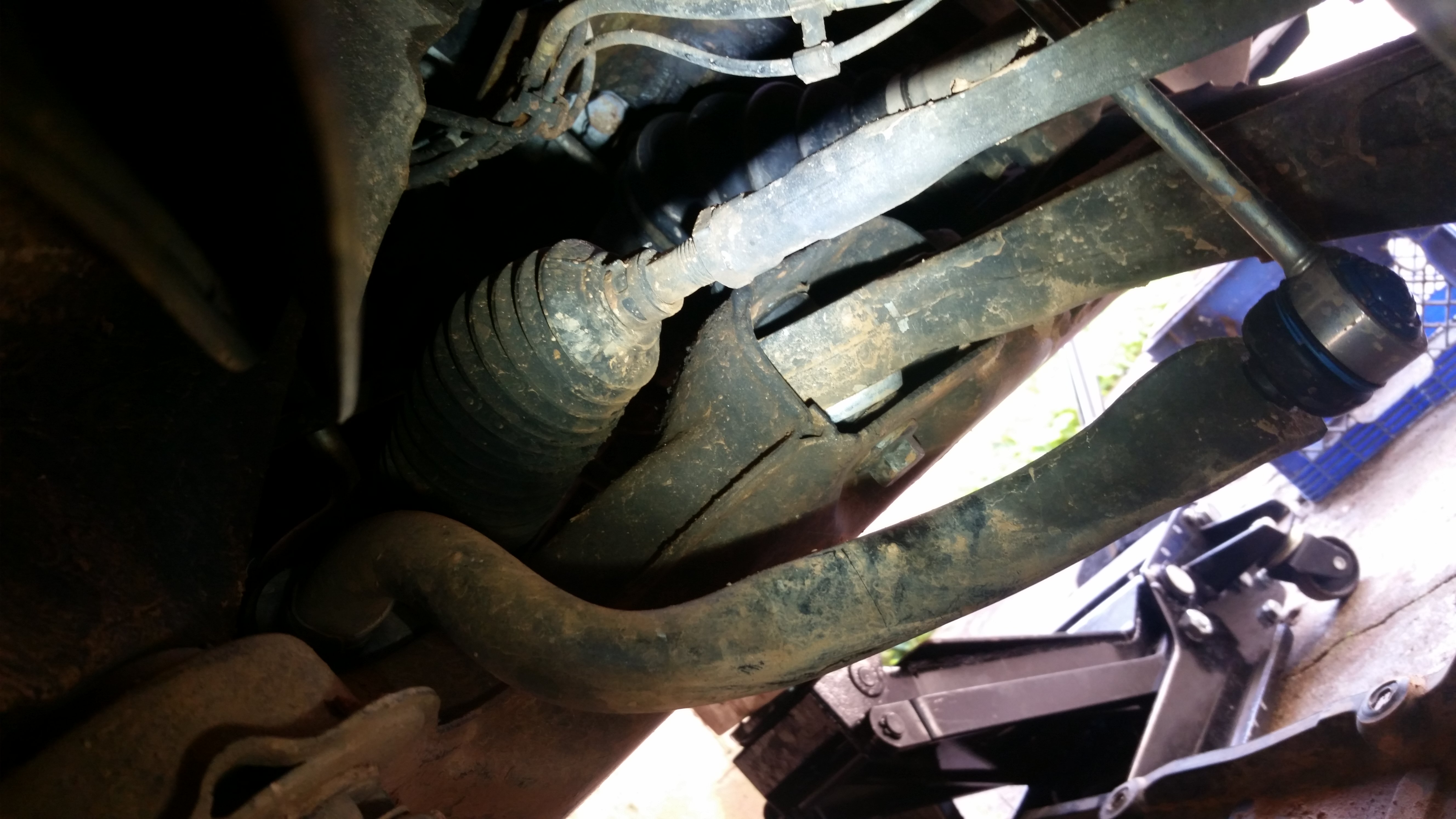

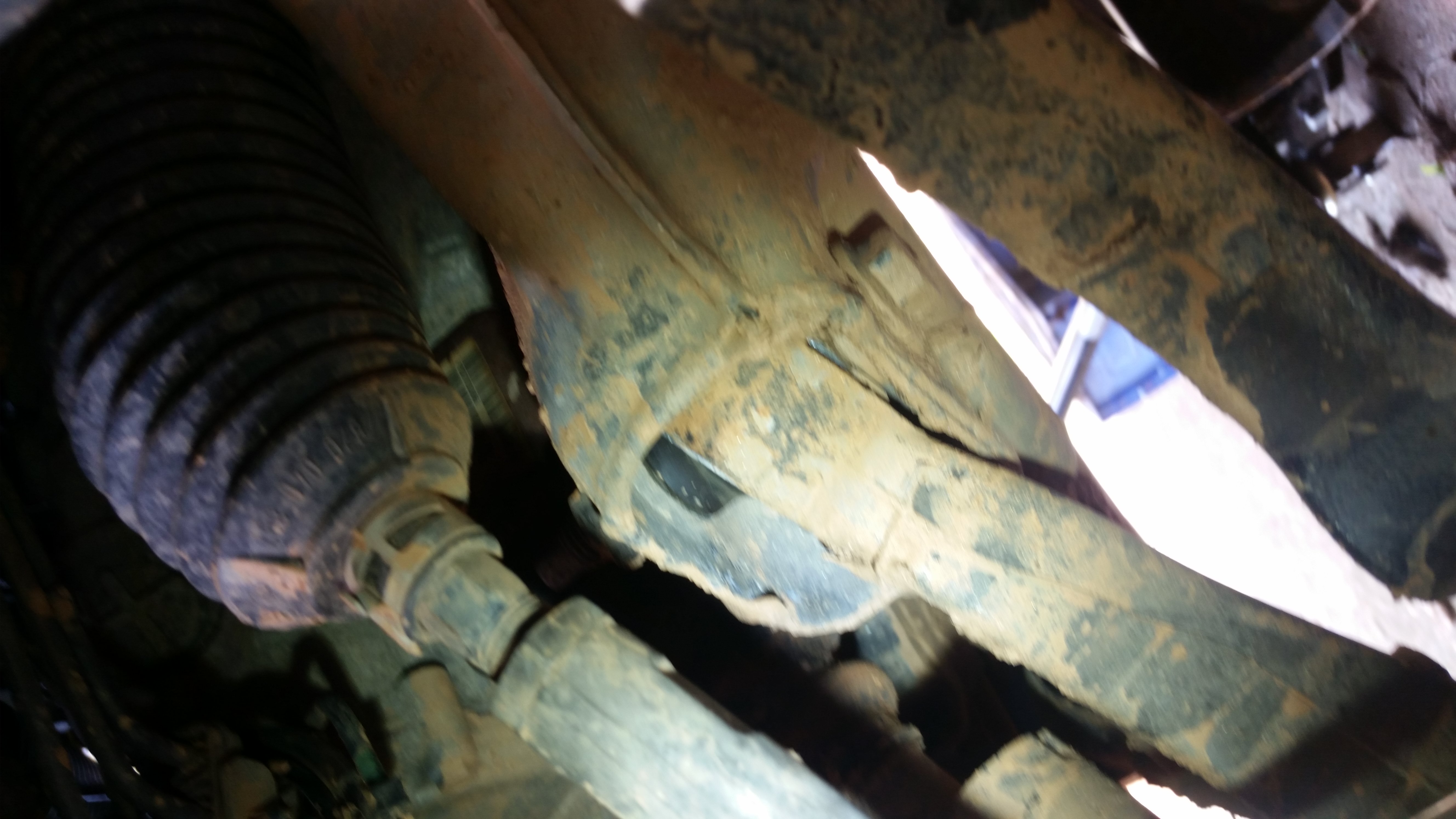

In the meantime, I had a chance to dive under the car and see what was up.
The transmission engine mount and the top engine mount are completely shot (like can move them freely around with my fingers shot).
I'm willing to bet that if these easy to access ones havn't been serviced, the harder ones havn't either.
I'm not seeing any contact between the control arms and the subframe (I've heard the rattle since this GA clay found its way into the car).
