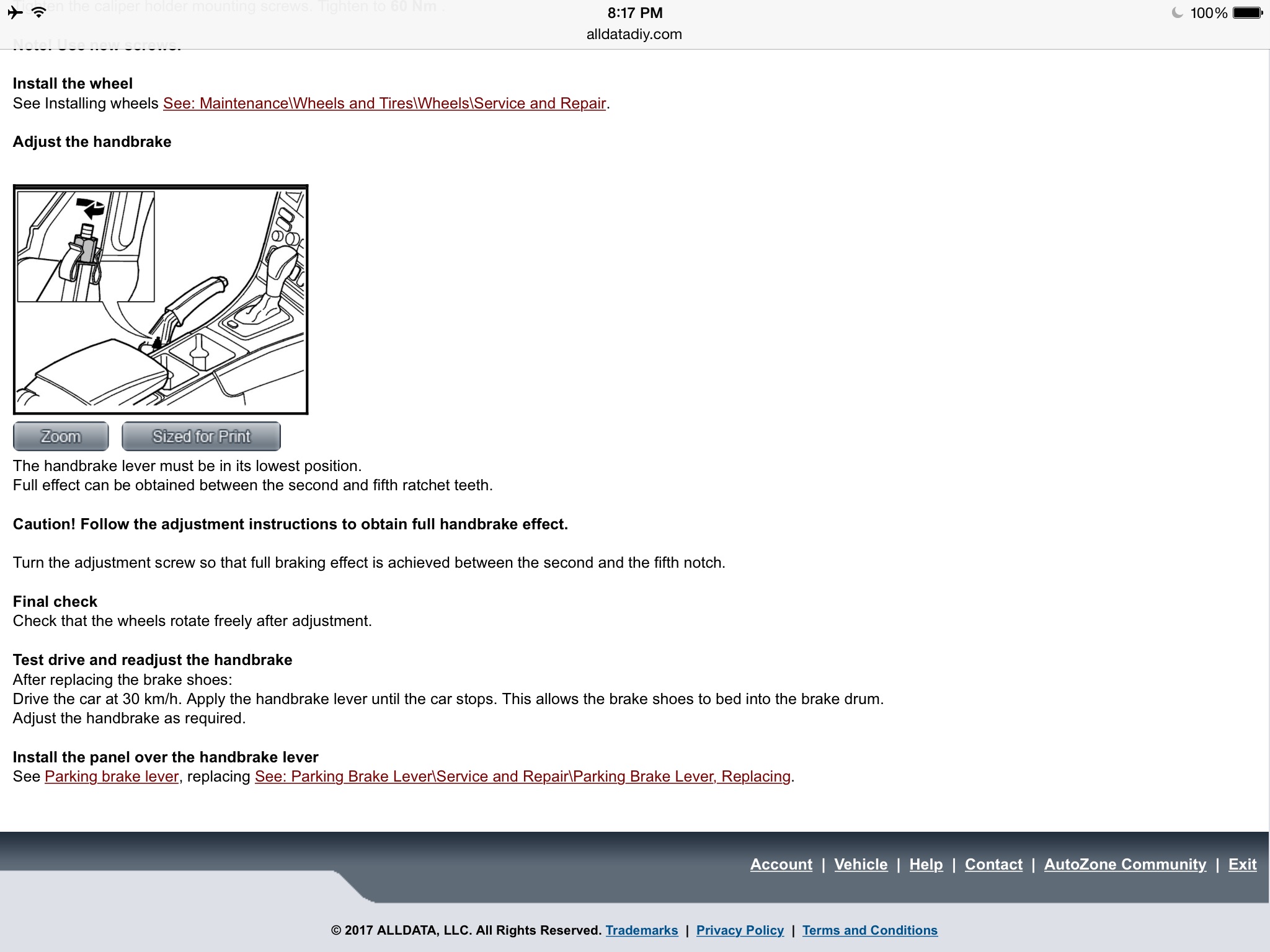

Full brake effect between 2 and 5 pawl tooth on brake lever is spec.

OK... Let me clarify...
With the E-Brake on, the car moves a couple inches, then stops hard! It will not roll under acceleration. So it's not a question of adjusting them. That was an "also" question that appeared to confuse... I'm sorry.
The base issue is... When I pull the E-Brake, there is movement in the wheel... Like an auto trans bouncing off the lock... Is this normal and if so, what is acceptable? If not, what parts would likely cause this I.e. what parts would I have on hand before opening this can of worms?
It's like the shoes move several degrees before they hit their stops, but they are locked to the hub when this happens. Maybe the shoe seat area or spacer U area is worn allowing them to rotate before something stops it??
I'm just trying to figure out what I might need before digging in.... Or if I even need to!!
Cheers!!
