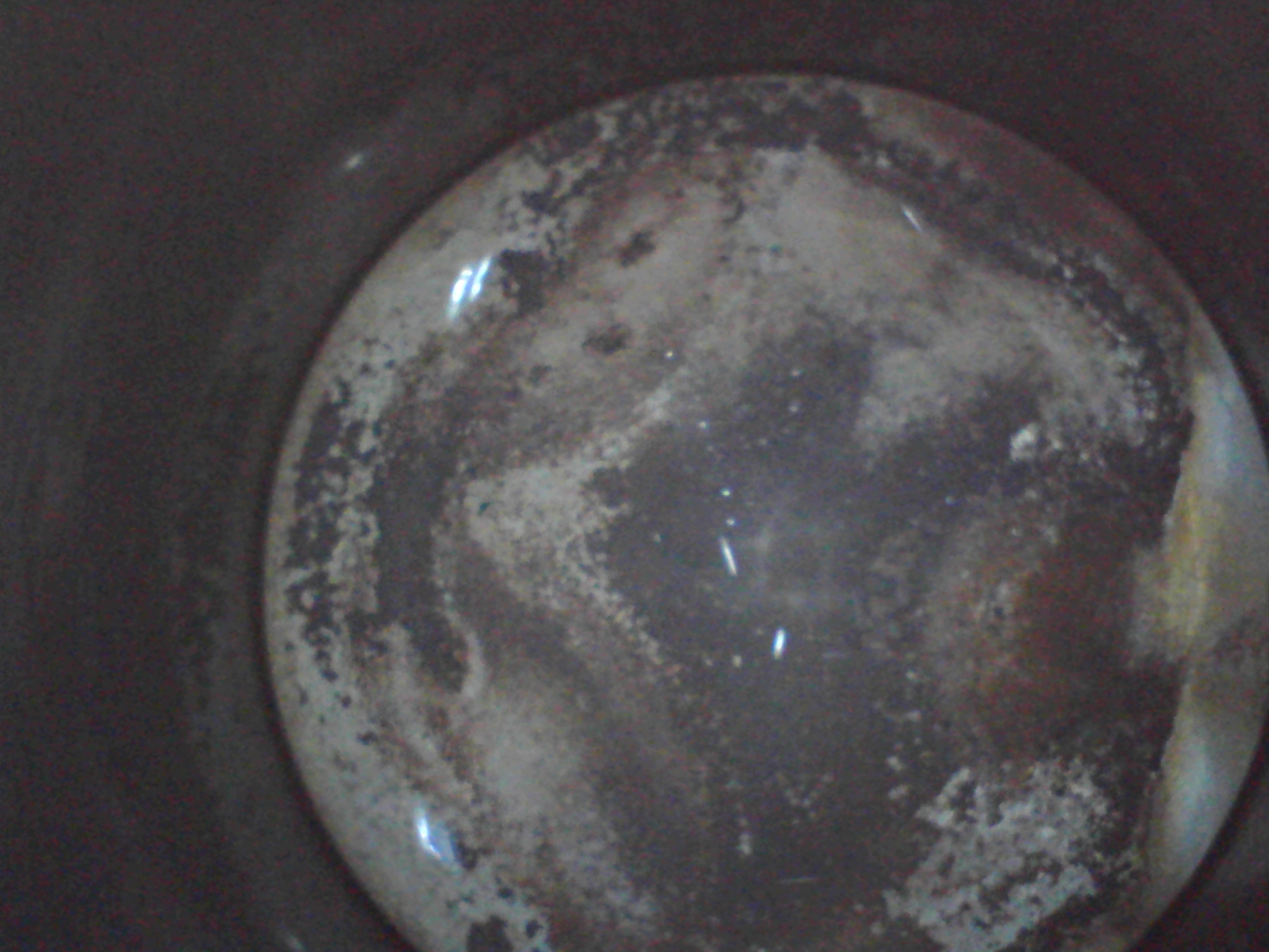

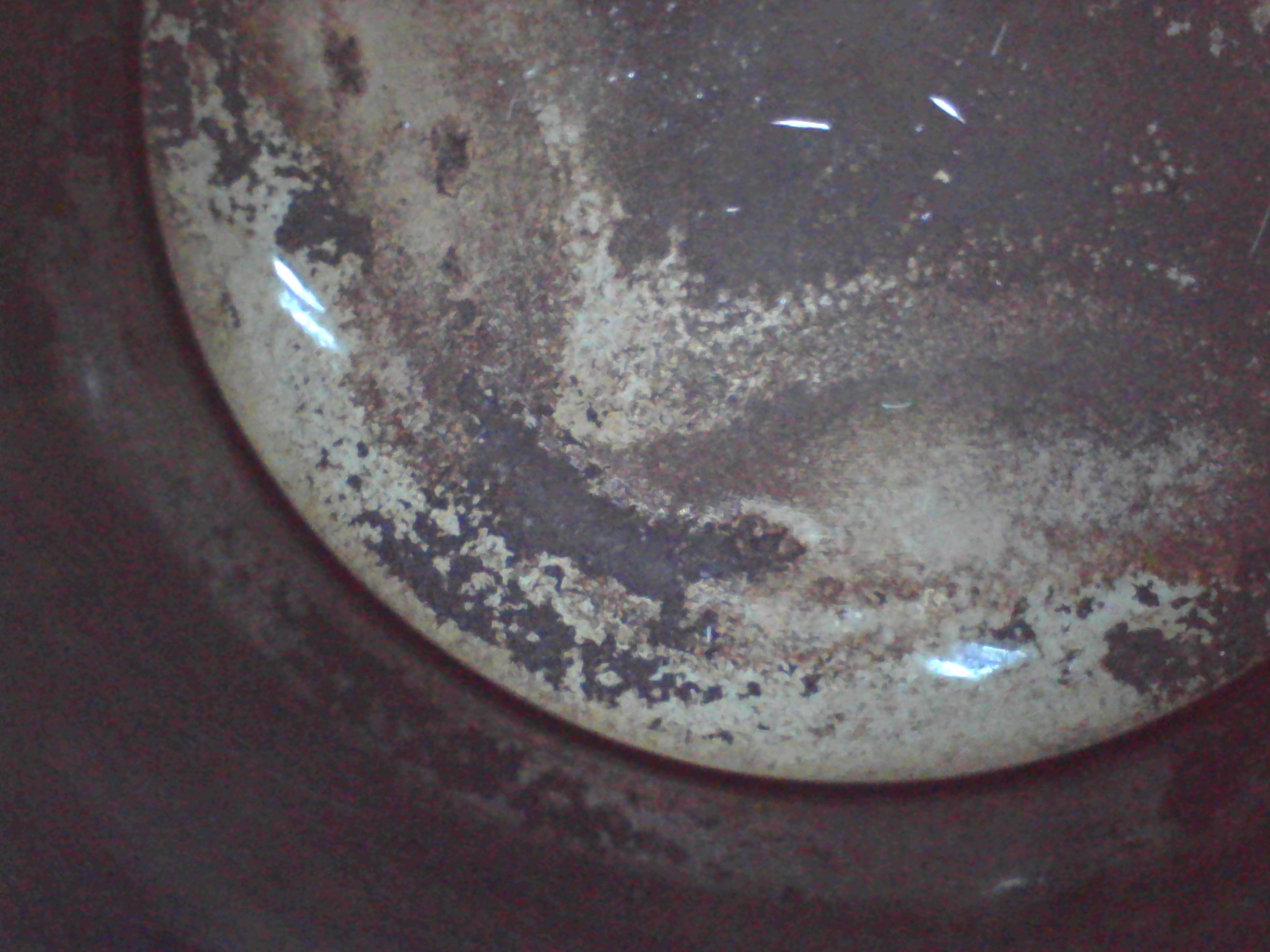

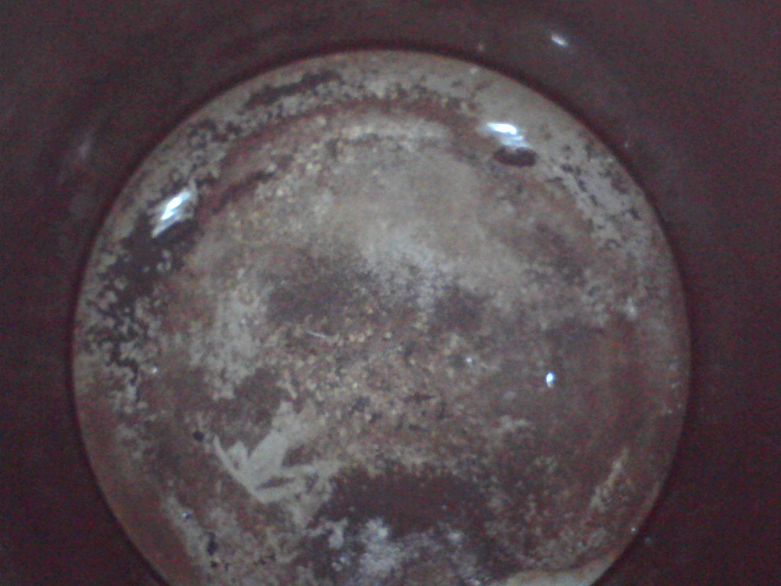

Compression is low across all five cylinders, at ~95psi. Nevermind the CANbus issue and the JBWeld on the crank sensor, I think I need to address the compression first.
Using a borescope, I can see on all 5 pistons where it looks like the exhaust valves have hit the pistons. I see two matching shiny divots in each piston. They all look about the same. Looking back at the valves, (tough to do,) I don't see any noticeable damage to the valves, but the piston faces tell the story.
Now I'm trying to decide between $600 for a rebuilt head, or $500 for a junkyard engine. Any thoughts?
Roger

So I think I found the issue. I didn't want to pull the head (yet) because bent valves didn't seem to be the full issue. They would make sense for the low compression (maybe), but not the cam sensor issue. Also, when I read reports of people bending valves, they generally seem to get "no compression", not "low compression". I figured that the "low compression" and the cam sensor had to be related, I kept digging.
Since I meticulously set the cams with the crank sprocket dead on the mark, and I figured they pulled the crank sprocket when they did the oil seals, I thought "what if they managed to screw up getting the crank gear indexed correctly?"
I found the crank nut on at probably >400 ft-lbs. It took me standing on a 6' cheater bar to break it loose.
Sure enough, they had screwed up the crank gear. I think they didn't tighten it up, and it slopped around for a while. The splines inside the gear are worn almost flat. If it's half-way on, then the remaining splines grip properly, but once it's all the way on, I get ~10° or more of slop in the crank gear. Not good! Fortunately, the crankshaft _seems_ to be reasonably undamaged, and it's the gear that got worn.
If the crank gear was 10° off, that would explain both the low compression AND the continuously occurring "cam sensor" fault code. I am hopeful! Getting a new crank gear ordered, we'll see how it goes. Stay tuned...
Roger
