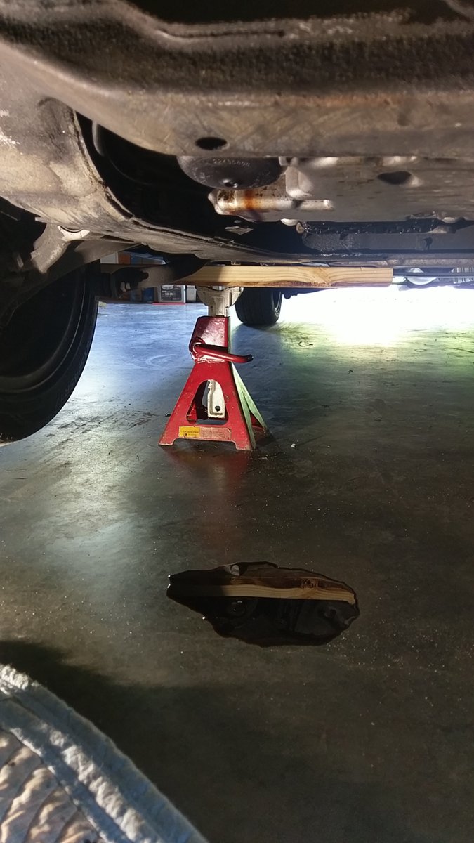

I kept getting puddles, no kidding, puddles, of oil under the car. I saw evidence of it spraying down the length of the car and it coated most of the lower timing side of the motor (my cover is gone, so lots of wind). I'd clean it off and take it for a drive and it'd be everywhere. It would drip down eventually, but no clear indicator of where it came from originally.
I cleaned it all off and power sprayed it clean, jacked up the car and let it idle for 30 minutes. Nothing! Amazingly not a drop. So I lowered the car and took it for a drive. NADA!!! WTF!!!
So I come out the next morning and a 8" puddle of oil is under the car!
Puddle of Oil... sounds like a new band!
The good thing was that this happened after I cleaned the car and you can see that it dripped straight down from the oil filter housing area. HA ZAH!!!! Now I have a focal point to start looking at. So I clean it all off again and let it idle..... NADA. Not a drip! OK... Now I am pissed. I let it sit and cool while I do other things and cool and when I come out.... Puddle! YOU HAVE GOT TO BE F"ING KIDDING ME!!!

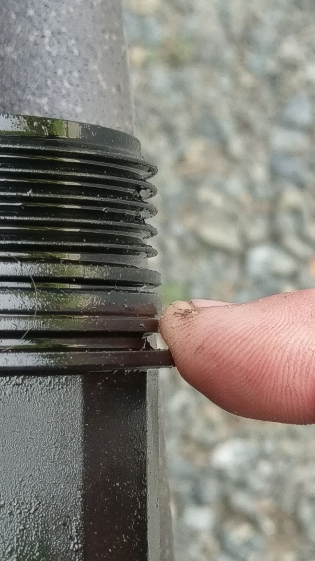

So, as improbable as it is, it has to be the o-ring. I pull the filter housing and... well, I'll let you fill in the expletives...
Flat o-ring!!!
Flat o-ring!!!
This was a brand new o-ring I got with a Mann Filter. Less than 1500 miles. Flat as a board. It seems that it would seal quite nicely under pressure, but when the pressure leaked down to some lower value, it let loose and bled off all the pressure externally. I swapped in the o-ring from the previous filter housing and took it for a drive. 12 hours later.... not a drop. Only change was the o-ring.
So, the moral of the story.... don't overlook the simplistic solutions... sometimes they truly are the answer!
