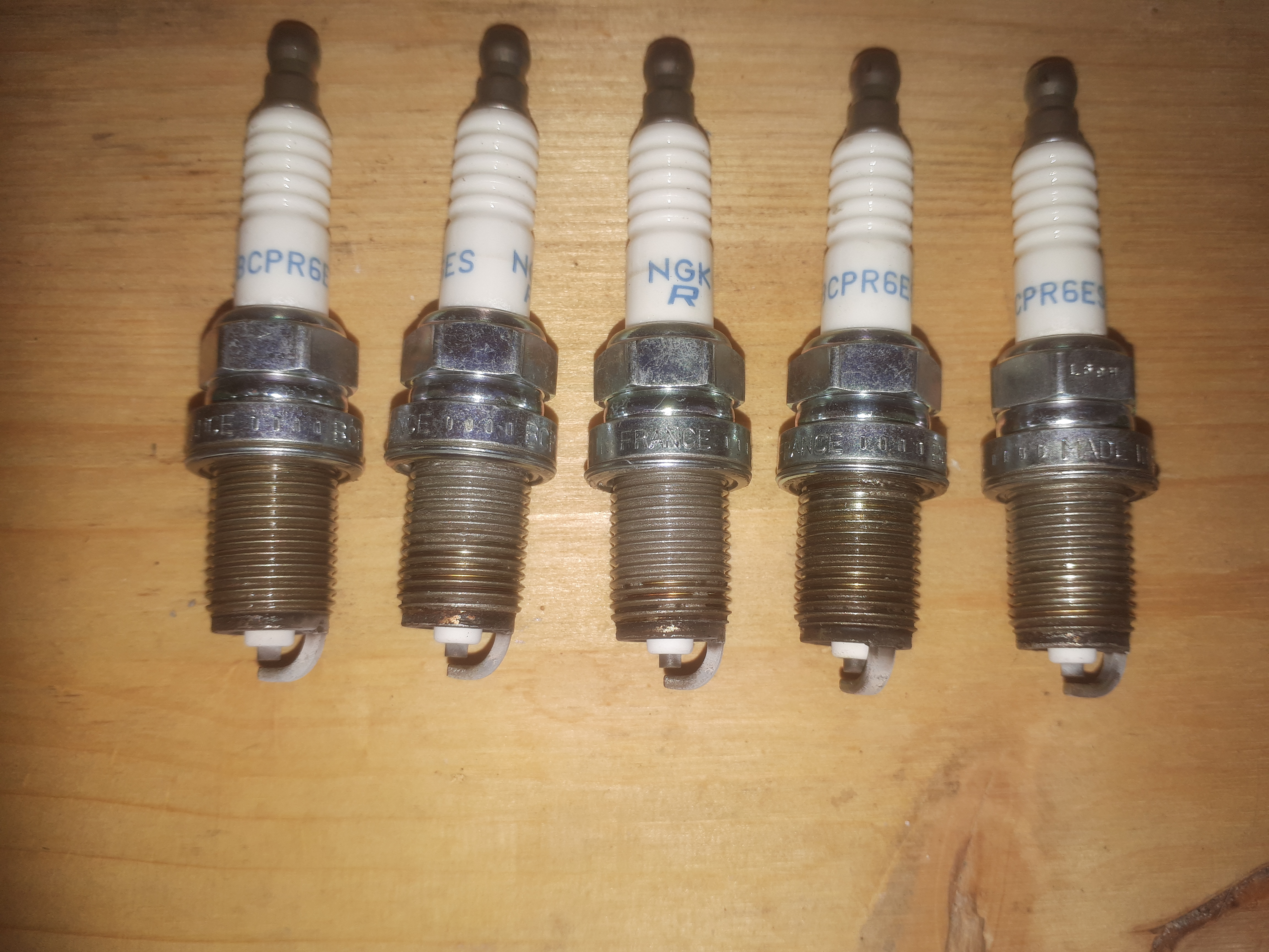

The old spark plugs with about 500 miles on them look like this:
To me they look kind of worn for such a little distance.

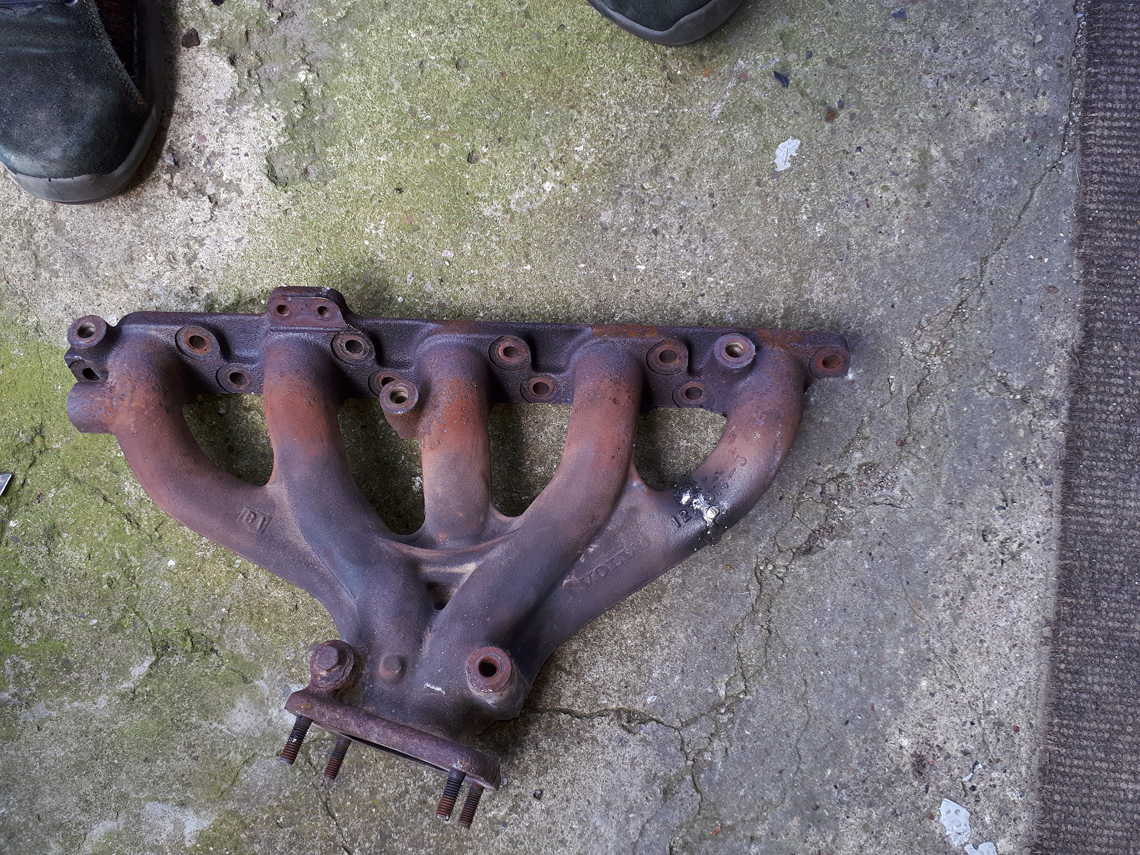

Saga continues, wasn't a bad fuel pump, nor relay, nor the IAT. Though I consider the relay and pump preventive maintenance and the IAT needed replacement anyway.
No, the culprit is unfortunately this:

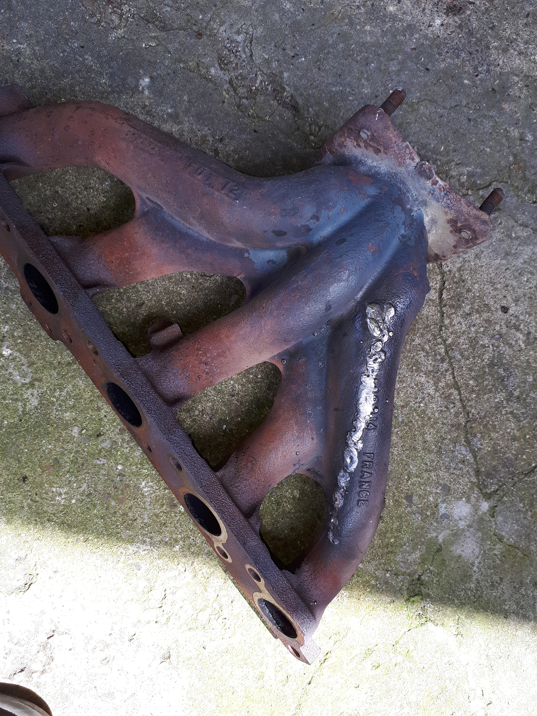

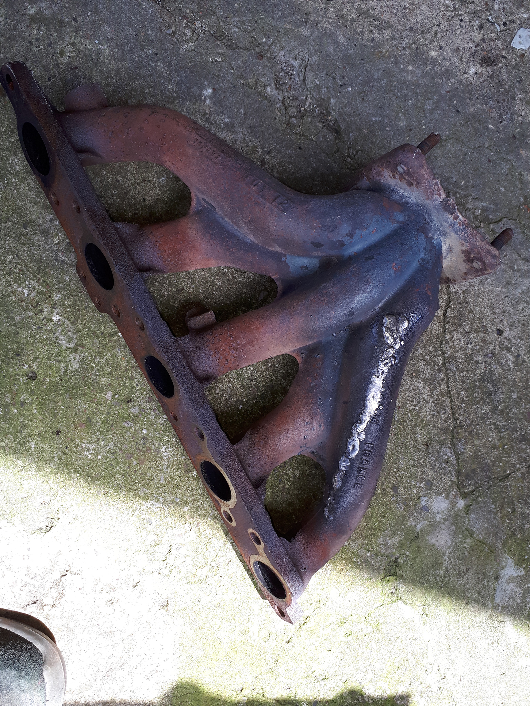

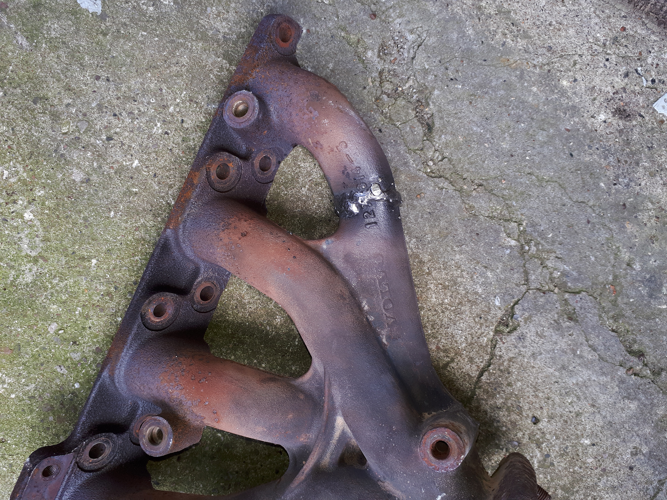

I managed to procure some stick welding rods for cast-iron and welded the cracks in the manifold.
I'm not a professional welder, certainly wouldn't get through any inspections of my welds, but they all solid with full penetration. More importantly, no new cracks formed during or after welding.
Put it in back in the car and thought my struggles were of the past. No, they're not
