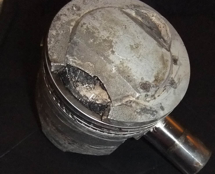

Bent valves really aren't that big a thing to deal with, though anyone would prefer not to if they can help it. I understand. For a little perspective here's something a little more "involved"
Off a Toyota 5MGE engine I worked on for my sister nearly 20 years ago. She didn't have $ for machine shop service I recall lightly honing/deglazing the bore with a hand drill tool, replacing the broken piston, and new valve stem seals and two new valves merely lapped in. It ran fine until the body rusted out terrible about 5 years later. It used a little bit more oil after that but not enough to smell/see in the exhaust or cause problems.
The interesting thing was the metal that broke off the piston wasn't in the cylinder. Which means it shattered into tiny bits and pushed out the exhaust. There were only a couple minor collision pits on the aluminum head so it didn't last long in there.

Thanks for the quick replies guys! @mrbrian200 wow that is amazing! I feel more motivated than ever to tackle this project now. @SuperHerman, that's good to hear that the Head Gasket wasn't too bad as removing the Head and replacing valves may be in my very near future.
