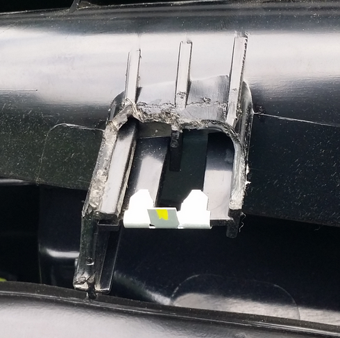

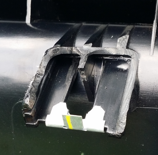

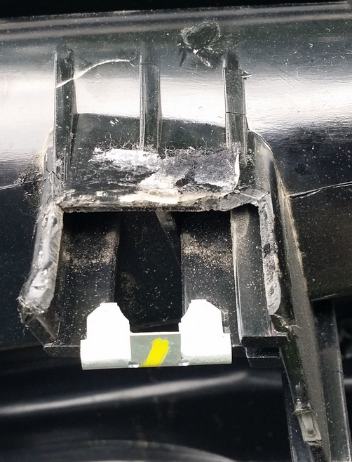

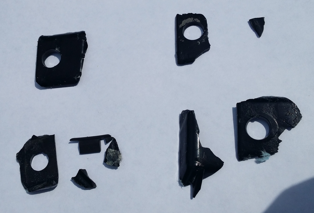

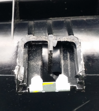

Once out, I discovered that all 4 of my mount points had failed completely. two had failed by breaking in half and two has also cracked at the dash itself.
Attached are the pictures of my failed mount points. I just realized none of my pictures show the square nuts. I didn't lose those. I just didn't put them in the pictures.
As you can see several parts of my mounts had broken into many pieces. From the factory the mount points are wrapped in an anti-squeak/fuzzy tape. That tape is the only reason I was able to recover so many pieces of my mounts. The pieces were still stuck to the tape. In fact, when I first removed the dash, I initially thought two of my mounts were ok because the tape was still holding them together. It was only after i removed the tape that I learned how intensive the damage was.
What is not shown in the pictures is that two of the mounts had cracked where they attached to the main dash tube as well.
In preparation for the repair, I cleaned everything with rubbing alcohol. That was the only cleaning solution I used. I also scuffed up the surrounding area with some 100 grit sandpaper. I don't think this was actually necessary for my repair method though.
4 broken points after cleaning up:

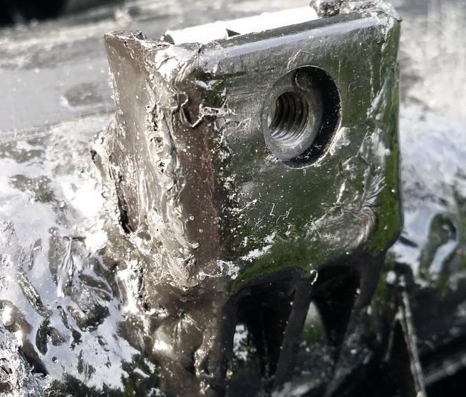

My first step was to use this cement to rebuild all the broken pieces. That went easy. All I had to do with touch each edge with some cement and hold the pieces together for about 15 seconds. I was now left with pieces I could bond back on the broken mounts.
Before I bonded back on the broken pieces, I fixed the cracked dash tube. The way I did that is to complete break the the mounts off so I could expose the entire crack. unfortunately I forgot to take pictures of this part. What I did was grab the loose mount and bend it backwards so it would tear off the dash tube itself. This left me with a nice clean, and gaping hole. But it also gave me great clean surface area for the cement. I dabbed on cement, pressed the pieces together and held in place for about 15 second.
Once I had the pieces cemented back together, they looked like this. The glossy tar looking stuff is the newly hardened ABS cement. This looks a bit messy but it it was only the first coat and was only meant to hold everything together.

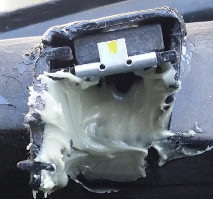

After I let things set for about 30 mins, I was confident that the mounts were reattached. However, seeing how they were supported, it didn't surprise me that they failed in the first place. As people have discovered, the main dash mounts are attached to a thin hollow tube and have little reinforcement to begin with. Several people attached metal straps and used epoxy to provide reinforcement.
I started with some epoxy putty but I used it just to provide some internal strength. I packed the epoxy putty inside the mounts. I had to make sure the putty would not interfere with the bolts. I used the "All Crafts" brand epoxy putty I picked up from a plumbing supply house and I chose this one because it did claim to stick to ABS. If the guy at the plumbing supply house hadn't told me how useful he personally found the stuff, I probably would have used JB Weld or something similar.
This seemed to provided some internal rigidity for the mounts.

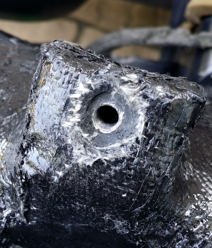

Next on the agenda was to make the whole structure stronger.

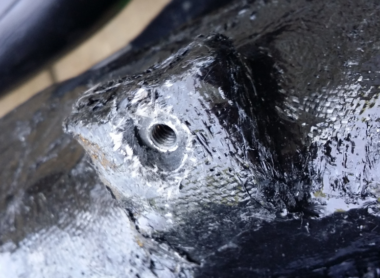

For that I used fiberglass cloth. However I did not use the resin typically used with fiberglass. Instead I just used more PVC cement.
The PVC cement had no problems wetting/soaking into the fiberglass cloth. I started with thin strips to wrap the mount itself. I'd dab some cement on the mount and a little on the fiberglass cloth. I'd then put the cloth on the mount and then smooth it out with my fingers. It's top off the fiberglass with some more ABS Cement to cover any areas I had missed.
I wore medium medium weight (dark blue ones) nitrile gloves and I did not feel the acetone at all. This allowed me to smooth out the fiberglass and make sure there were no creases or bubbles.
Once the thin sheets had set, I started laying down larger pieces of fiberglass cloth.
Here are some pictures showing the mounts close up and the size of the area I covered in the glass cloth.
On the first day, I probably laid down about 2 layers of cloth as well as used several thin strips for strategic placement around the mount and on corners. I could have done the whole job in one day easily but I got a late start on the first day.
I thought I had taken more pictures but alas I didn't. And I'm not taking my dash out again to take more photos. :-)
When I first started this process, I was a little worried that the ABS/fiberglass combo wouldn't work out. After letting it set for an hour it felt dry but still had flex in it as if it was still a bit soft. I believe this was due to there being some residual acetone still in the cement. I let it set outside over night and in the morning, I was pleased to find that it was now quite rigid. On the second day, I just repeated the process and laid down some larger sheets (6 inches wide) that spanned both sides of each mount. I wanted to create a wide base of strength for the mounts. In the end I think I went about 4 inches to the left and right of each mount. I also put fiberglass in the front and behind each mount. In fact , each mount ended up being encased in fiberglass. Only the bolt hole was exposed in the end.
The ABS cement performed like I had hoped and I seem to be left with fiberglass reinforced ABS.
The mounts are all much stronger now. They have no flex at all the the overall structure is a lot better.
So far I'm very happy with the way it turned out.
