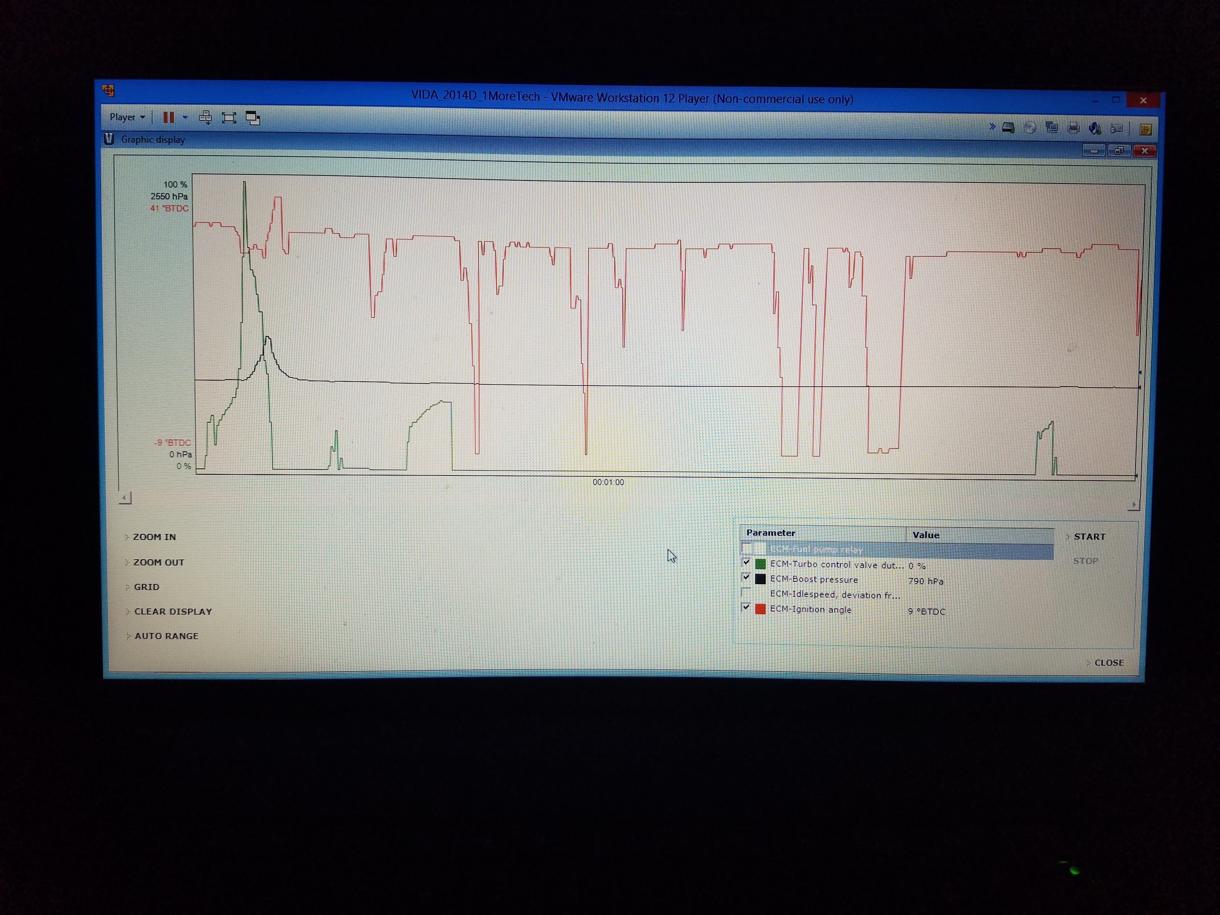

I'm having a hell of a time trying to figure out where my boost is going.
When I accelerate hard my boost will rise to 9-10psi then just as fast drop to 1-2psi.
I spent the day tracing and fixing even the smallest leak in the hoses. Oil, plugs, coils, ECT, all filters and nearly every hose are new.
I just ran out with the VIDA and ran up the Highway to check the duty cycle on the TCV. It looks like the duty cycle is dropping off while still under full throttle. This can not be normal, right?

Anyone have experience with boost drop-off? Please help.

The CBV diaphragm could have a hole in it and is dumping too early, but usually it's hoses or an aged TCV.
How old is it? Performance drivers will replace at 100k miles. They get tired

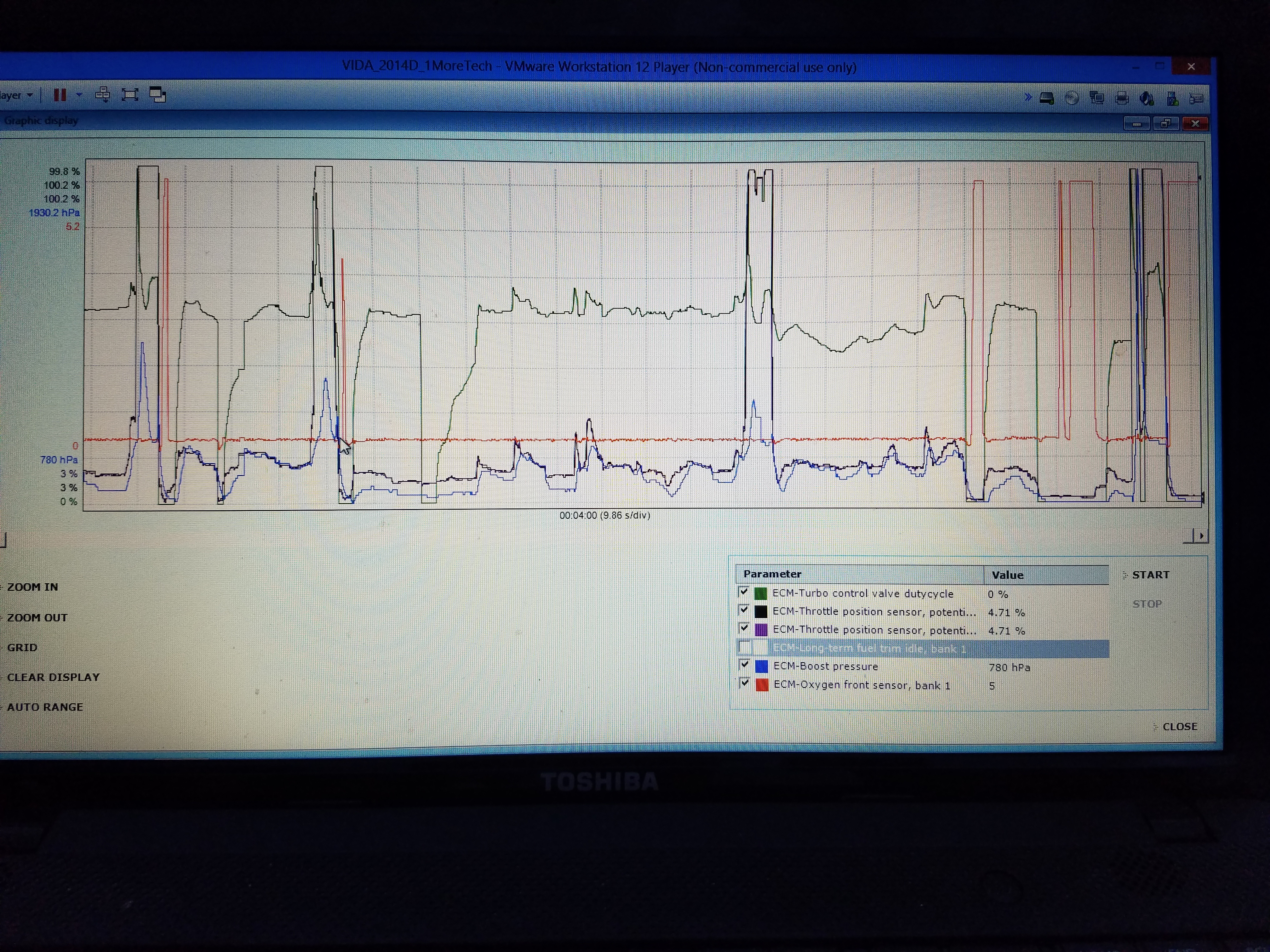

I am still waiting on the USPS to drop off my TCV. I decided to log a trip and watch the cam. It seems a little erratic to me. Of course I'm used to the good ol 350, where the only "ECU" in the thing is between your ears.
Is this cam angle movement normal? If it's not, could this cause the ECU to cut boost?

It seems to bounce around a lot with boost pres. & TCV % flat .

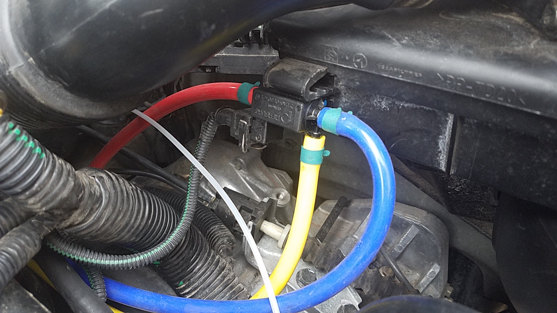

Solved...so far.
download/file.php?mode=view&id=35750
The new TCV came in. The red compressor line is a PITA. Went for a run and there's no surging or fluctuation, just a smooth climb to 7psi. Happy day!
Sticky TCV solenoid. I had the same with IPD HD TCV (relabeled universal TCV made in Taiwan), which failed within the first year.
