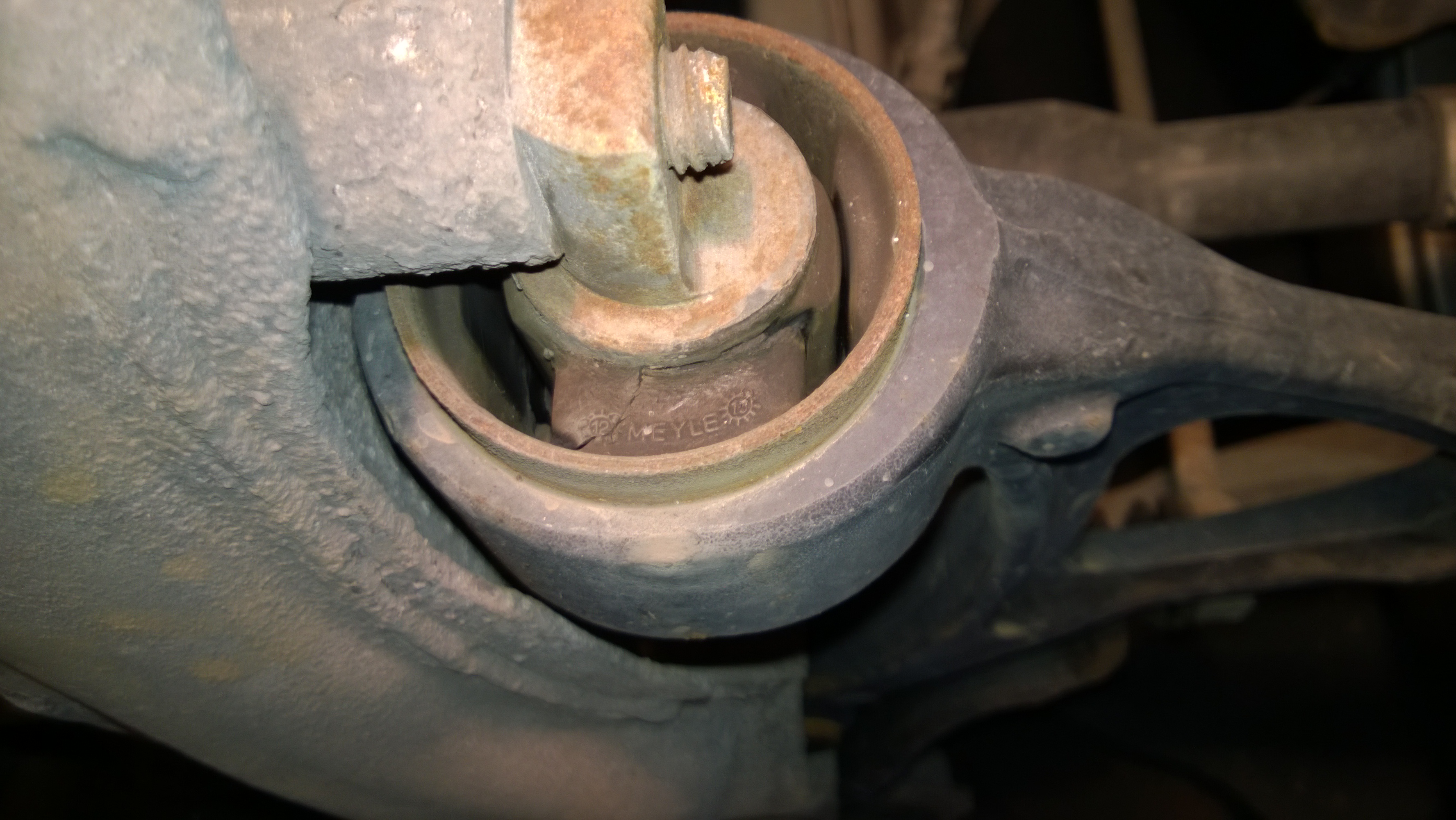

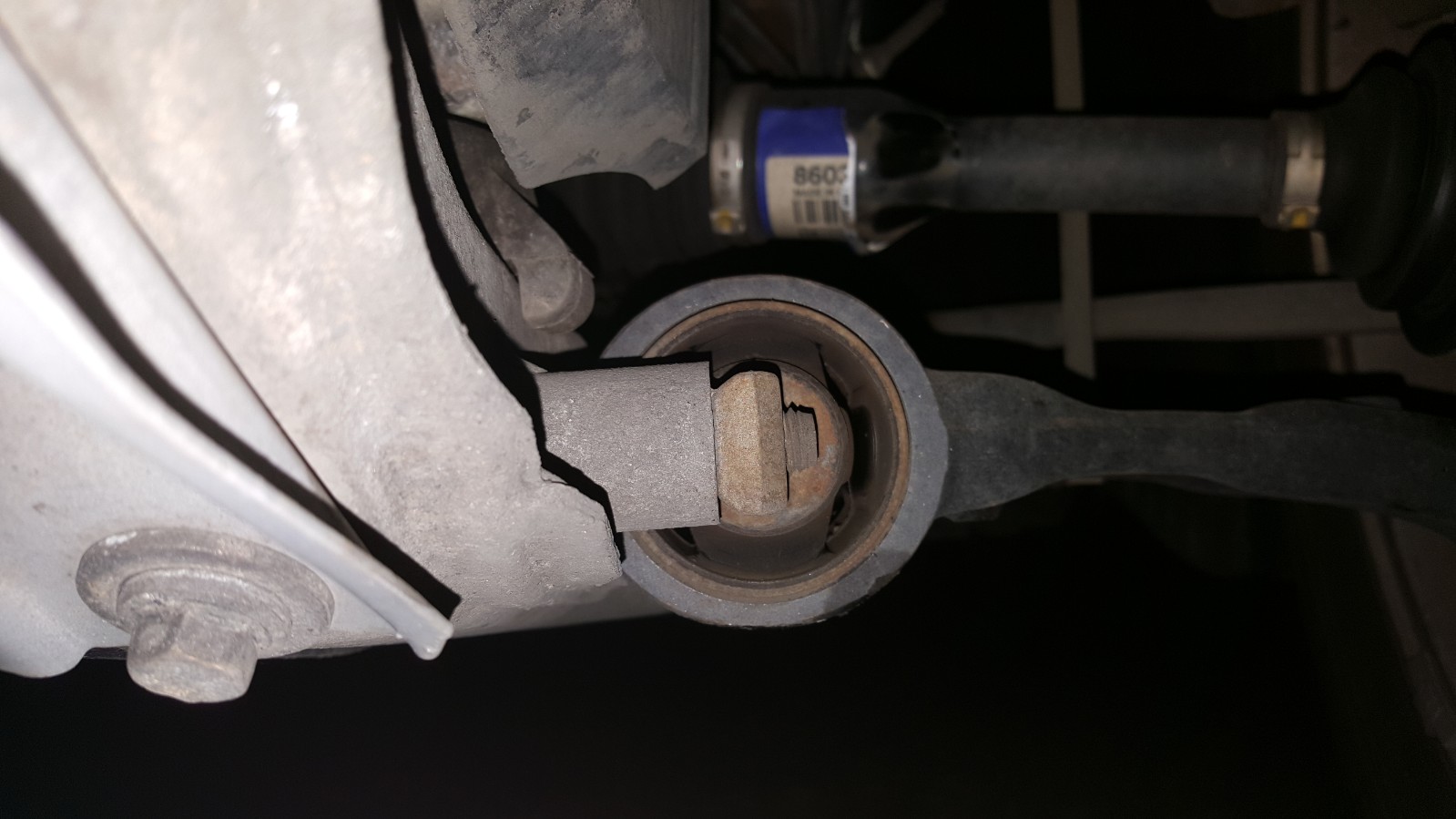

I've scoured the boards for advice and most point me in the direction of the Control arm bushings so I took some photos and have attached them. Apart from the oil leak - Do they look good?

I would first check and make sure all the bolts under there are good and tight especially the control arms shown.

The bushing you looked at are the "usual culprit", but from the photos, yours don't look that bad. There are also the bushings at the back of the control arm (bolt is vertical, not horizontal) that can also fail - worth inspecting.

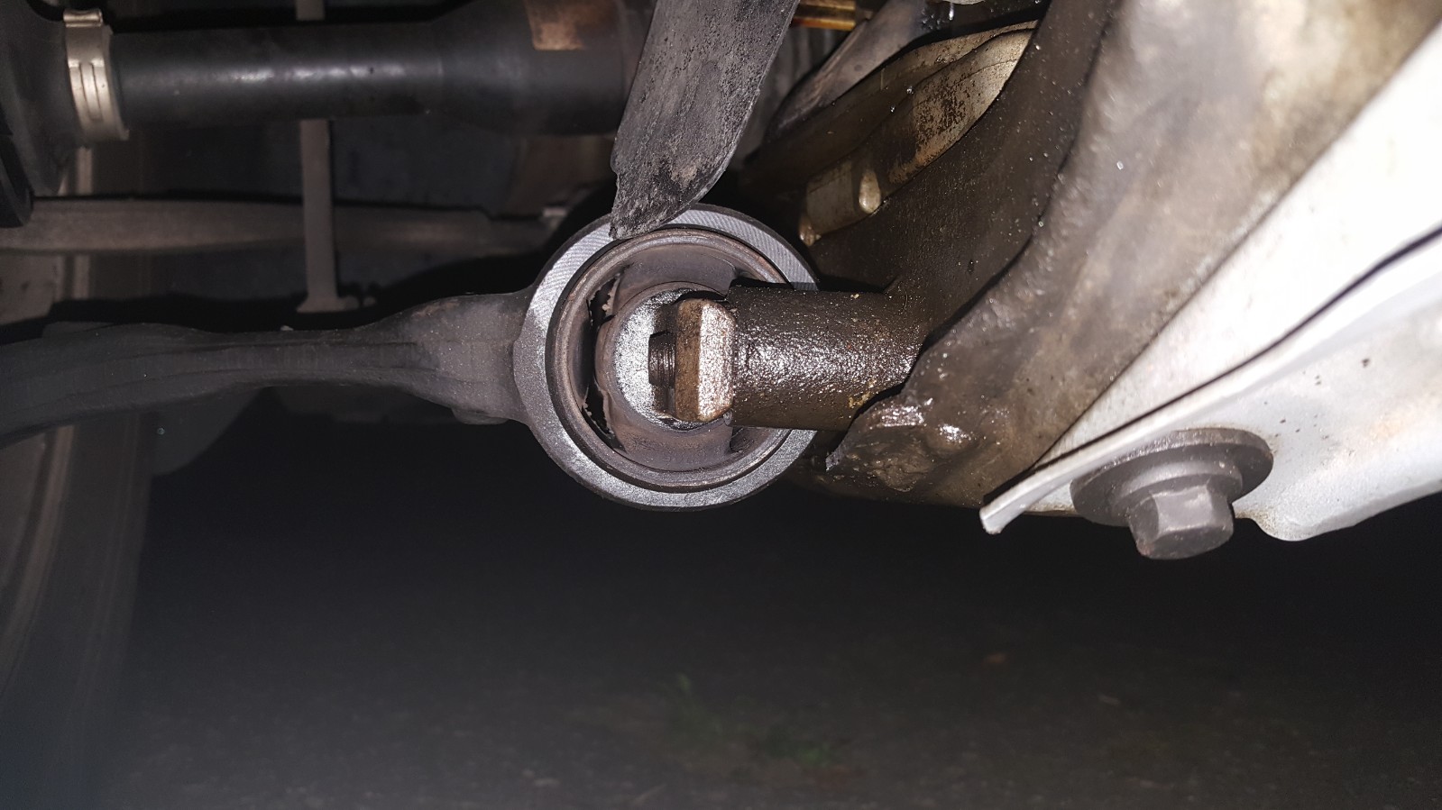

When you step on the brakes, the bushings in the lower control arms have to absorb the force of the braking vehicle. If it's the control arm bushing, then I am guessing probably the left wheel is slightly turning out as the bushings compress (or give up), causing the car to head to the left with no input at the steering wheel.
One note - I find the XC90's tend to go through the control arm bushings with some frequency, and some of the cheap brands don't last nearly as long. I find I get more than 2x the life out of the Volvo control arms, (over the aftermarket ones,) so even if they cost a lot more, it's worth it because I don't have do deal with it again.

Here is a picture of one that failed on me, for reference. (Yes, you can see which brand failed after 15k miles, if you look closely...)
