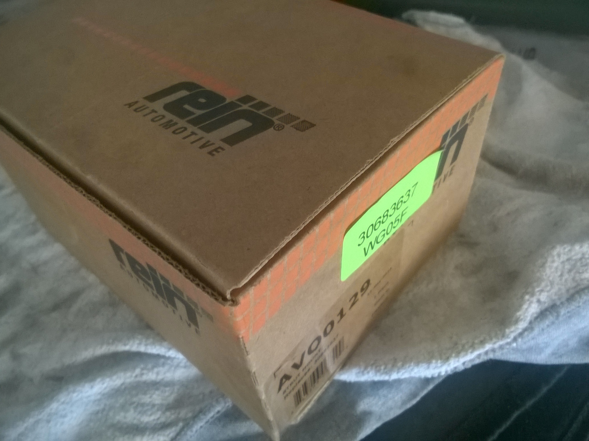

I put a set of them on a car in the Chicago area 10 days ago, they came in reins boxes and had Volvo scraped off of them. Supposed to be the good XC90 ones but 1/2 the price. I guess we get what they give us.

When it's 1/2 price... it's shady. I bought control arm rear bushing Lemforder in Lemforder bag and box, cracked after 1 year. There is a market for fake parts, even with the 'Volvo' name scrapped (chinese market is genius for that) I remember seen more than one variant of the XC90 'redesigned' spring seats, my guess is there are low quality brands out there who simply added some extra rubber but used the same horrible rubber quality you'll get from, say, Sweden Parts. Personally, I'd rather use the old regular Sachs ones, than fall for the 'beefed' up XC90 one. After all, the original Sachs ones do last a good 8 years, well worth using them again on a 100K miles car. Finally, I'm not sure about this, but the original spring seats on my car had a somehow great 'floating-plush' ride feeling on a highway, which I've lost once I've replaced them with new Febi (which are terrible by the way, cracked after 1 year).
I now run on Reins boxed spring seats from Eeuroparts, 1 year since bought them new. Last year I checked and there was already a sign of worn rubber near the sleeve. I'll check them again this week. The guy from Eeuroparts was convinced these are original Volvo parts in 'white' boxes. Here's his email, this week I'll have the answer if he lied or not

Hello,
I believe that Volvo uses an array of OES and Hutchinson is one of them. The quality is top notch and I would not hesitate in the least to use their product. I am a retired Technician of 34 years and a shop owner and have installed numerous Hutchinson parts and have never had any issue. Stay well, and thanks for the inquiry.
