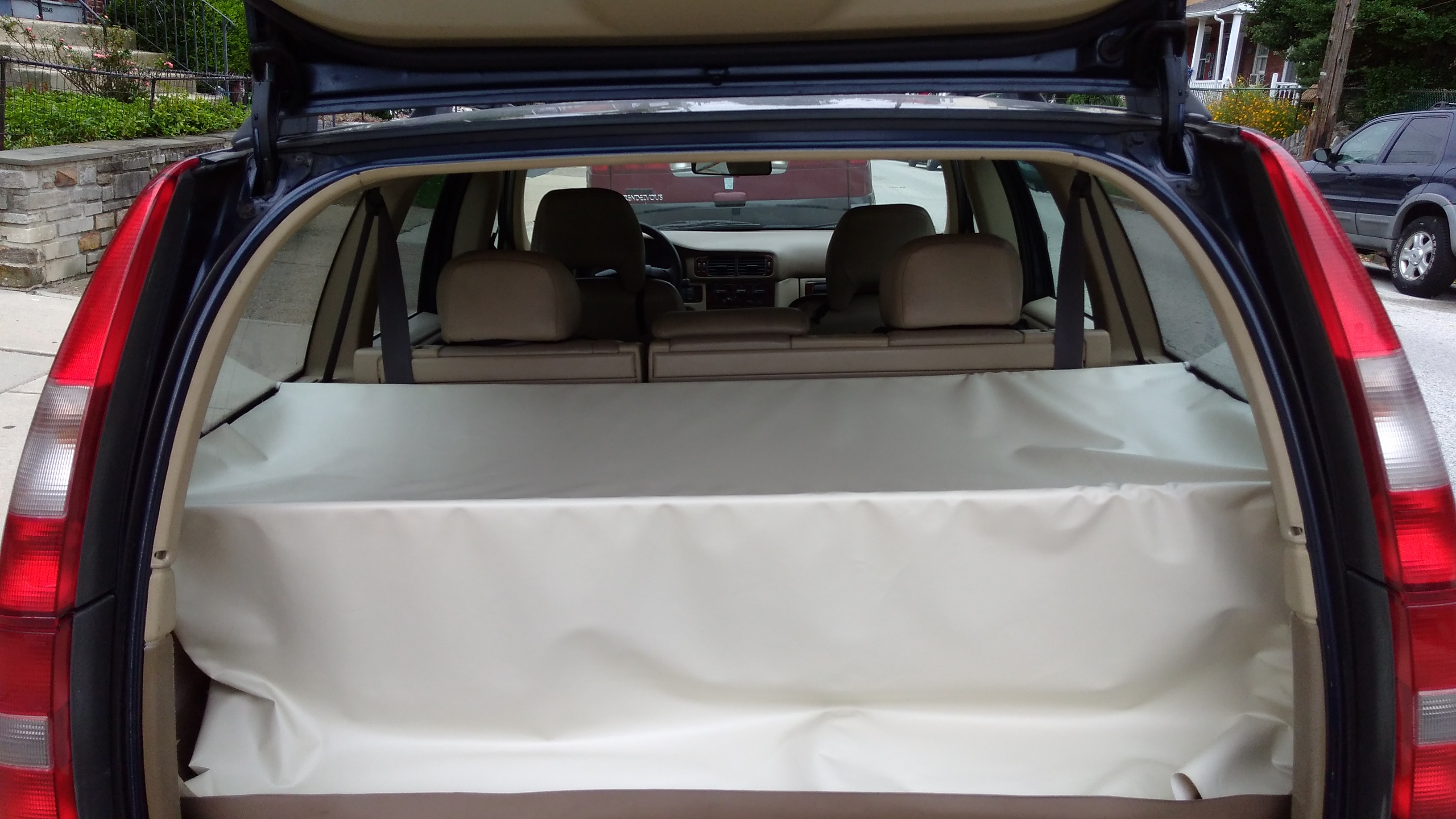

Here's the general view:

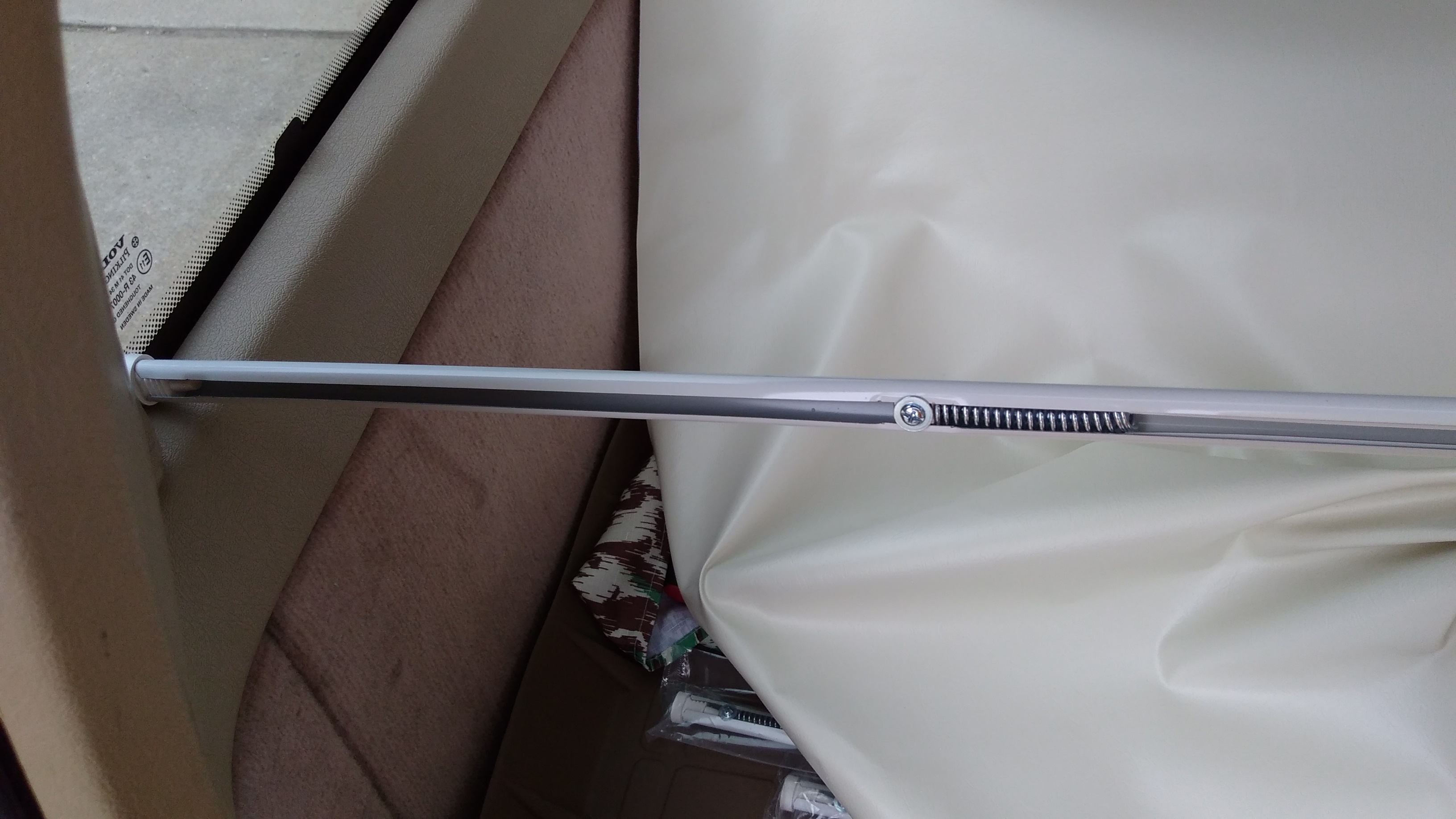

These rods are pretty sturdy. You extend them to the length you want and then tighten the screw on the movable spring. Where you position the screw determines how much spring tension you will exert, and I can tell you that you need very little.

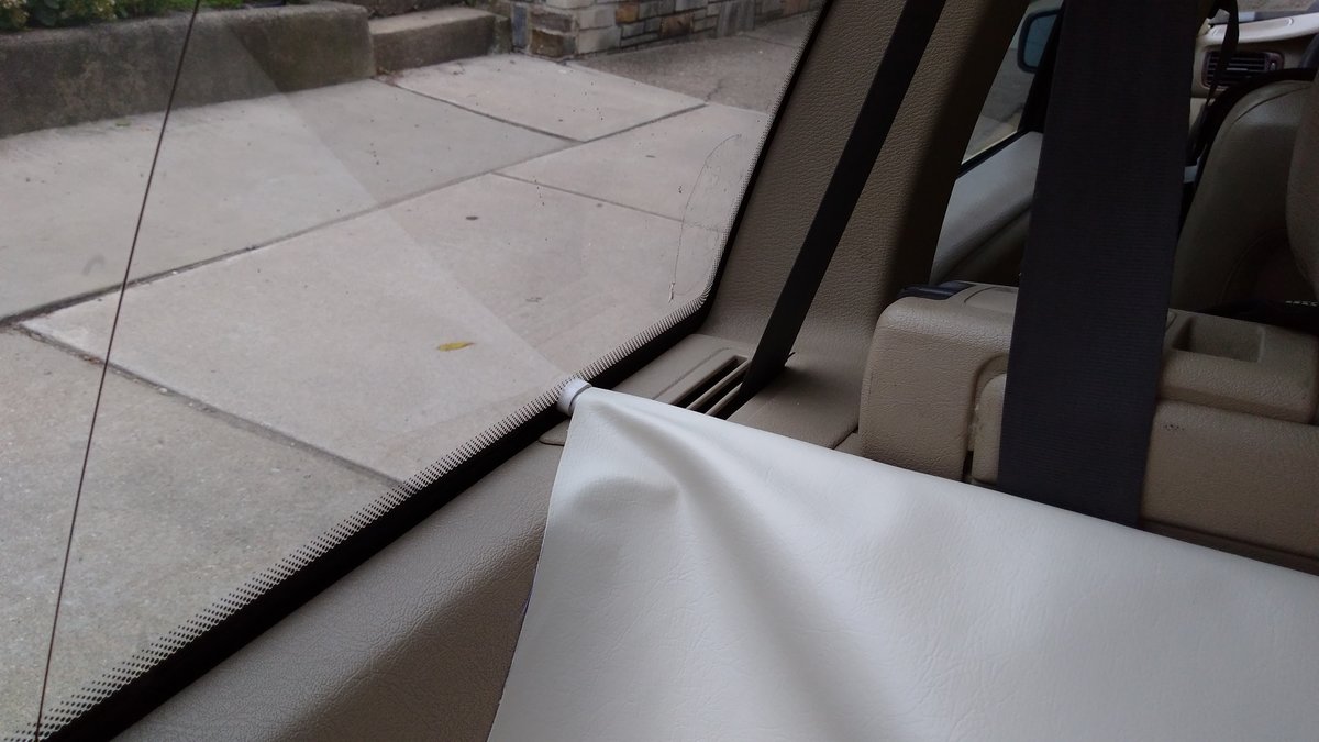

Here's a photo with the rod turned up 90 degrees to show the spring.

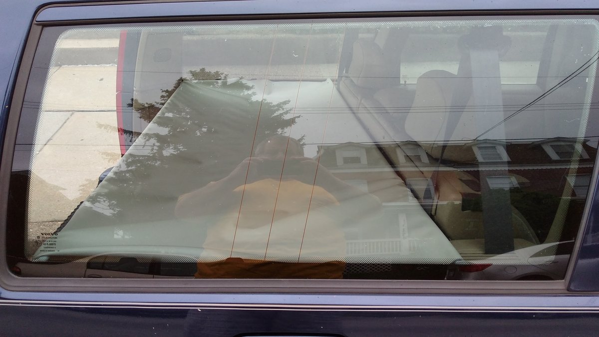

Right now, I have the rubber ends of the curtain rod running from side window to side window with very little pressure exerted on the glass. It's not pushing the window out of the car or even bothering my window film.
The old material I am using is a faux leather that is basically vinyl bonded to a canvas backing. It's important to measure accurately and then to make sure you cut the material so that you end up with a rectangle and not some sort of trapezoid. I used a large carpenter's square to get proper right angles. I did my cutting very carefully using a simple rotary cutting wheel on a self-healing cutting board my wife uses in her sewing hobby.
I attached the material permanently to the support that sits just behind the back seats using contact cement. You need to glue the material square to the rod, or else your cargo cover will veer wildly to the side. I glued the material directly to the rod, then rolled some more onto the road and glued that. In all, I think I glued it three times to the rod. The glue I used was "Barge All Purpose Cement, Neutral" which is popular for shoe repair. EDIT: I now think it might be better to fold the material over to make a sleeve into which the curtain rod can be inserted because the rod will shorten slightly when installed under spring tension causing some wrinkles.
Then I installed the rods and simply laid the material over the rear rod. As it was cut, the material is long enough to go beyond the rear rod and down to the floor of the cargo area. When the tailgate lifts up, there's actually a small area where you might be able to place groceries without lifting the cargo cover. I plan to do some trimming of the cargo cover so that it matches the space more closely and looks a bit less sloppy. If I do any refinements or make a second attempt, I will edit this post and show photos.

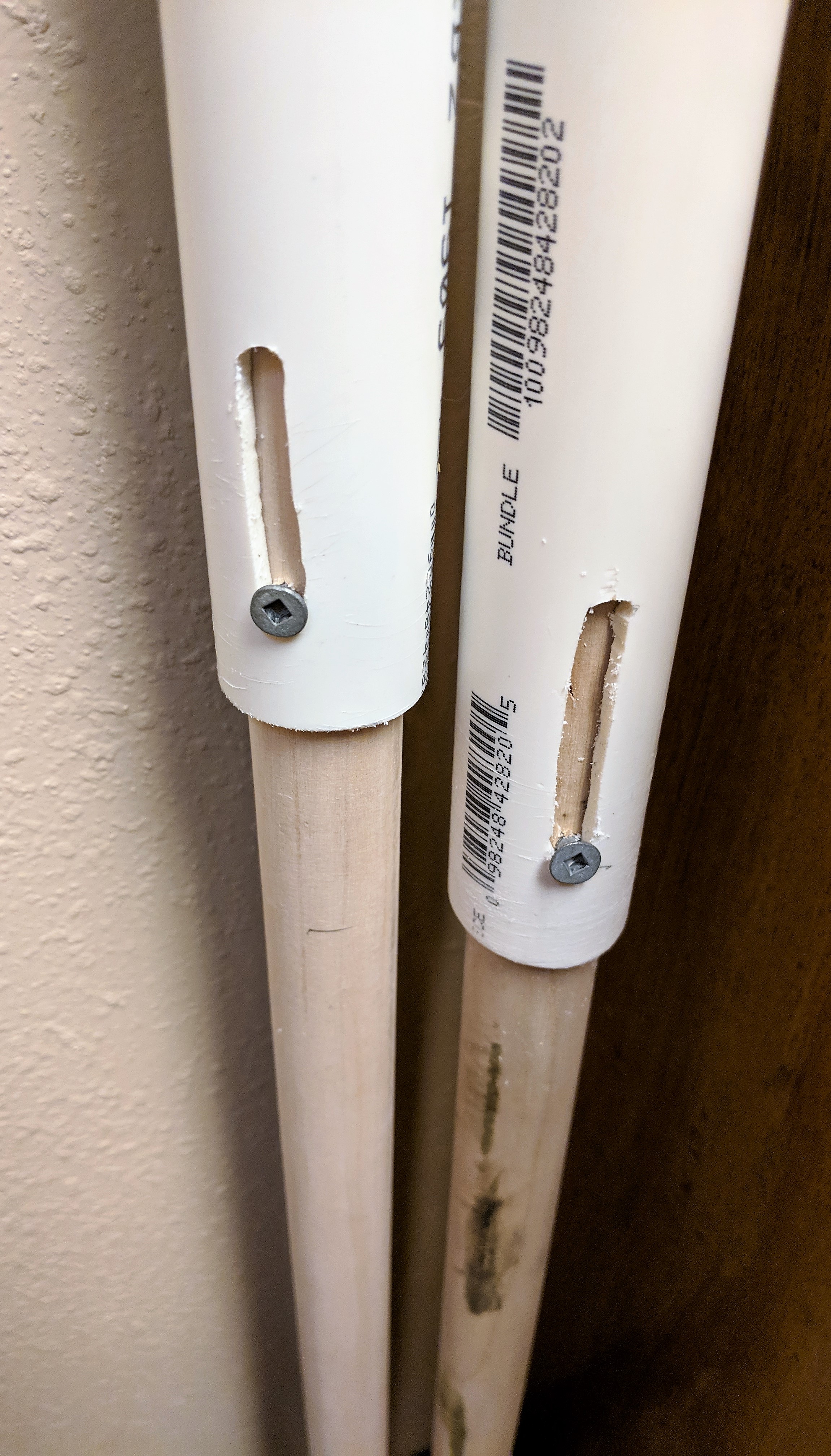

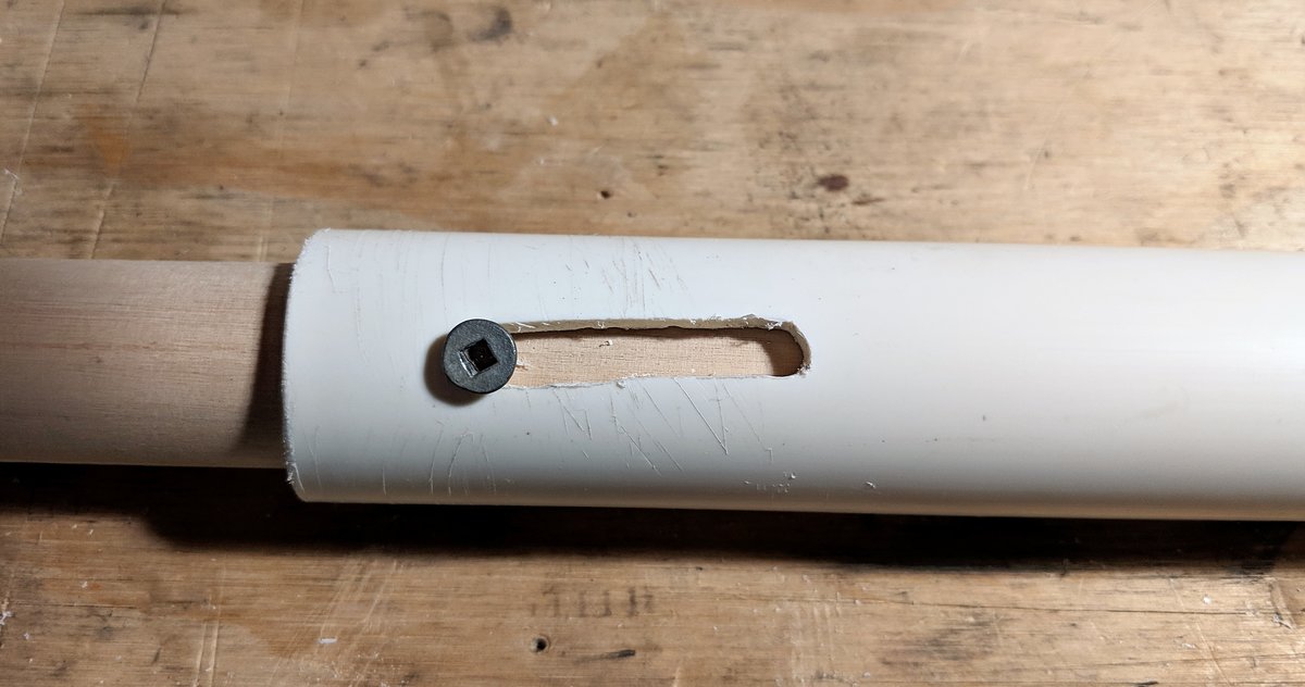

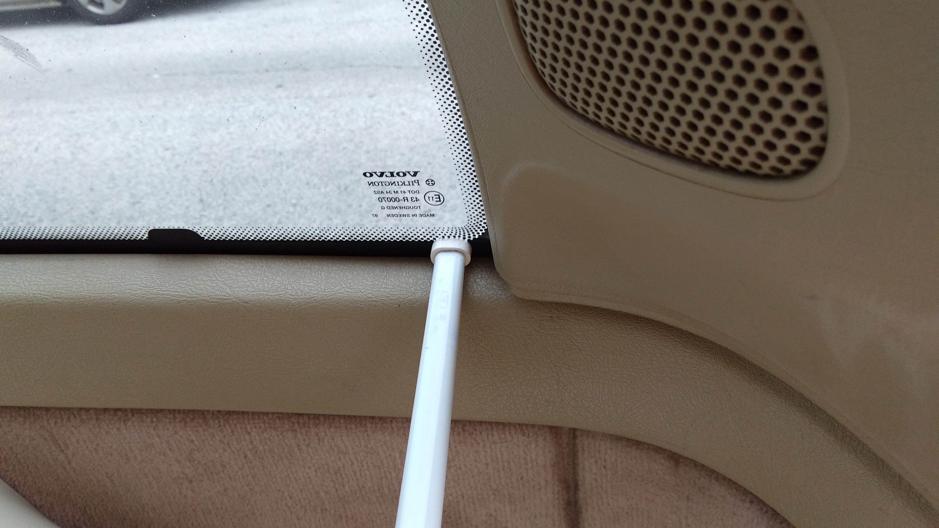

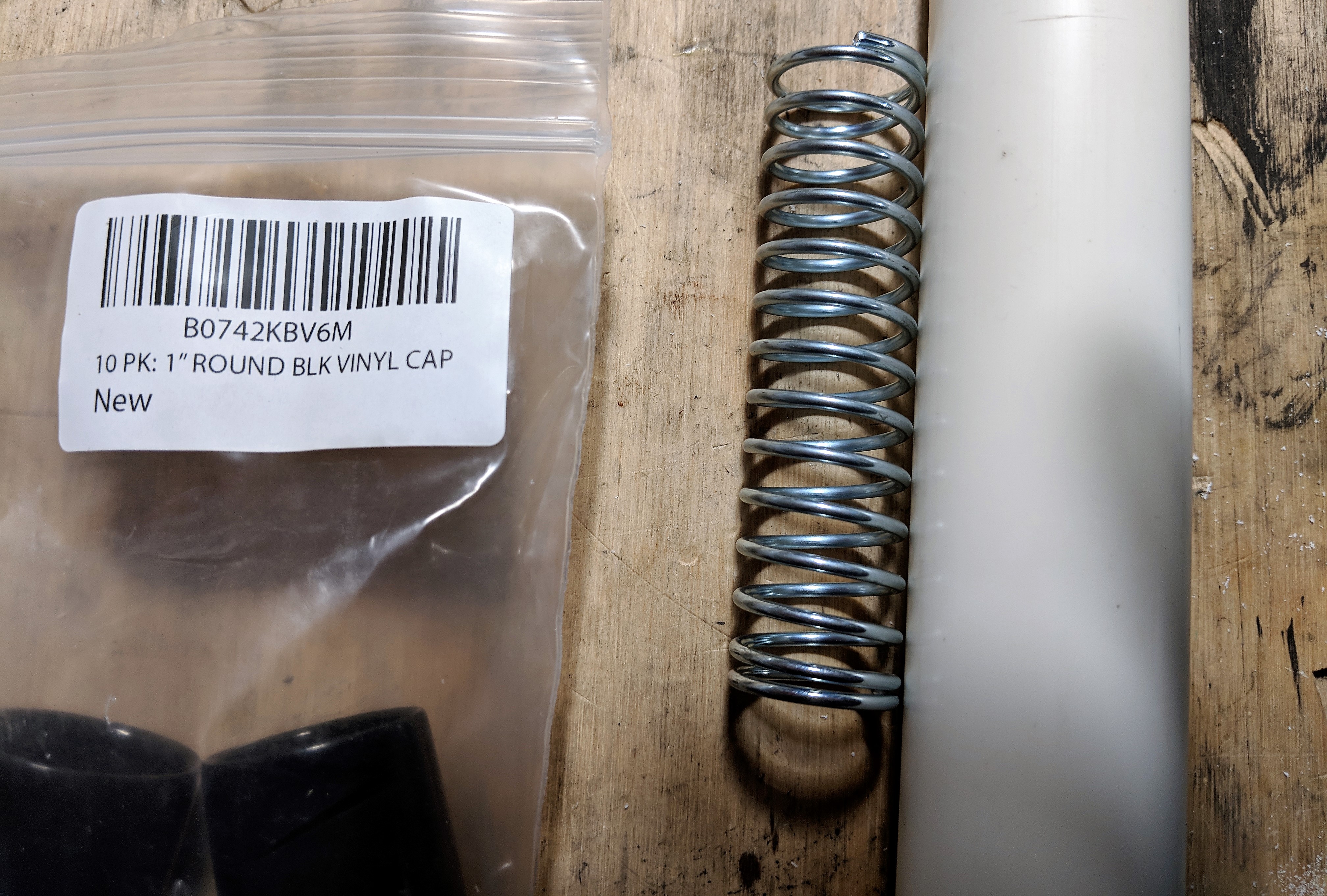

I did the same thing, but made the spring rods using 1 inch dowels, and 1 inch ID PVC. Used about a foot of PVC as a sleeve. Nailed and glued one dowel about a third of the way in, then added a spring and a second dowel.
To keep the second dowel from coming out, I drilled, dremeled and filed a slot in the PVC. Then some plastic caps on the end. My wife is sewing the cover, which, I'm reluctant to say, will be paisley. (It's her car but I have to be seen in it.)
