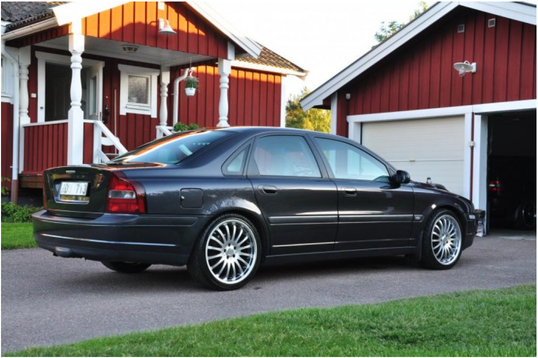

My previous S80 looked like below when I bought it, I think it was lowered by 30-40 mm. I tired quite quickly of the harsh ride and poor handling on uneven roads the combination of low profile 19" tyres and lowering springs gave and put back the originals and 15" wheels. Didn't look too bad though.
Just putting new shocks on the car will make quite an improvement if the old ones are worn. Stiffer sway bars and new shocks would be a good start I'd say. If not enough 17" wheels are an easy additional thing to try.
As for rubbing tyres you need to change the steering limits(name?) on the control arms to get rid of it. Or just adjust how you drive.
