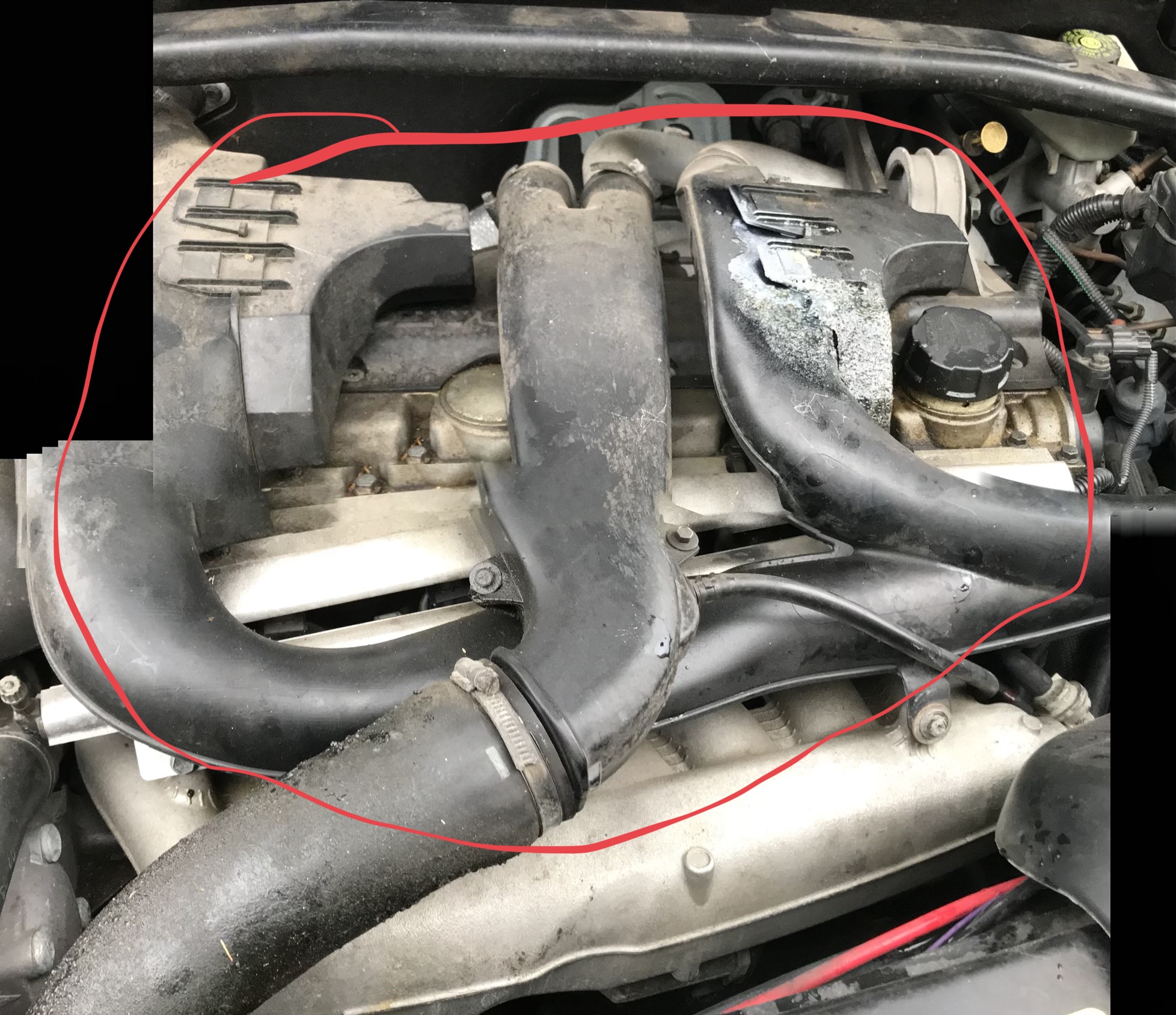

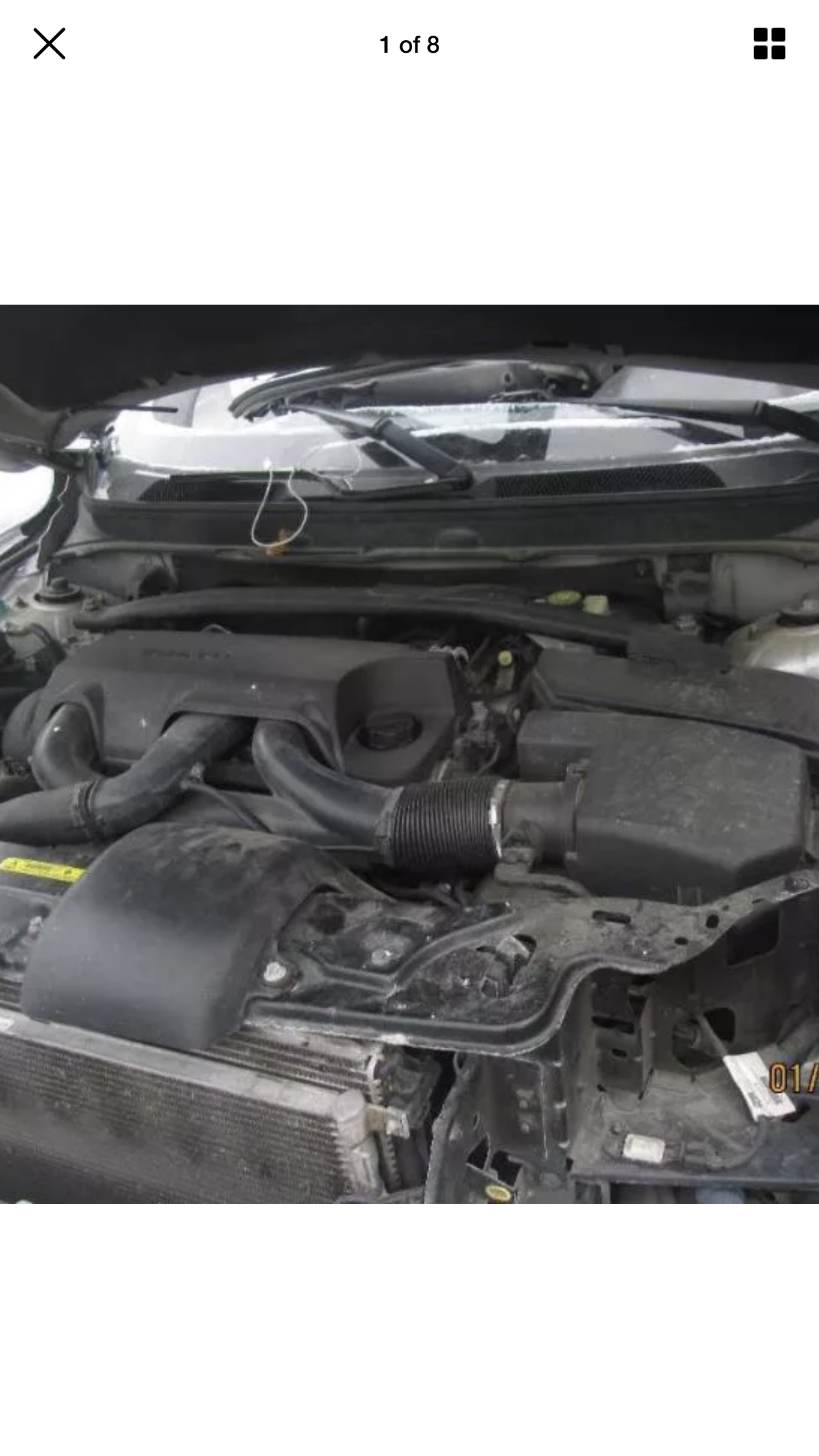

Please see pictures I am missing the top plastic piece that goes on top on engine what is this called and what is the black plastic piec on top that come off the part that leads to to air filter also come from left and merges together and there is a big rubber hose that attaches under this what is it the rudder hose is circled in the second picture

Search for "Volvo 30636959" or "Volvo 8683875", pick one of the pages from someone that sells this part and you'll see the rest of what you're looking for in the illustrated diagrams. Good luck !

Those plastic plenums are your charge air ducts from the intake to the turbos, and the turbos to the intercooler. Funny, my 04 doesn't have the cover, nor the provisions to mount it. It just holds more heat close to the engine, many say to junk the cover anyway.
