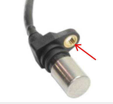

Metal ring the hold down bolt goes through might function as a chassis or 'earth ground' connected to the metal shield around the sensor to give it a directional pickup pattern. If this ground is lost the sensor would become more sensitive to spurious EM pulses such as that produced by the starter motor. I think that is what people were getting at by addressing the electrical continuity between the transmission case and the engine block. The break could be between the sensor shield and the metal ring (internal). This sensor does not get any sort of ground through the wiring harness... 2 wires: reference voltage and signal return only. Being a hall effect sensor it is potentially sensitive to EM. The million dollar question being what exactly is it picking up, and why, seeing as it is designed to normally reject this interference. Otherwise the tach would jump on all our cars.
Edit: there's another possibility. The ECU likely has filter of sorts that normally rejects spurious/low intensity EM from being counted as lobes passing the front of the sensor. You might check with xemodex to see if this is a potential failure point on ECUs they've ever encountered.

mrbrian200 wrote: 05 Jan 2018, 22:41 Another educated guess/theory:
I'm going to take a look at the sensor again and clean off the surfaces.
