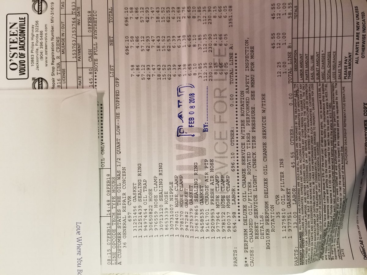

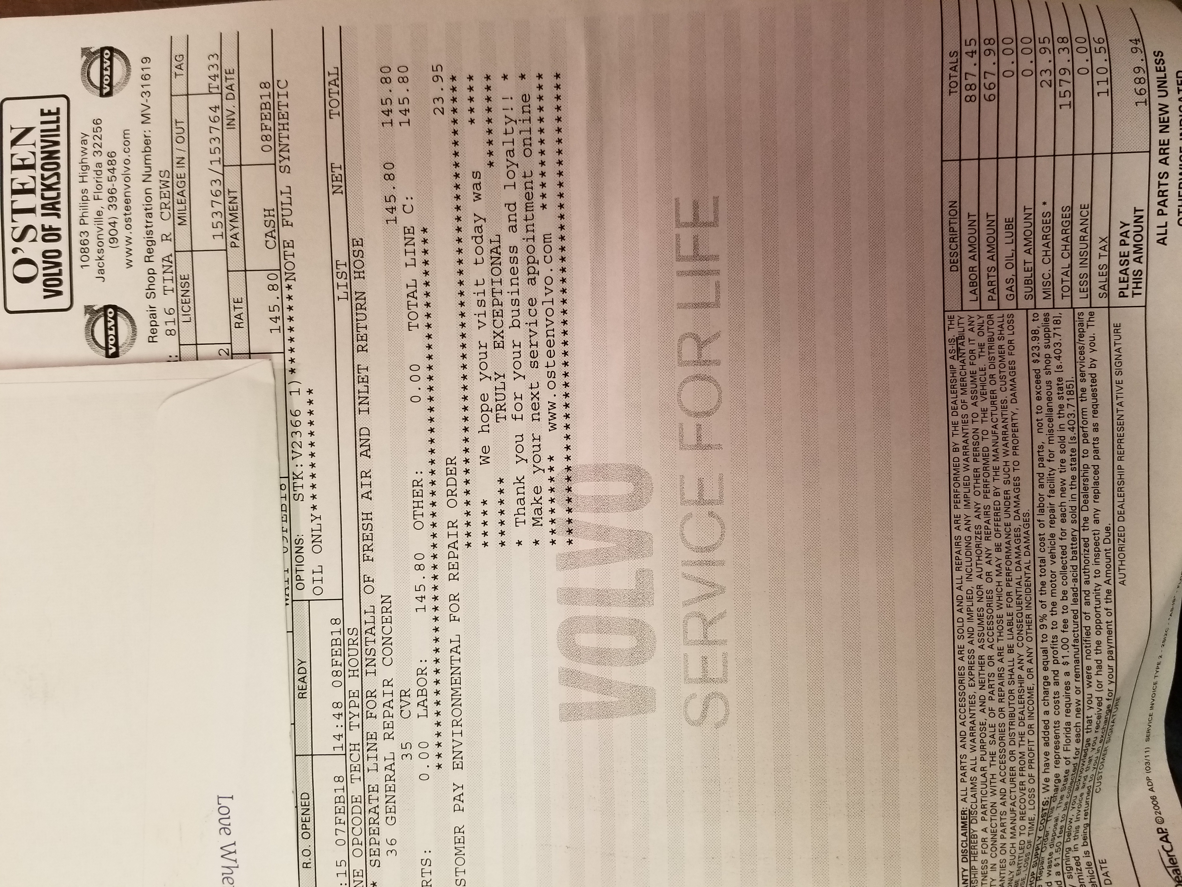

I understand your symptoms indicate a bad valve in the oil trap box portion of the PCV system. I just had my 2004 S80 PCV serviced at my Volvo dealer $1,600.00. $150.00 of that was a turbo pressure pipe. The PCV system was about 6 hours labor plus parts. Though my car is a 6 cylinder I believe replacing the box is basically the same. Attached is the repair ticket. June
