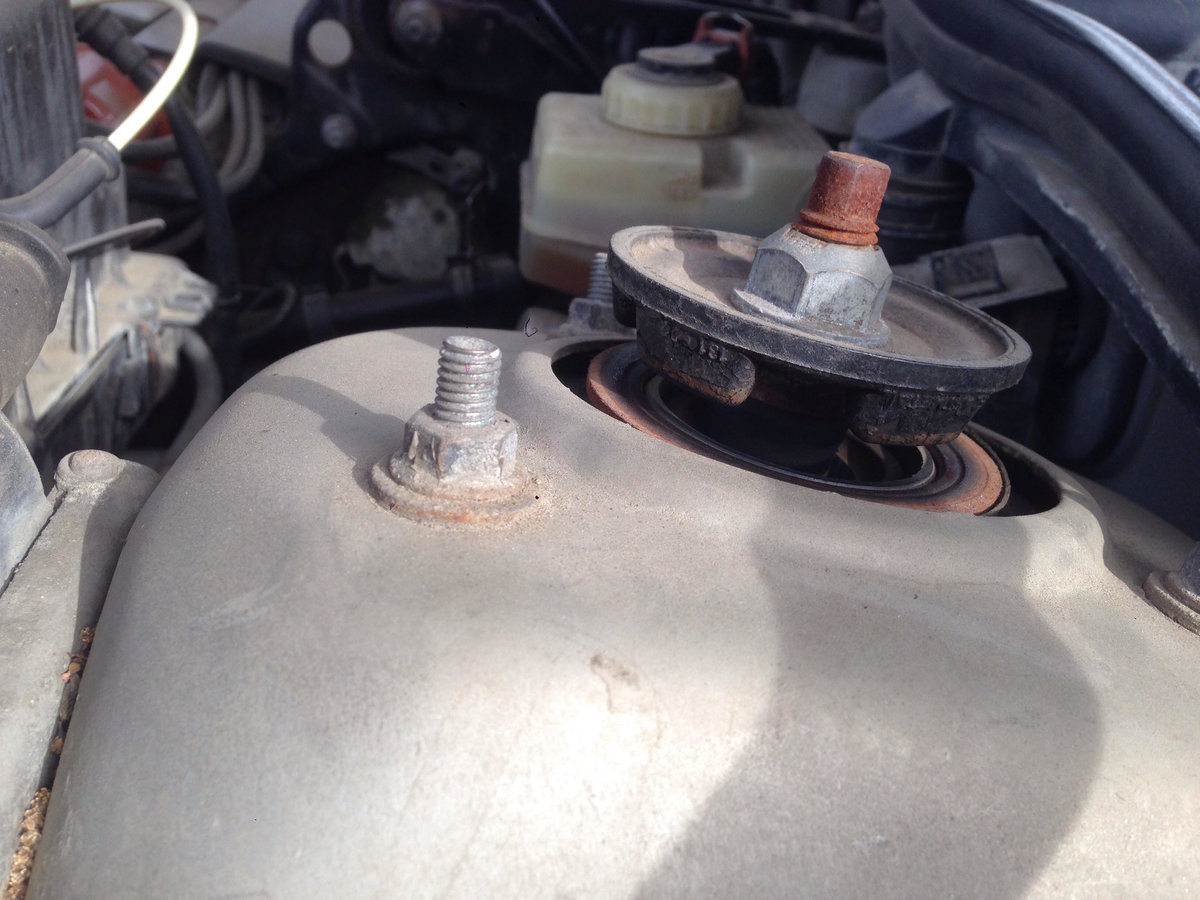

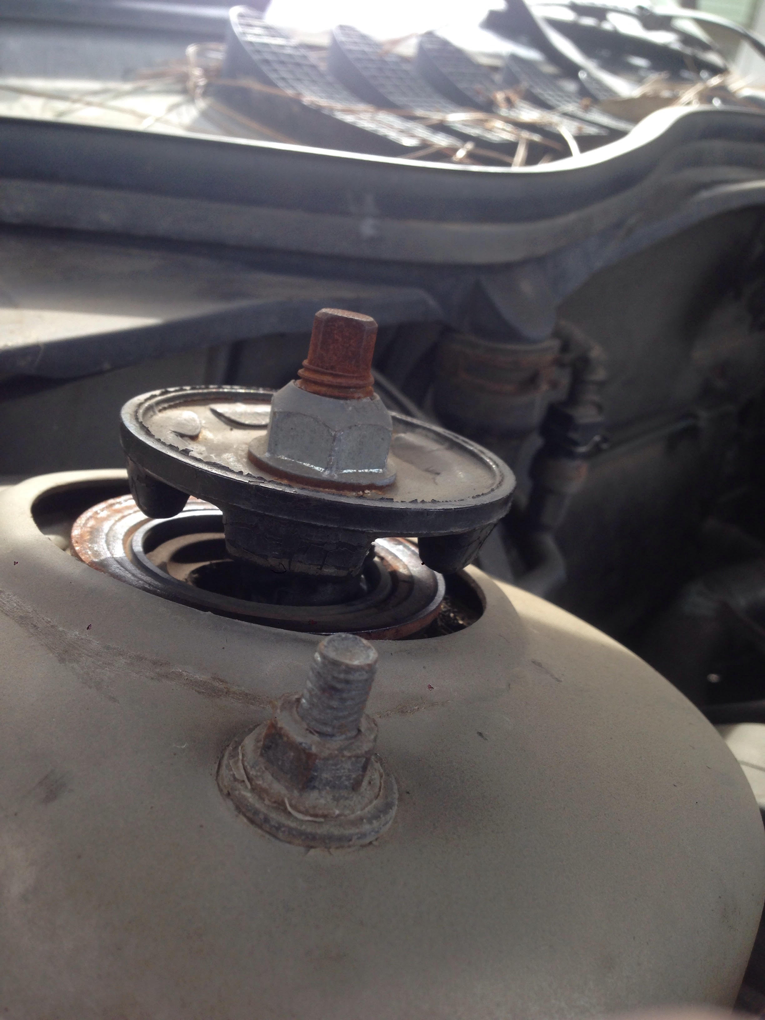

I've been reading some other articles that suggest it has to do with the struts? I know my struts are shot, but would that be the case?
I've attached pictures of my struts
Other strut
Other strut
Strut from engine compartment

The spring seat of strut is most likely torn. This causes a hollow clunking.

As above, the spring seat in the first picture is broken. Second one will soon follow. Only Sachs brand from Fcp, Ipd, etc

Be warned, the condition of your top shock mounts can allow the strut to eventually punch through and damage the hood in the condition you show. I would not personally drive a car in that condition. If the CV boots have long failed they are probably past saving which is a shame as Volvo OE drive axles are nearly indestructible as long as dirt does not get into them. Replacements of aftermarket stuff is a crap shoot.

If there was slight cracking in the top mounts it would probably be safe to run. But based on your pictures I would not recommend it mostly on the safety side of things if it were to fail it could easily become dangerous.
If there are any good parts yards around maybe you can find a decent set of front struts. Still check the top strut mounts as they can be hard to see without removing the top washer. you are looking for cracking around the center bonded in metal sleeve that fits around the strut shaft.
