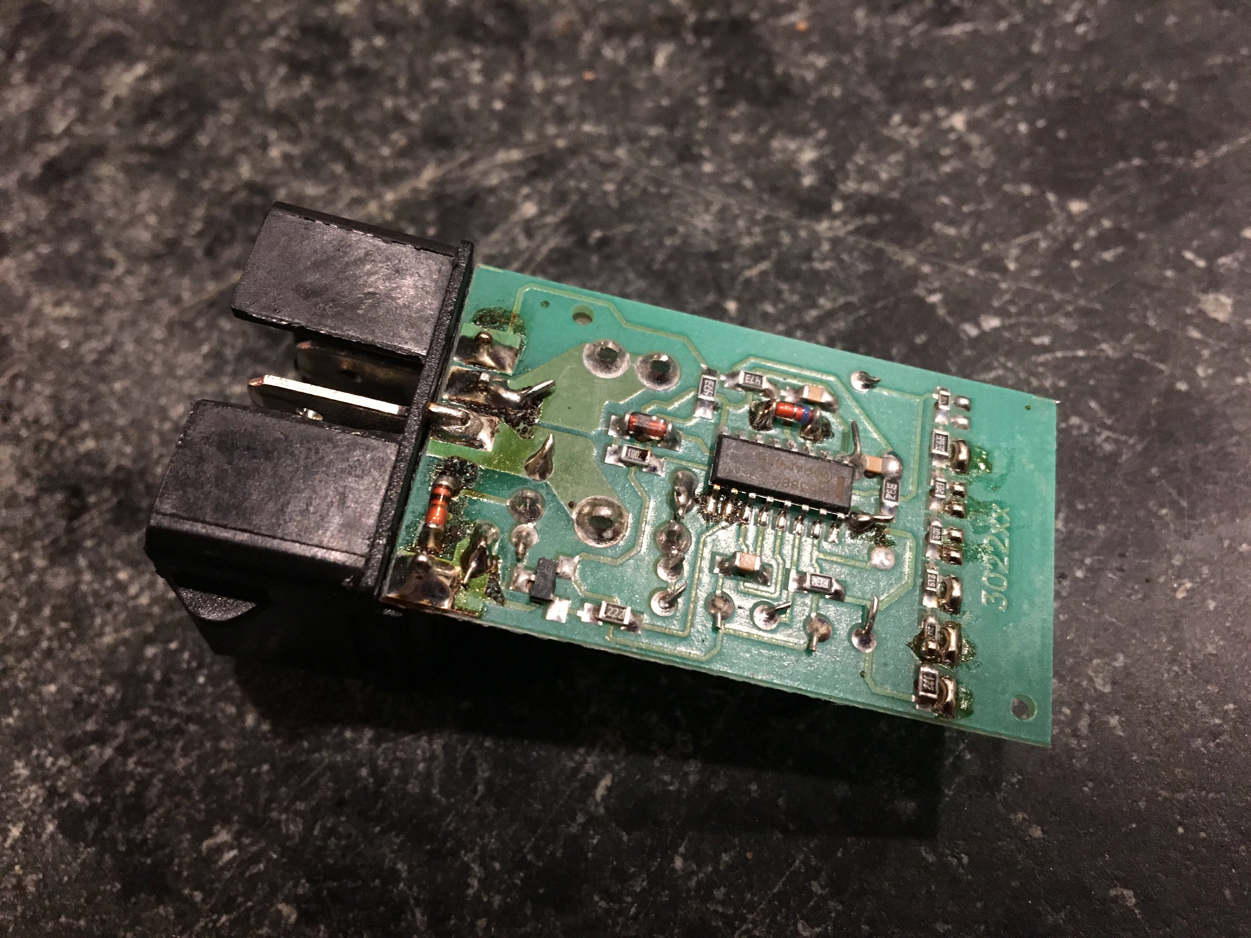

Just thought I'd post this on here rather than leaving a review on FCP or elsewhere. First off, I didn't buy this relay new. I got it from a car at the junkyard, and it looked (and still looks) brand new.
I ran this relay for probably a year, maybe 5k miles. This is what it looks like now. You can see where it burned out. Fortunately this failed in the driveway when the car wouldn't start one morning, and I carry a spare in the glovebox. I highly recommend keeping a spare in your car, this can save you a lot of time and aggravation worrying about a tow. Failures aren't uncommon. Just make sure you have a T25 bit or screwdriver in your car to remove the cover.
Anyway, the lesson here is buy genuine. I'm once again running my 20 year old, 183k-mile relay with no problems. And yes, I have a new (used but tested) spare.

I'm still on my original at 200k. I did take it out and dremelled the terminals which were showing signs of thermal damage. I wonder if that helps extend life? Has anyone done root failure analysis on a dead one?

This is the best thread on fuel pump relay failure causes that I know of: viewtopic.php?f=1&t=9681
Main causes (not necessarily in order):
Cracked solder joint between pin and board
Electrolytic capacitor failure
Diode burn out
Diode burn out

jreed wrote: 15 Feb 2018, 05:07 This is the best thread on fuel pump relay failure causes that I know of: viewtopic.php?f=1&t=9681
Diode burn out
That's excellent. Added the part number to that thread for search, 9434225
Covers relays from 1993-2000!
