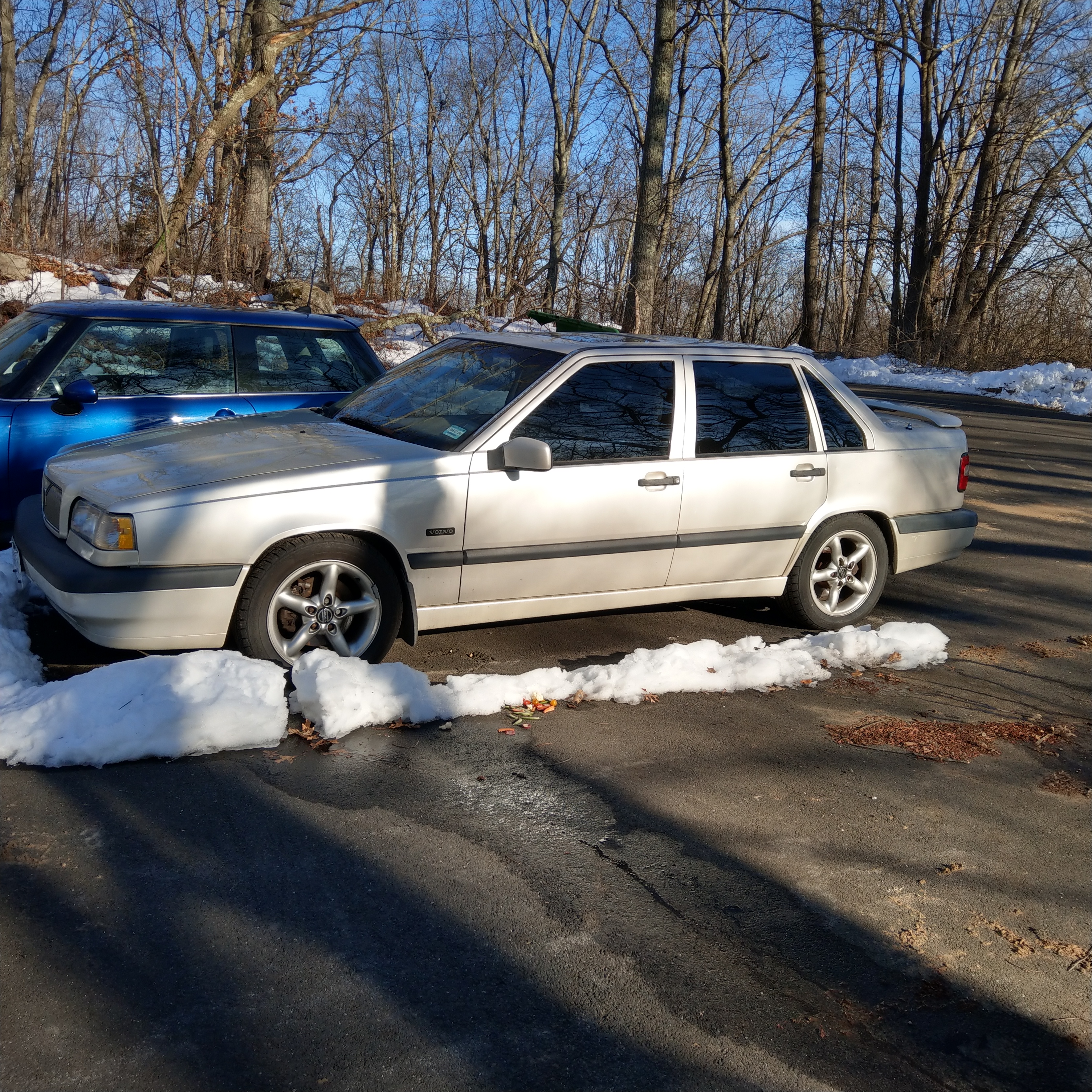

Can you tell a Platinum by the VIN? The car I just bought is a opalescent white 1996 850 Turbo, Rear spoiler, 2.3L turbo, every conceivable option there is including premium sound and power antenna. Both seats are power, trip comp, fogs, sunroof, Persus wheels [or as close as I can figure from online pics]. Thanks
