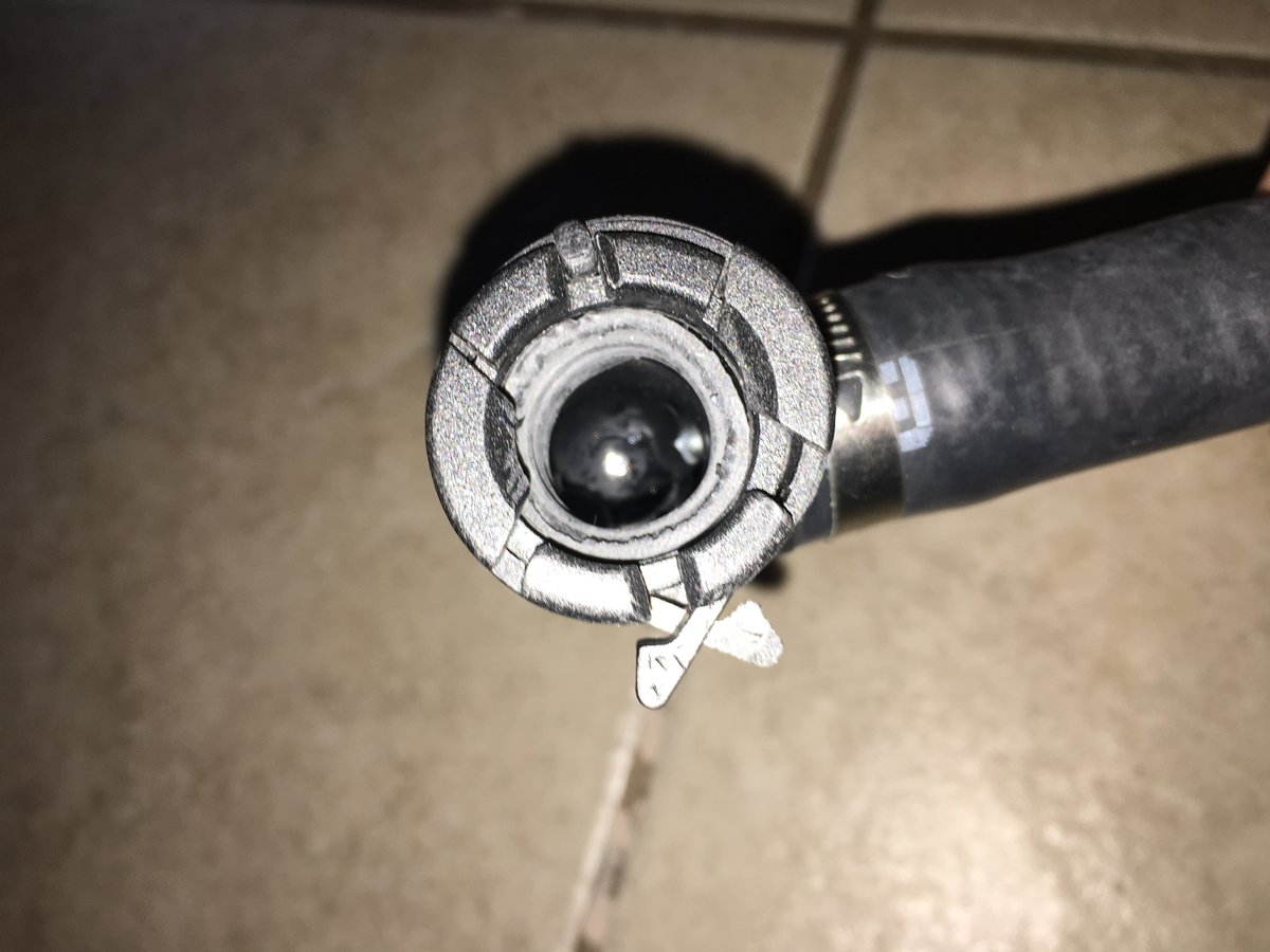

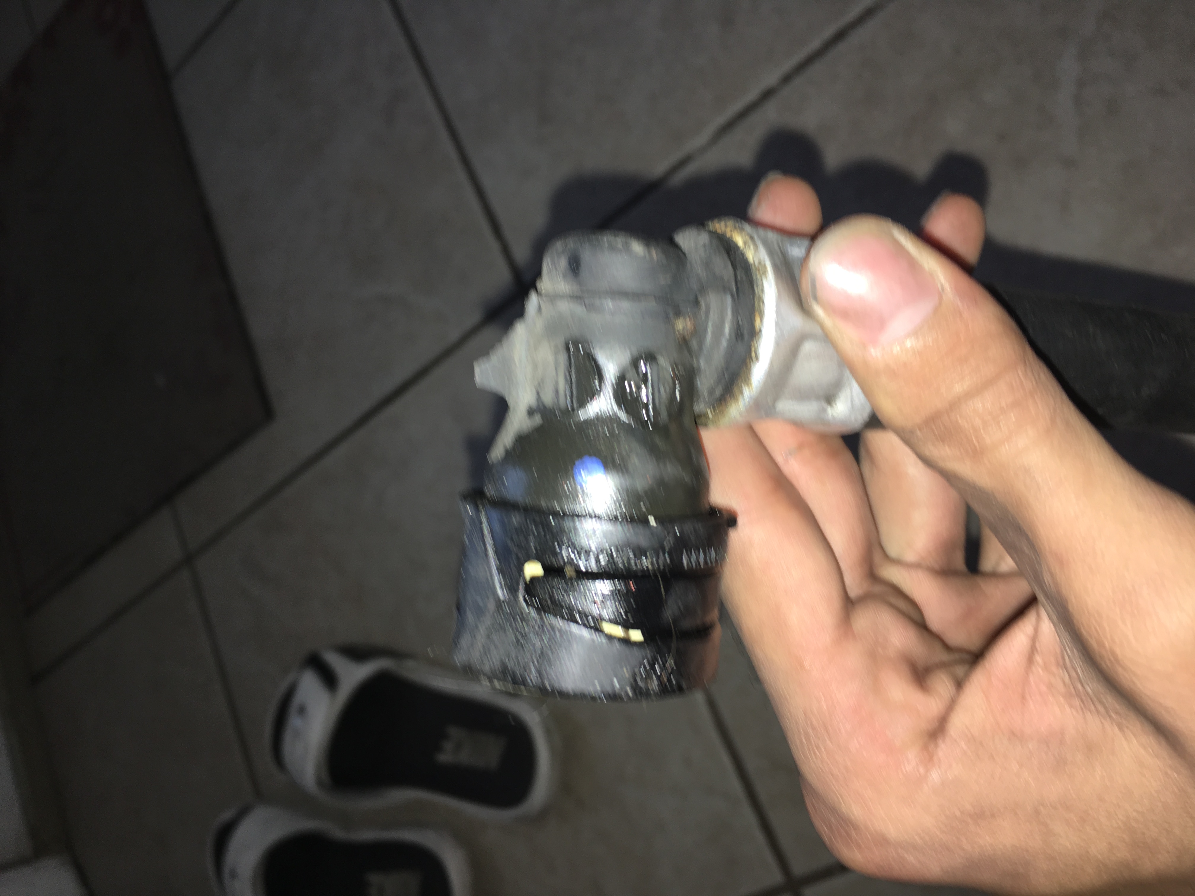

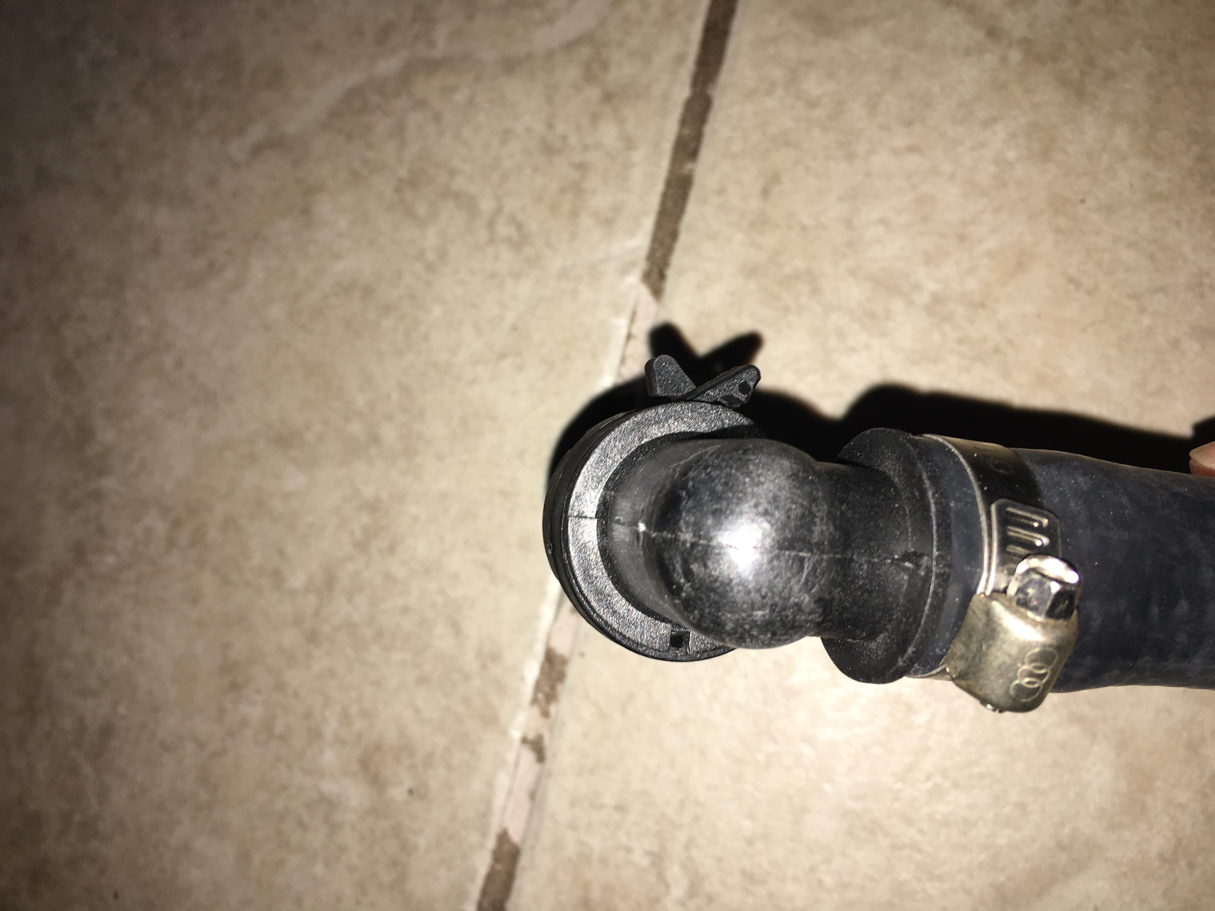

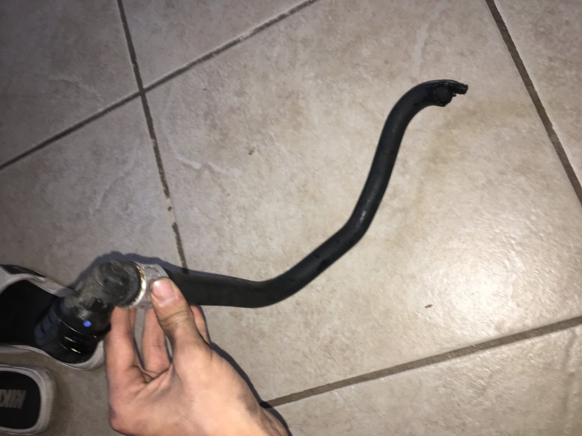

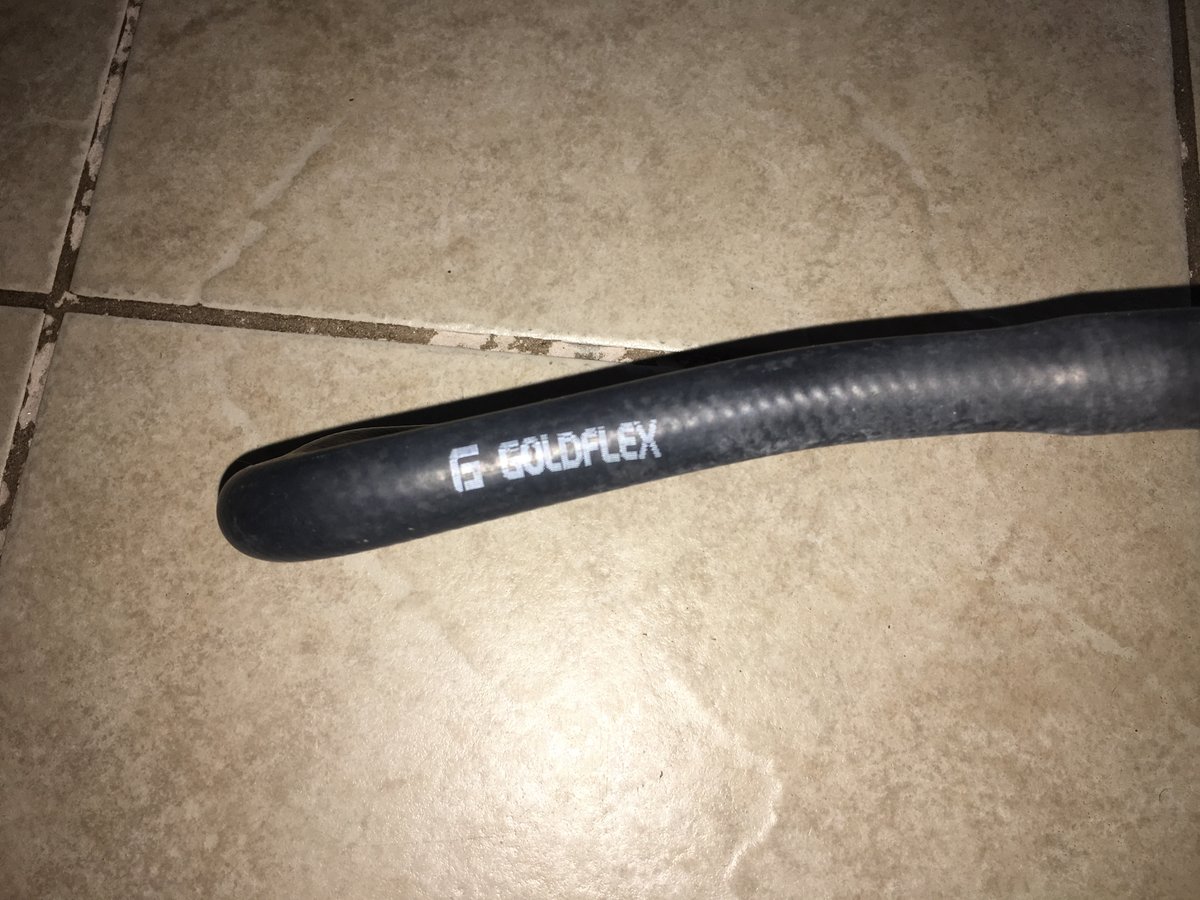

UPDATE: I replaced the hose, but I'm worried because it's not an exact fit. Should've went with the one straight from volvo. It appears that the nozzle that connects to the heater core isn't as long as it should be so the new hose doesn't go all the way back like it should. But I test drove the car, made some small pulls, and so far no leaks and no hose bursting. Here's a picture of the old one for reference.I'll be keeping an eye on it but I want to replace it with the correct one soon.

Copy that. We won't tell you you overpaid.
The Volvo hoses will run out about $60 each
30745332
30745332
