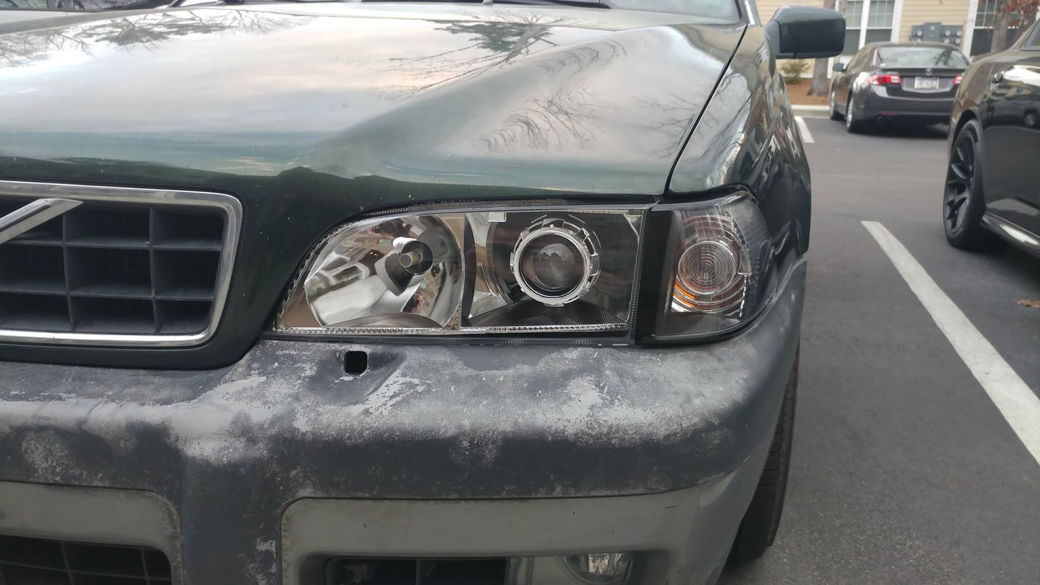

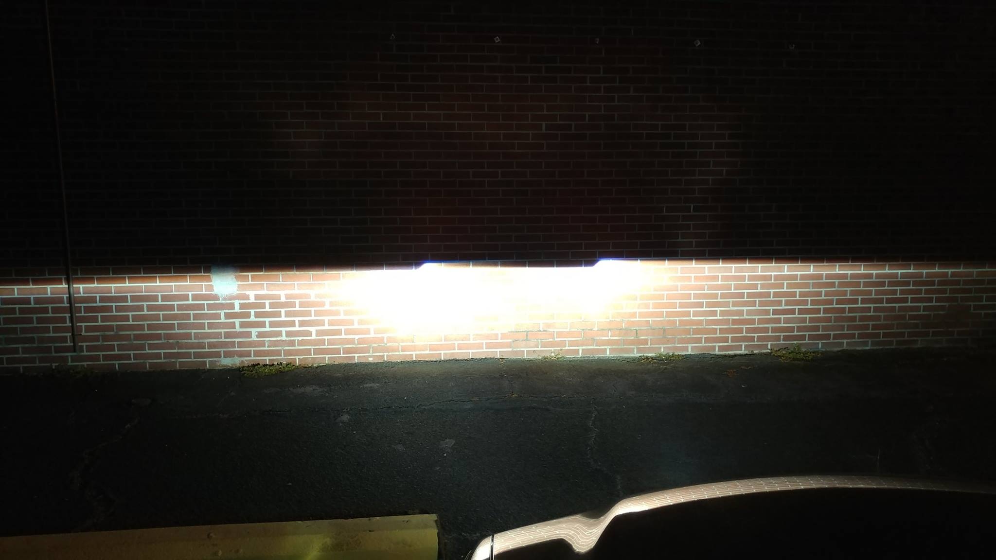

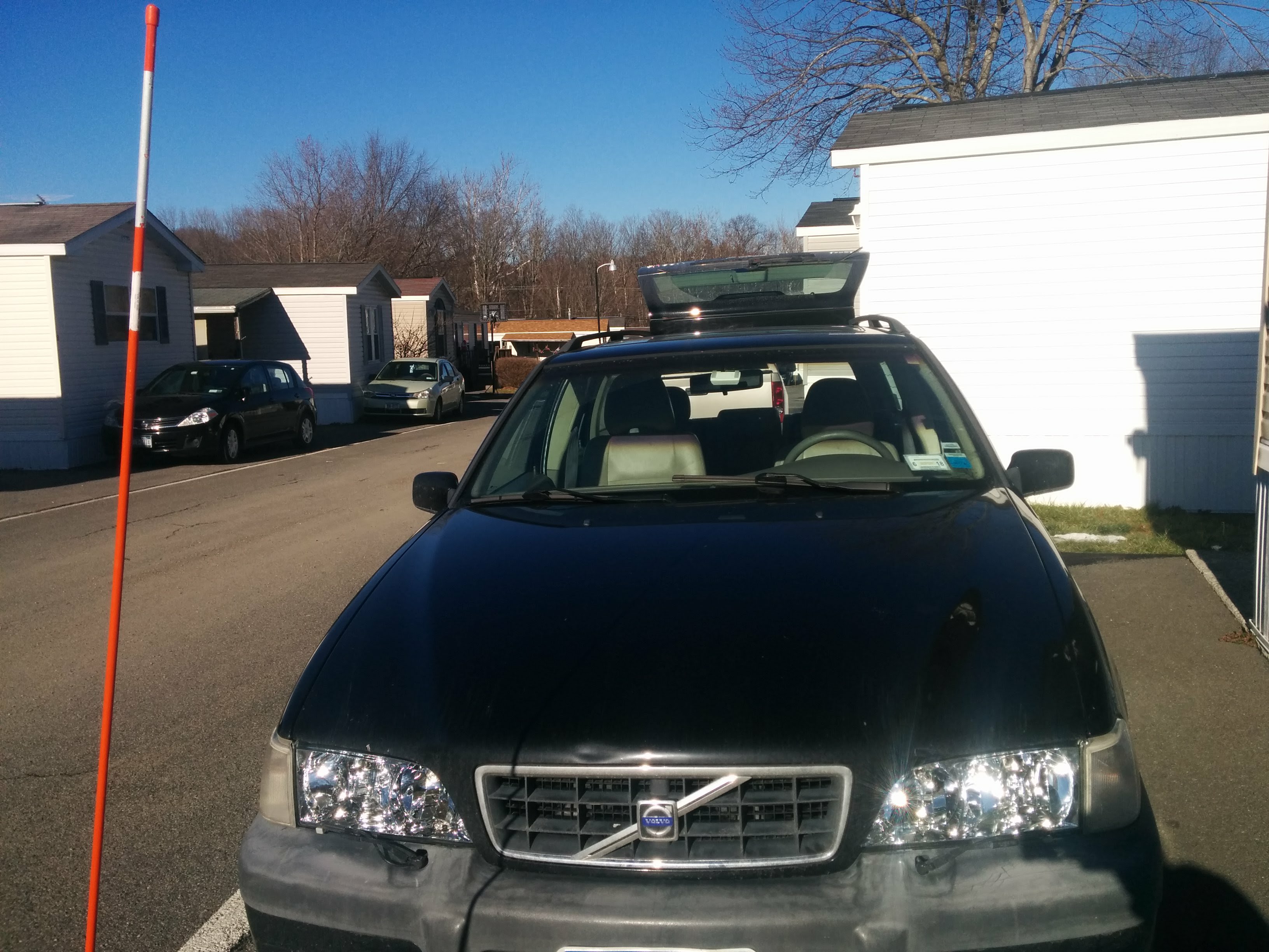

If you want better lights, look into doing an HID projector retrofit with clear glass. The difference is incredible. Putting any HID or LED into stock halogen housings, especially with fluted lenses will shoot light everywhere. Not safe for other drivers at all. The exception to this is I do use bright LEDs in the high beams, which I only use when needed and traffic isn't a factor.
If you use 35w or 55w HIDs, you don't need a decoder or bulb-out warning eliminator. I've had 35/55w HIDs plugged into stock wiring for better part of 10 years now with no issues.
Some pics of my setup. (The poor bumper has since been painted!)
