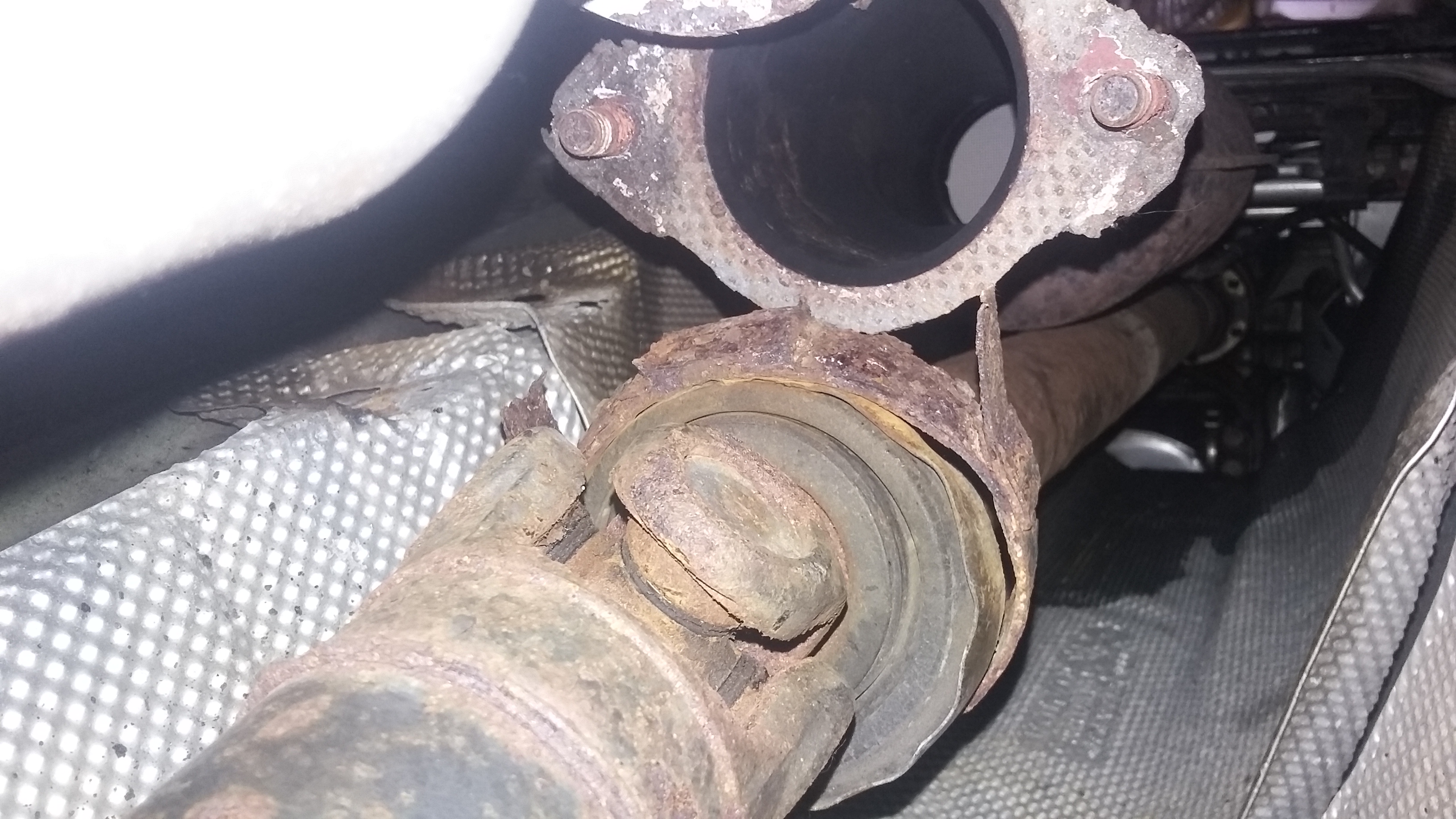

Update. Center bearing is completely rusted away. It's rotted right off the bracket. NYS salt! Grrrr
I got all the bolts out and the Axle has been soaking in PB Blaster. For 2 days tapped all around it Heated it , So far its not budging. This morning im going to try my acetylene torch maybe more heat will do the trick.
