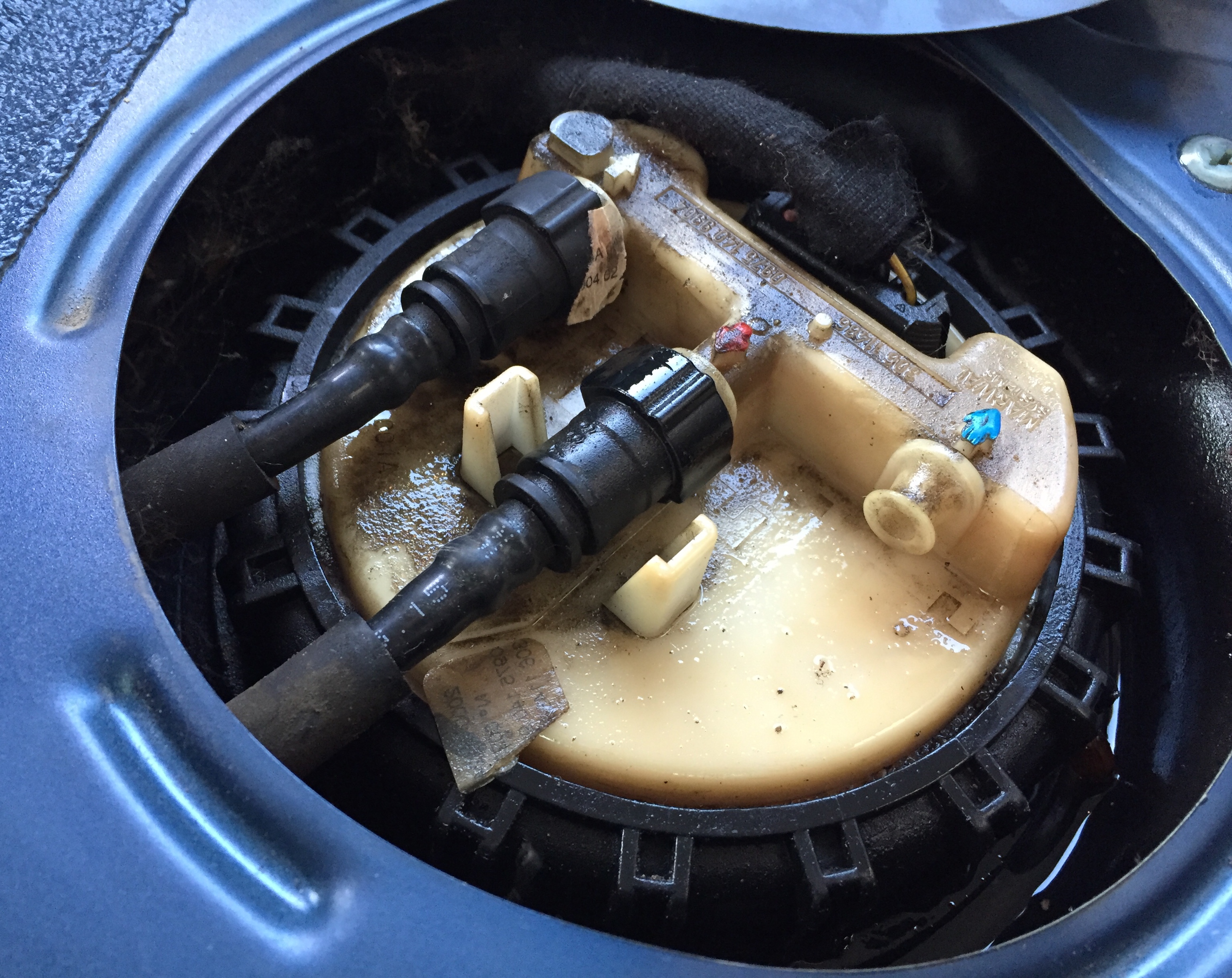

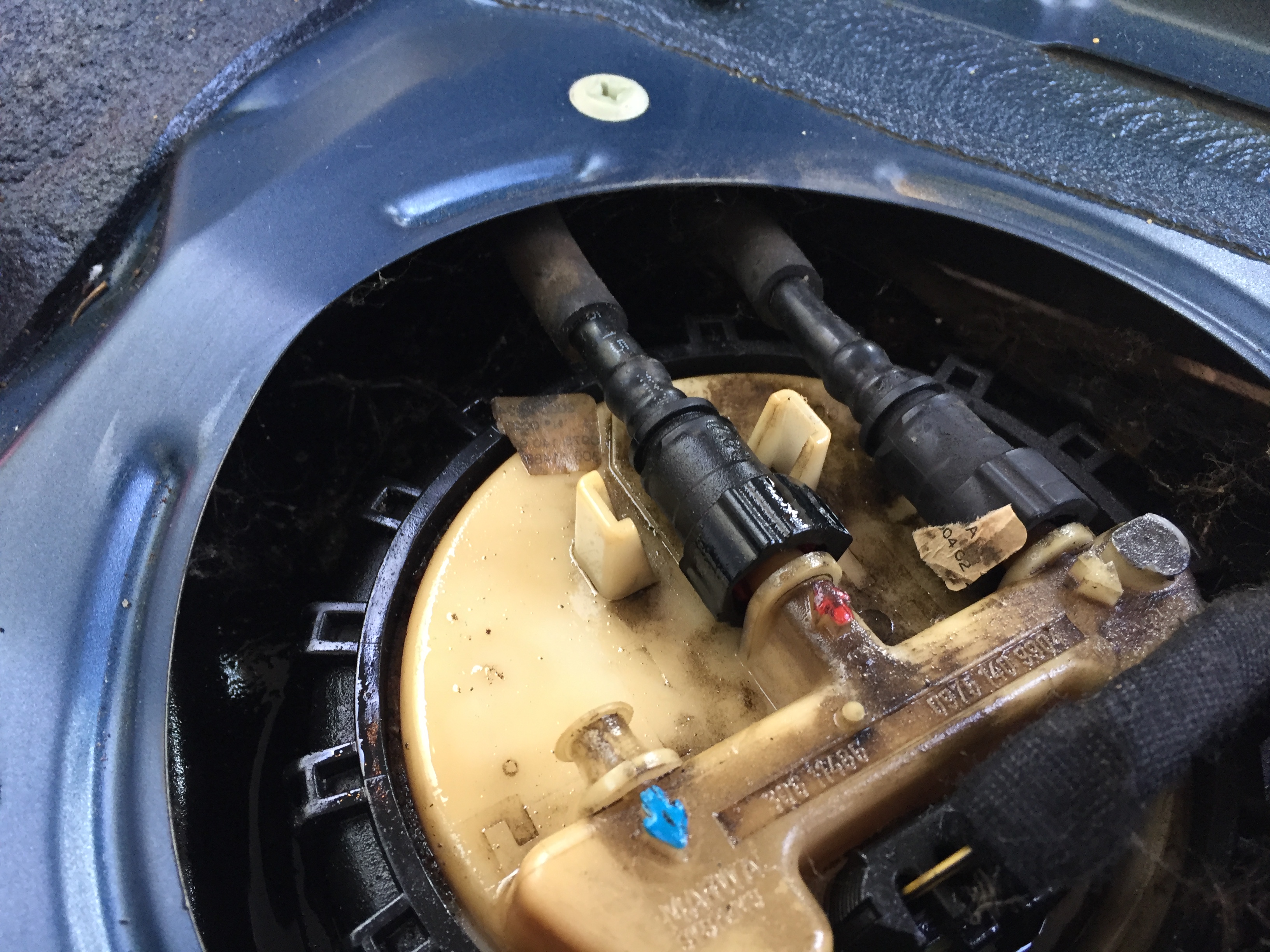

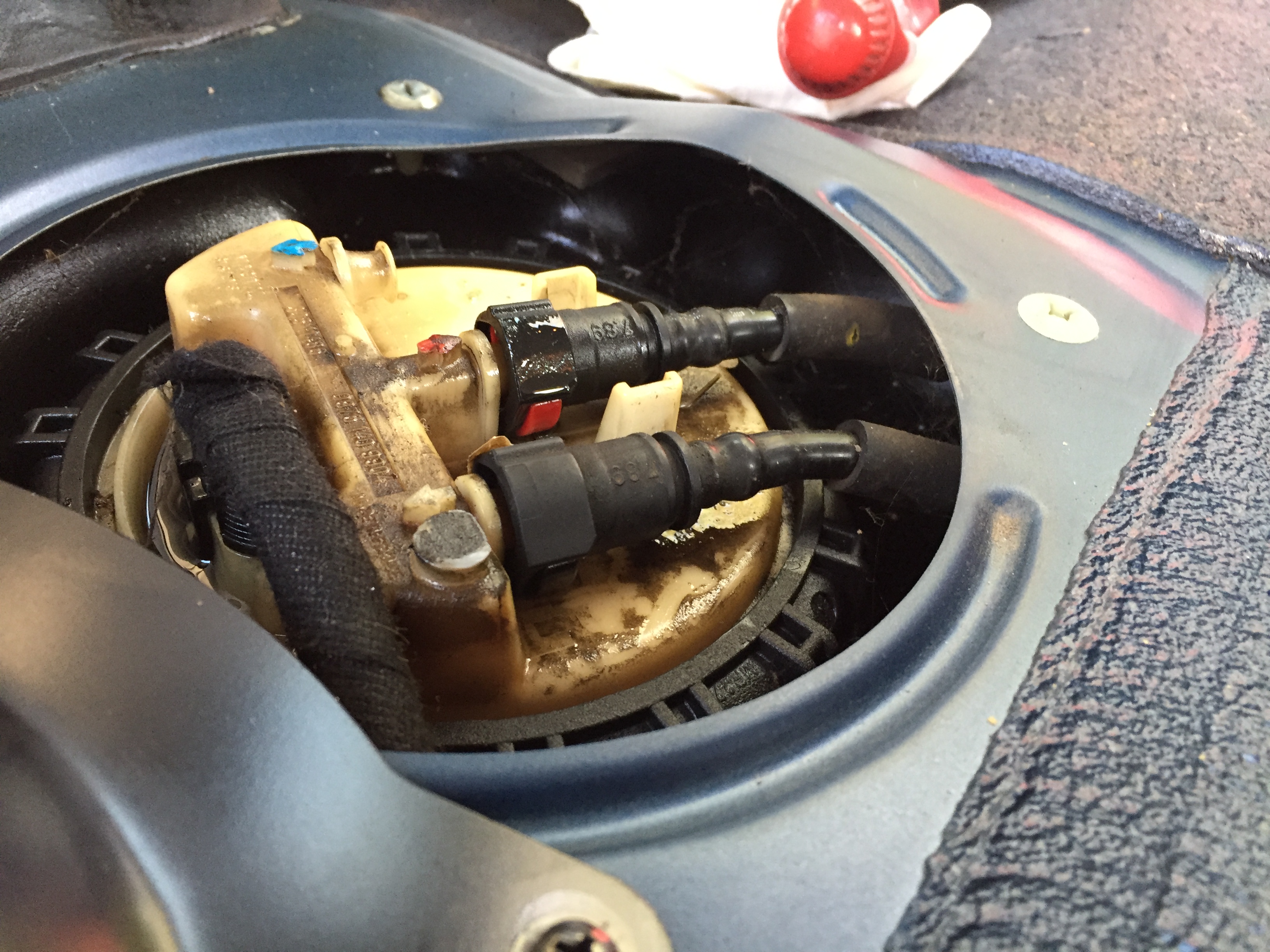

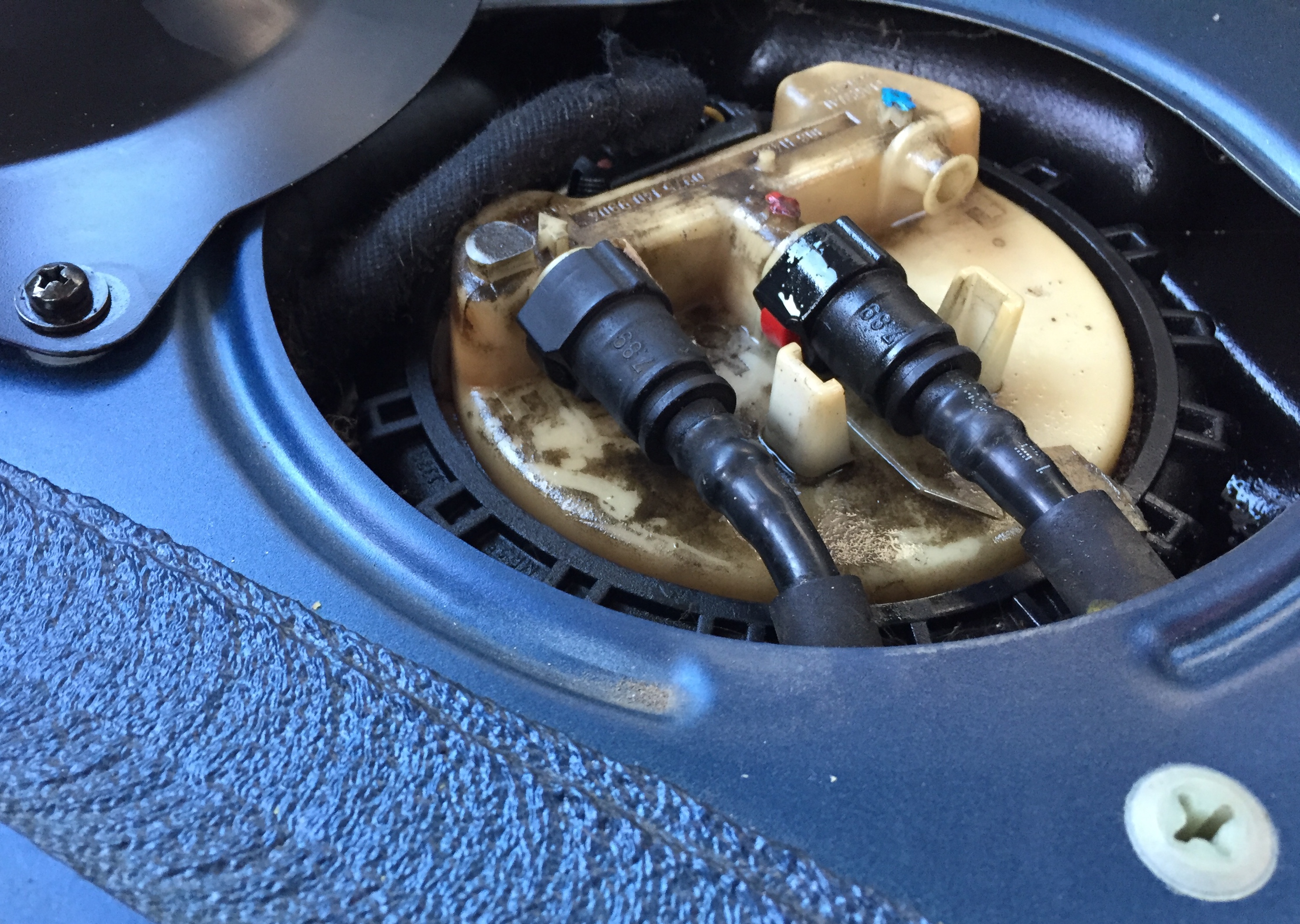

I have a 2000 V40 which has leaking fittings at the fuel tank / pump. It appears the fittings are not sealing, and the fuel is coming out the end. They do not appear to be cracked.
1. What are these fittings called?
2. Is this a standard fitting, or unique to Volvo?
3. I understand some use o-rings. Do these use o-rings, and if so what size?
4. Is there a source for replacement fittings or o-rings?
I see that Volvo parts 30620511 and 30620510 (shown in "Fuel tank and connecting parts", both called "fuel pipe") are available, but are cost prohibitive.
Thanks
Fuel line fittings at tank / fuel pump

Curious if that is an aftermarket pump in the photos above since it doesn't look like the one in the factory part diagram.
Asking because I've had poor luck with aftermarket fuel pumps on my S40. Leaks and failures.
I ended up going with a factory pump. More money, but it's been much more reliable.

I don't recall. We originally bought the car in 2002 used from the dealer. It's possible one of the mechanics we had work on it replaced it. I just don't' remember.
