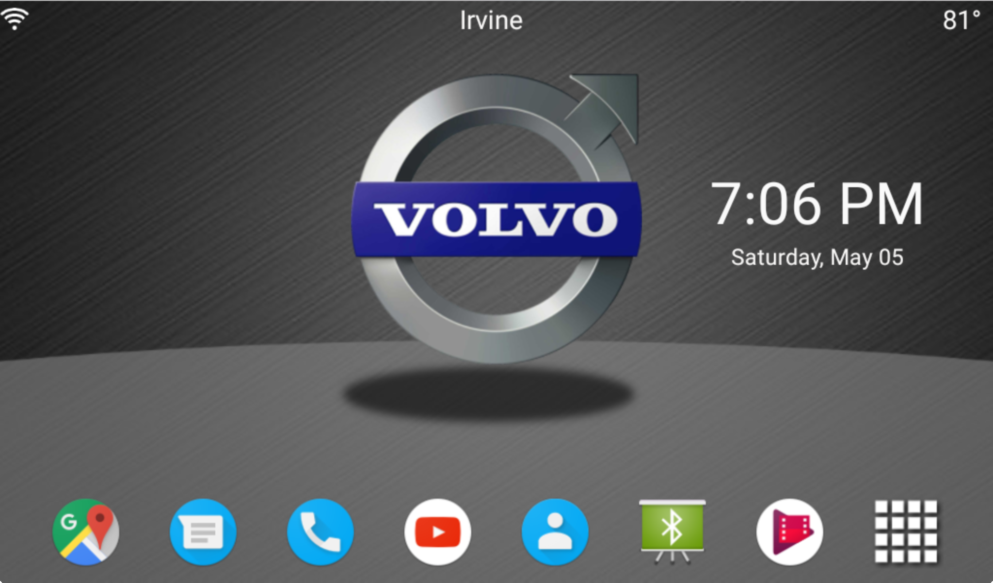

My biggest gripe with the Android head units is the user experience, it feels so tablet like. There are a handful of Android launchers available on the Play Store that provide a more automotive experience. I tried a few and could not find the right balance between Android and automotive experience. So I spent the last few evening creating one.
I wrote a blog post regarding it, if you’re interested in reading it: http://blog.petrocik.net/?p=62

For those that didn't read the blog post here is the custom launcher I've been working on. It's available for download on the blog post.
Android Head Unit And Custom Launcher
