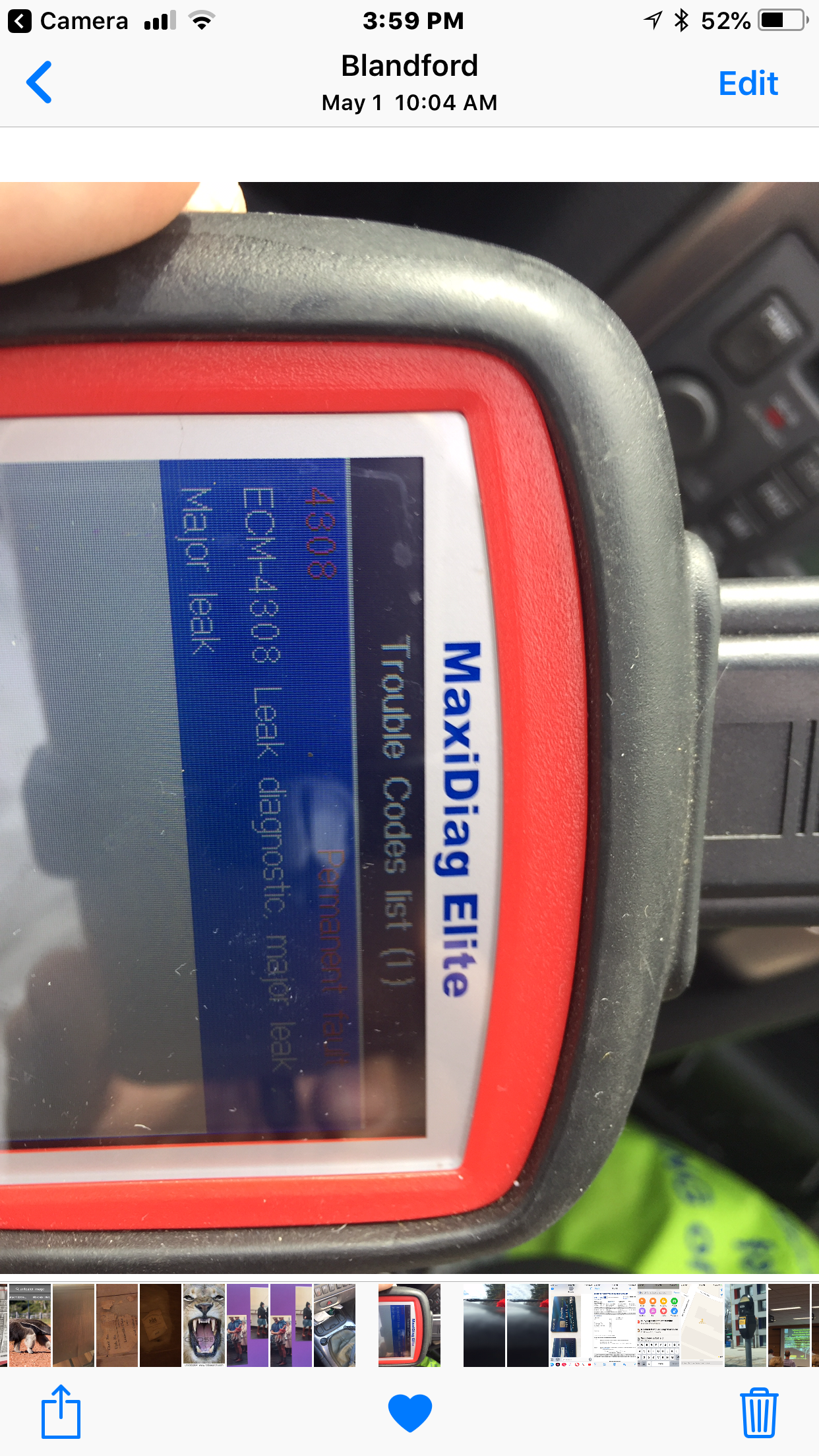

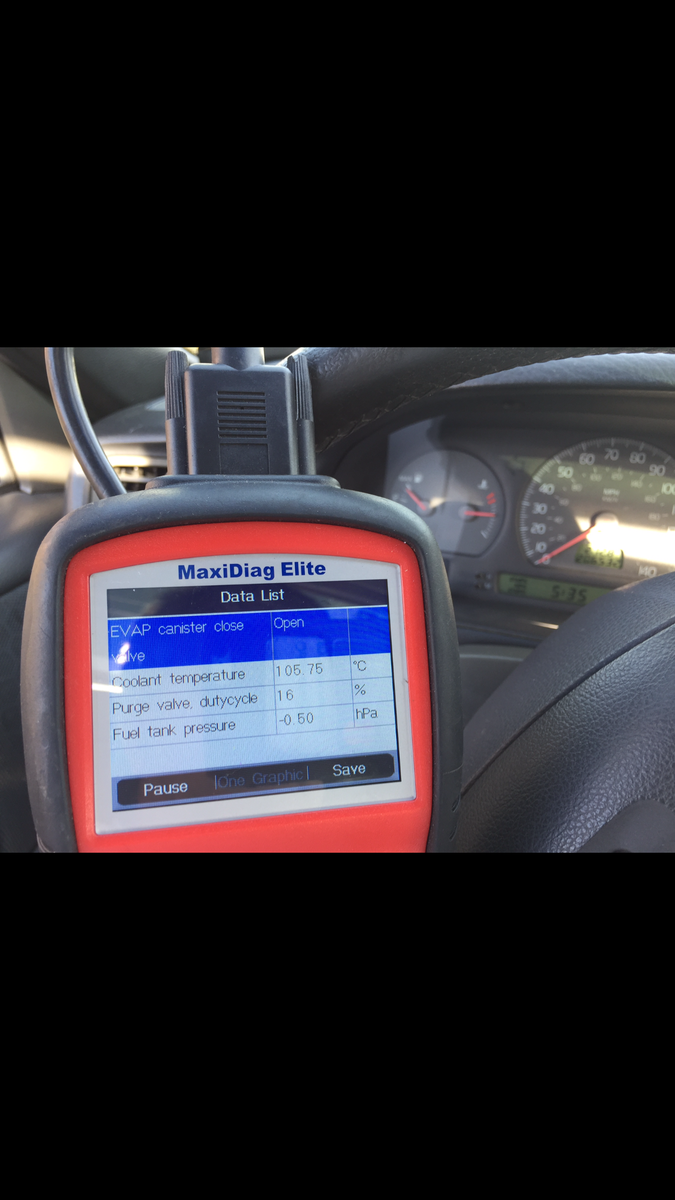

You can snipe one of these off eBay for $100 if you are patient.
This will show stuff like
