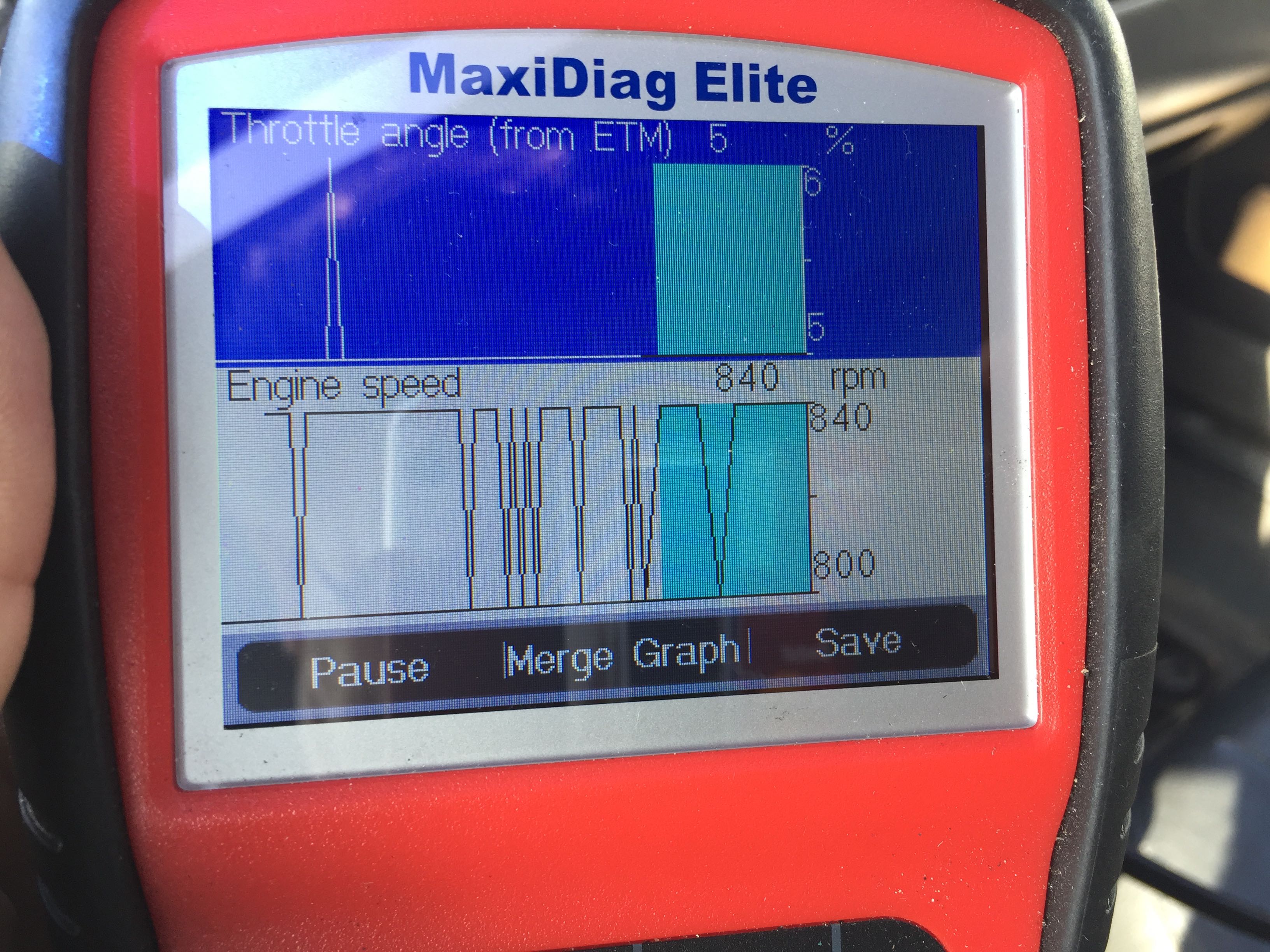

Does anyone know what values (range) the throttle valve gives at idle?
Mine is fluctuating inbetween 0,5 - 1,5 %. You can slightly hear this fluctuating at idle. Just wondering if this is normal or part of the problem....

My T5 throttle sits at about 8-9% when started, after warmup 5-6%
There is little fluctuation, small movements over seconds. Ill post a picture of the time trace here
