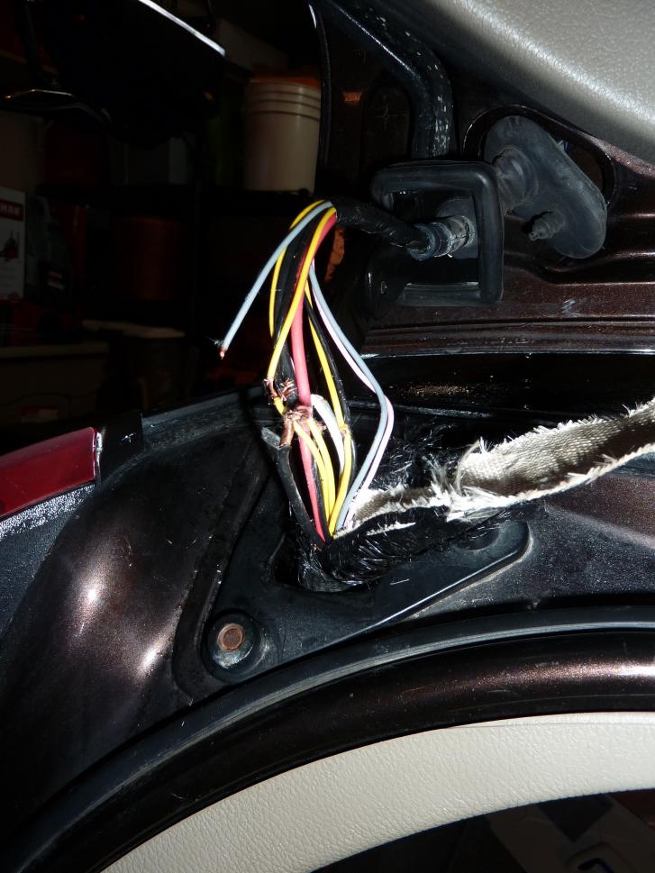

One other problem I had with the rear tailgate was the wiring in the upper left hinge area, there were about a half dozen wires that were broken and causing numerous problems. One problem from the broken wires was the tailgate lock wouldn't lock/unlock. You might want to check the tailgate wires in the left hinge area. They tend to break from flexing back and forth with the tailgate opening and closing.
