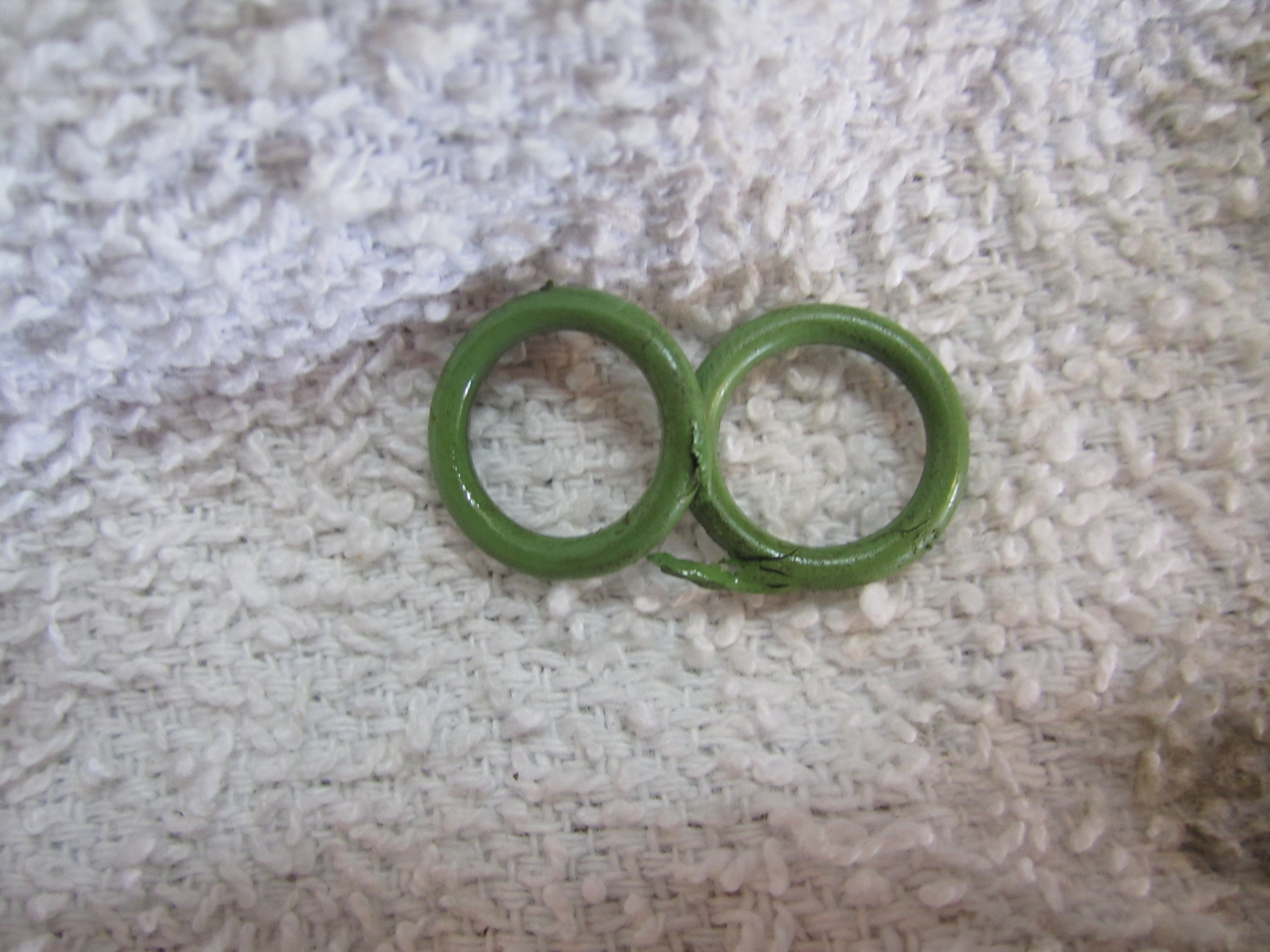

Damage to oil cooler lower o-rings

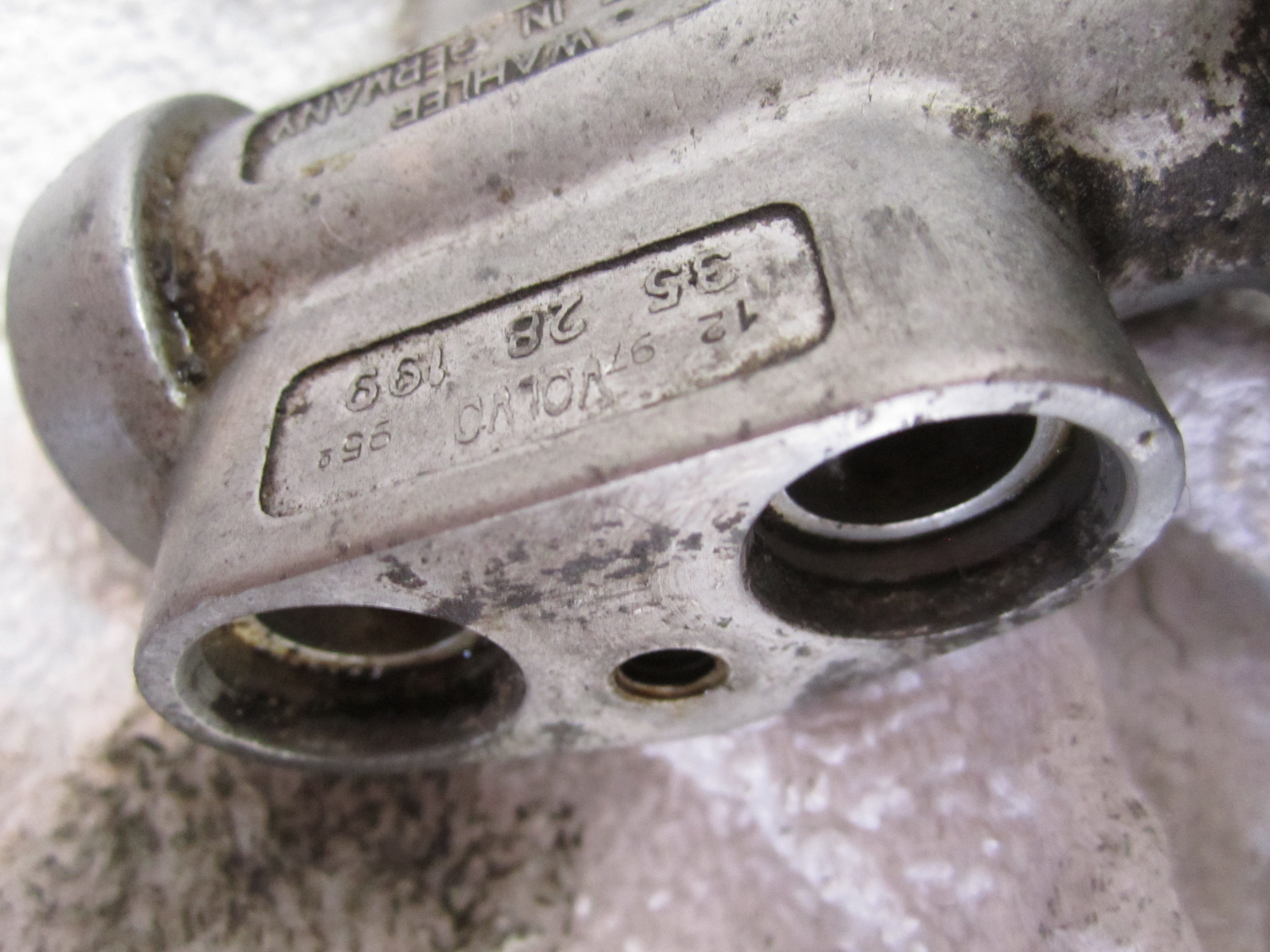

Thermostat removed for inspection

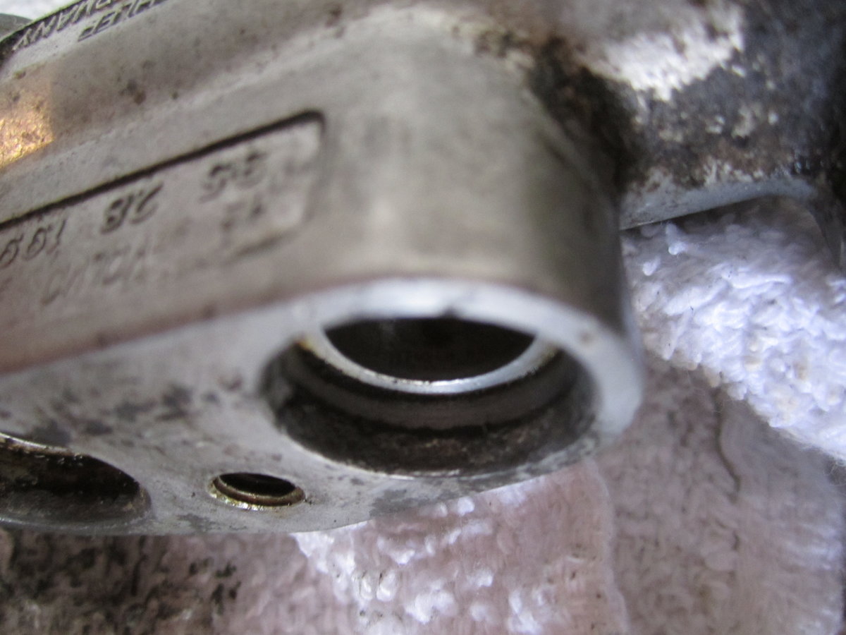

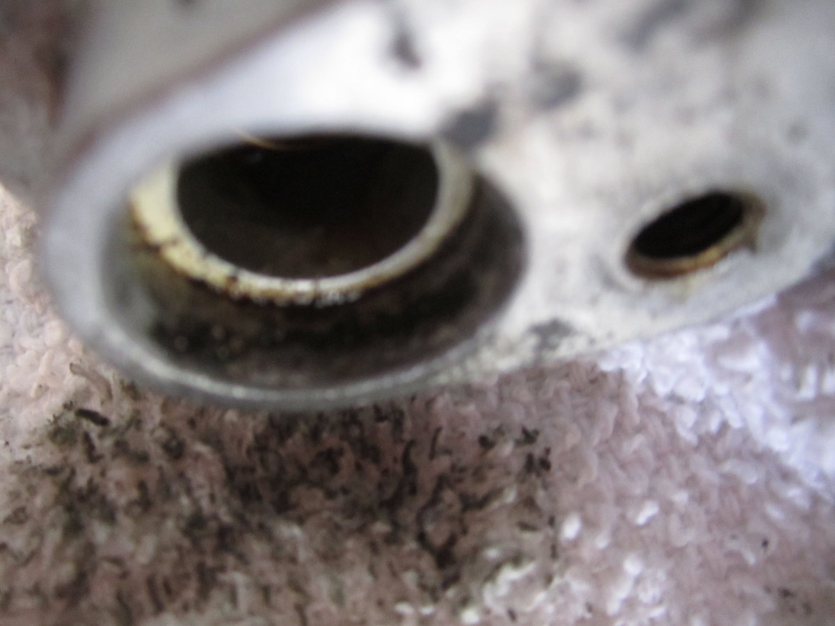

Burnt on oil residue
If you look carefully at the lower inner part of the oil line opening you can see (sorry for picture clarity) a black rough patch where the old oil had burned and baked. This had a rough surface so shoving new seals over this resulted in the condition of the 'O' rings in the first picture. This was after the 2nd set had been fitted at the dealer with the same result.
Burnt on oil residue (2)
This was all caused originally by the lower pipes being able to move outward due to the locating plate having warped outward on the ends and allowing oil to get passed the old hardened seals.
