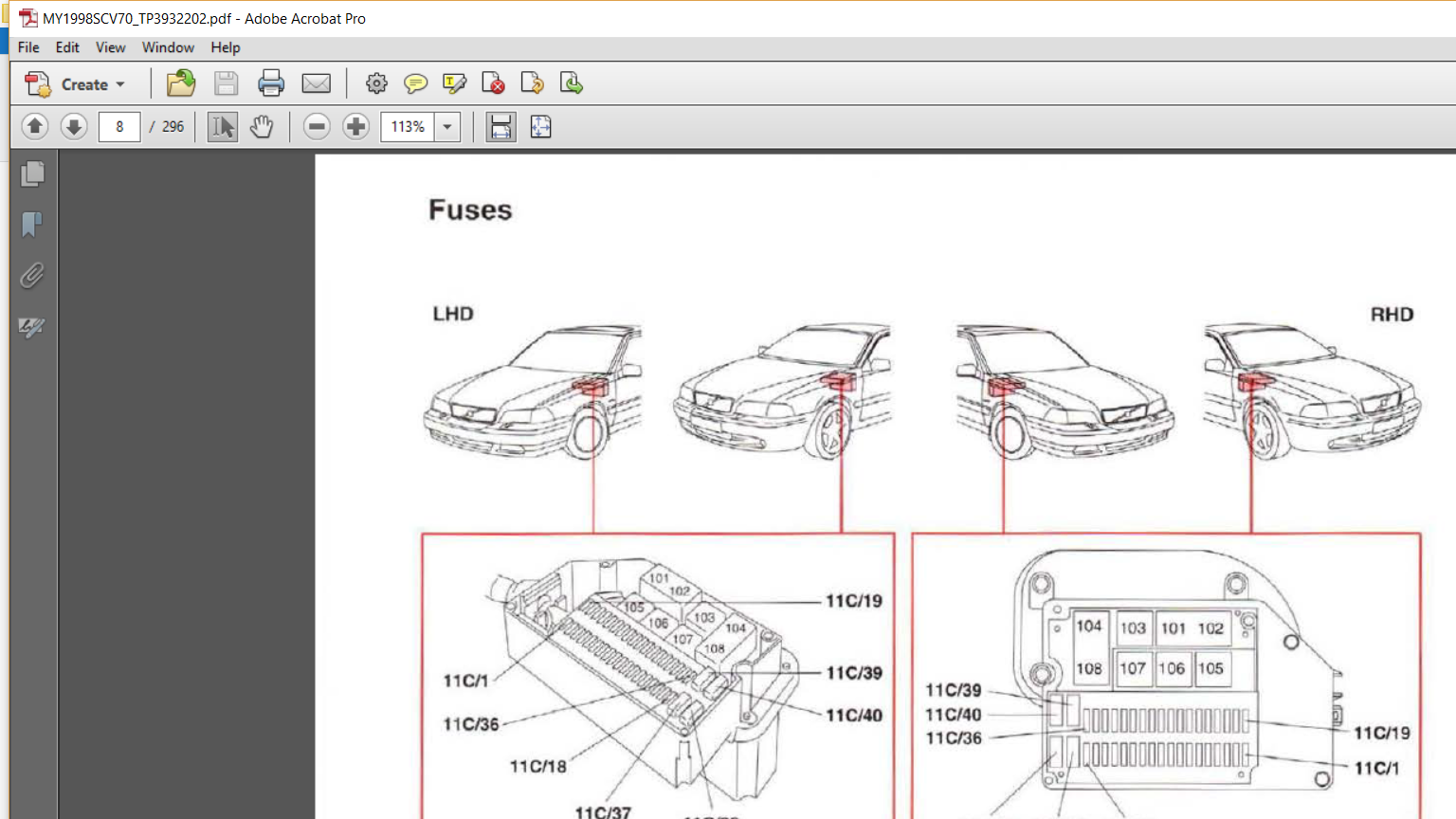

https://html2-f.scribdassets.com/60glxq ... b1046e.jpg
Here is what I'm looking at for the central locking circuit I'm not sure what I'm looking at any help?

Note that fuse 6 feeds 3 other fuses for central locking. Disconnect all 3 of them and see if fuse 6 blows again. If so, central locking is not likely the issue. Need to see what else is fed by fuse 6.
By the way, if you have an ohm meter, you don’t need to keep blowing fuses while testing. Just connect ohm meter between output side of fuse and ground. Keep disconnecting things until ohms go up significantly.

Pull fuses 11C/6, 11C/9, 11C/10 one at a time until #6 stops blowing. That will isolate the problem to one of the three branches.
11C/6 control module central locking/anti-theft alarm, Alarm siren, Movement detector (S70N70)
11C/9 Heated rear seat (S70/V70), Amplifier (C70)
11C/10 Ignition switch.
