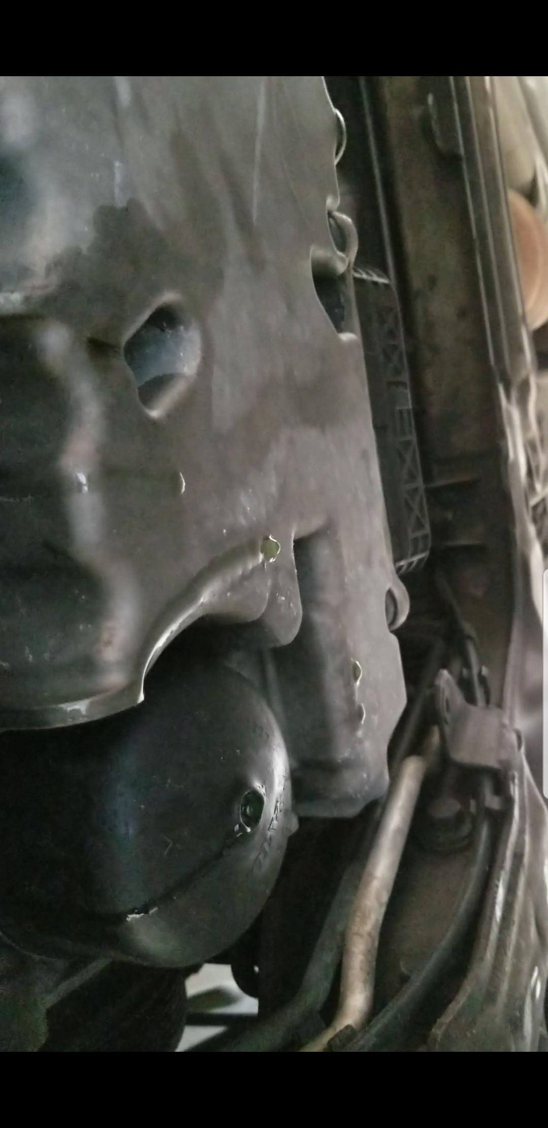

Need advice pls, I have attached a picture.
Passenger side under engine near oil filter coolant dripping. Is it due to thermostat housing? I don't recall disconnecting anything near that place when I replaced the radiator.

- Please post mileage b/c it is important in the discussion.
- You probably have > 200K miles. Check the coolant hose that runs along the PCV system.
You don't need to spend $200 for the whole thing. You can remove the old hose and use generic heater hoses + clamp.

Yes, exactly 200k miles. And how exactly is to get to this hose? From behind the engine?

Following pix may help a little.rakesh4404 wrote: 21 Sep 2018, 06:05 Yes, exactly 200k miles. And how exactly is to get to this hose? From behind the engine?

- Change the PCV. Some people reuse the oil trap. But all the associated rubber hoses must be replaced.
- The P80 850 S70 has some DIYs. I wrote a PCV trick for the 1998 S70.
- The main difference in the XC90 is the coolant hose and banjo connections. Just cut the Oetiker clamps off. Go to local auto parts to buy generic Gates heater hoses and clamps.

- If you don't want to deal with this again, then some people just plug the coolant openings with appropriate bolts/washers with the same thread pitch as the banjo thingy.

This is great info and I can get it done and do a write up for other.
I just want be sure on the hoses that I need to check for this leak. Can you please list the numbers from the above diagram which I have to check?
