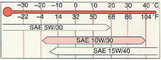

Shell ROTELLA T 15W-40 has SM, SL, SJ, and SH ratings
Good to about 10°F
Historically, Volvo has suggested heavier weight oils...I would never install 0w-40, 5w-30, or 5w-40 oils.
Semi-synthetic oils can be used in lower temps than indicated in that chart I posted above. 10w-30 in semi-synthetic has a lower temp rating.
I would stay away from synthetic or semi-synthetic oils, on an old engine.
