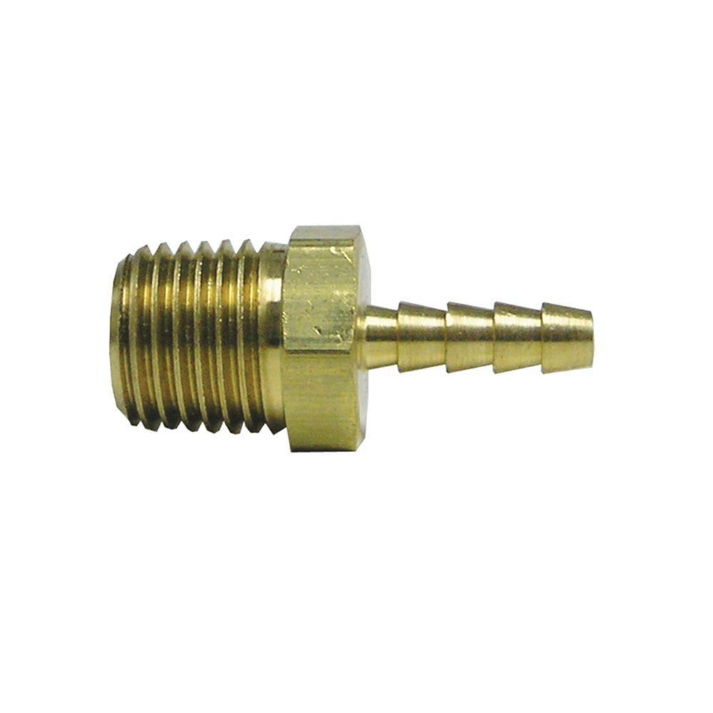

Perhaps one of these plus JB Weld? I think 1/8" is about the inside diameter of the hose and I would just need to drill a 1/4" hole at the site of the current hole.
https://www.homedepot.com/p/Everbilt-1- ... /300096270

That would work but it does look like a pipe thread on the left side. A straight thread with a nut would be a bit cleaner yo install.
