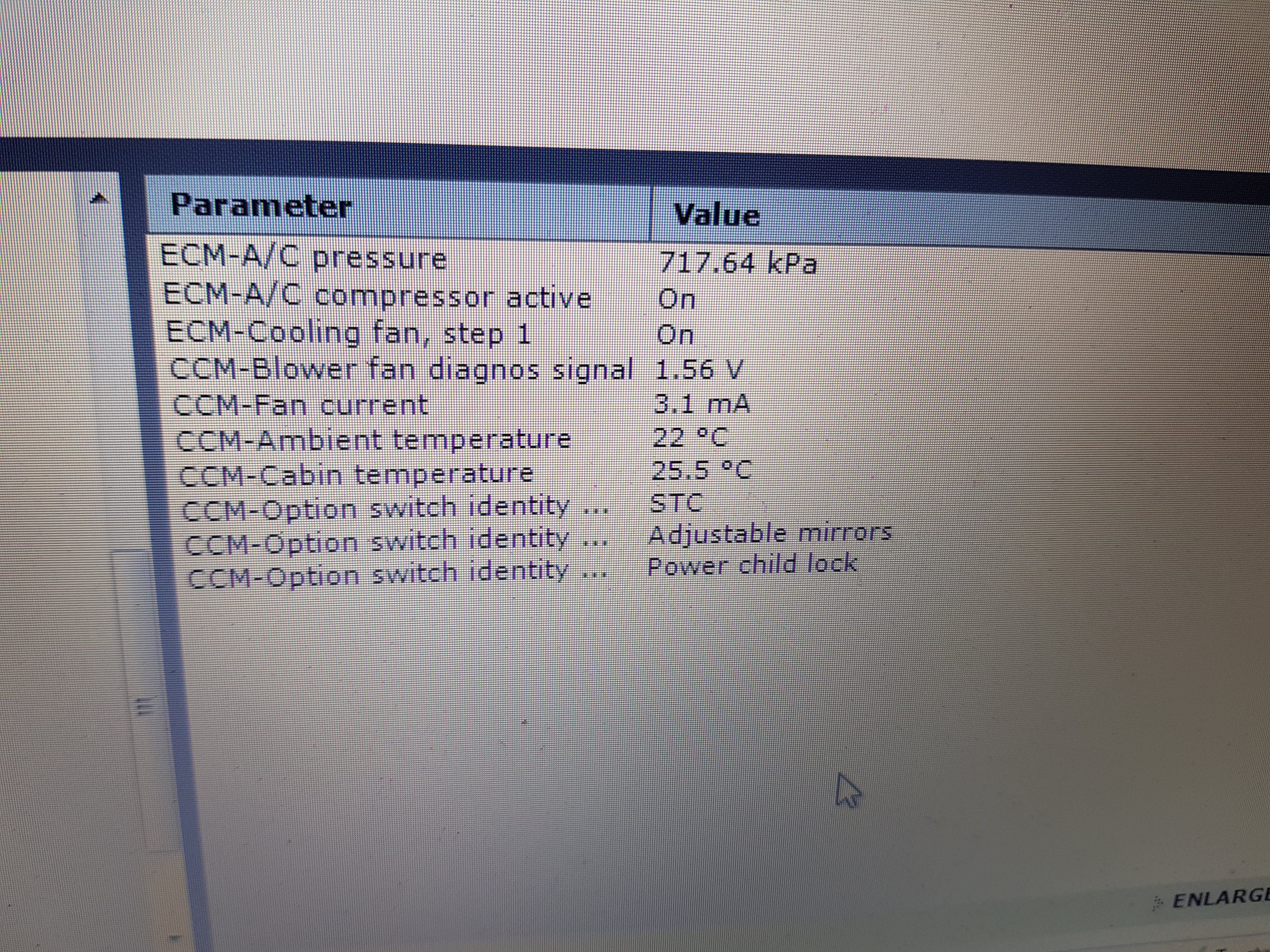

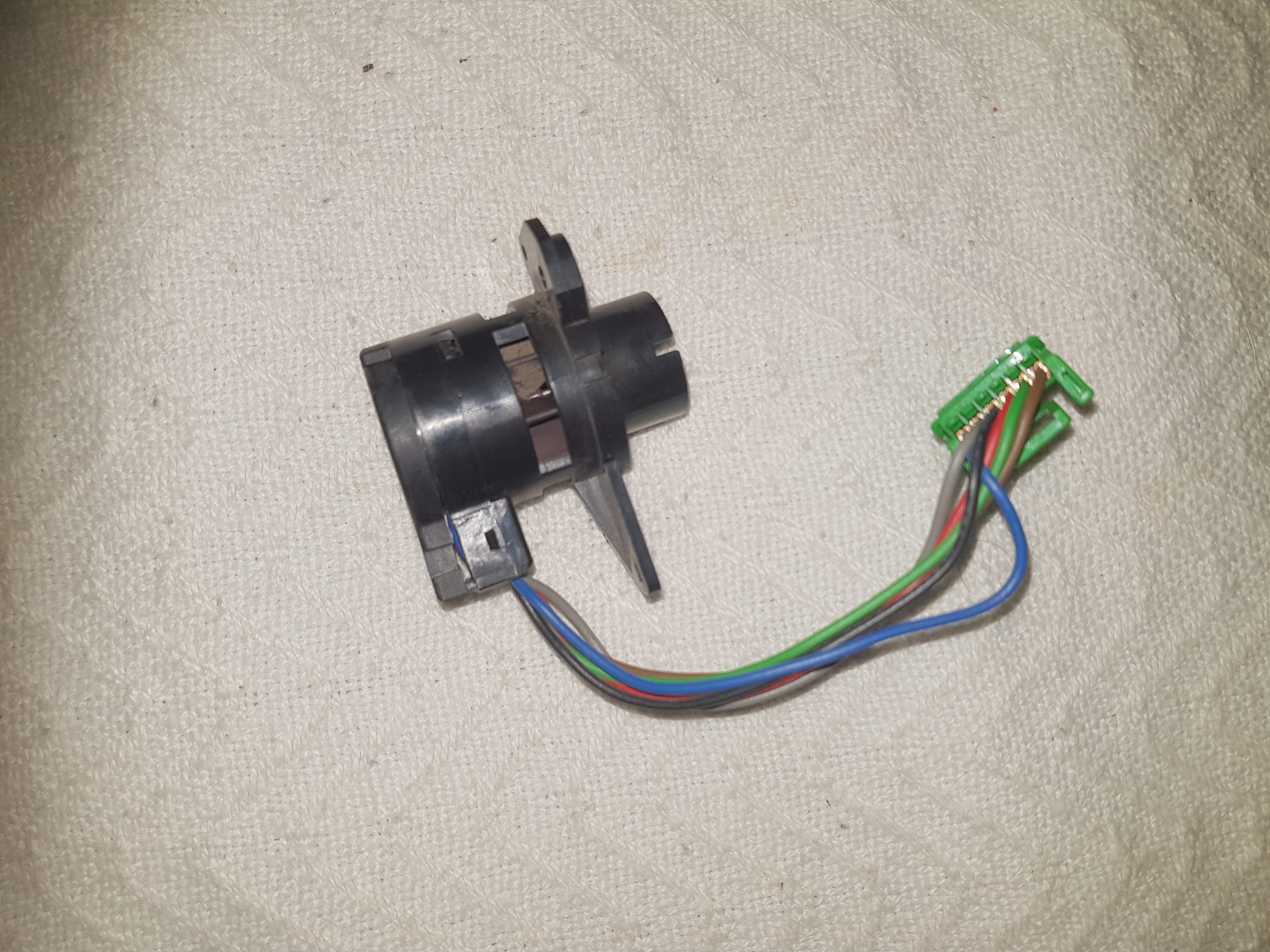

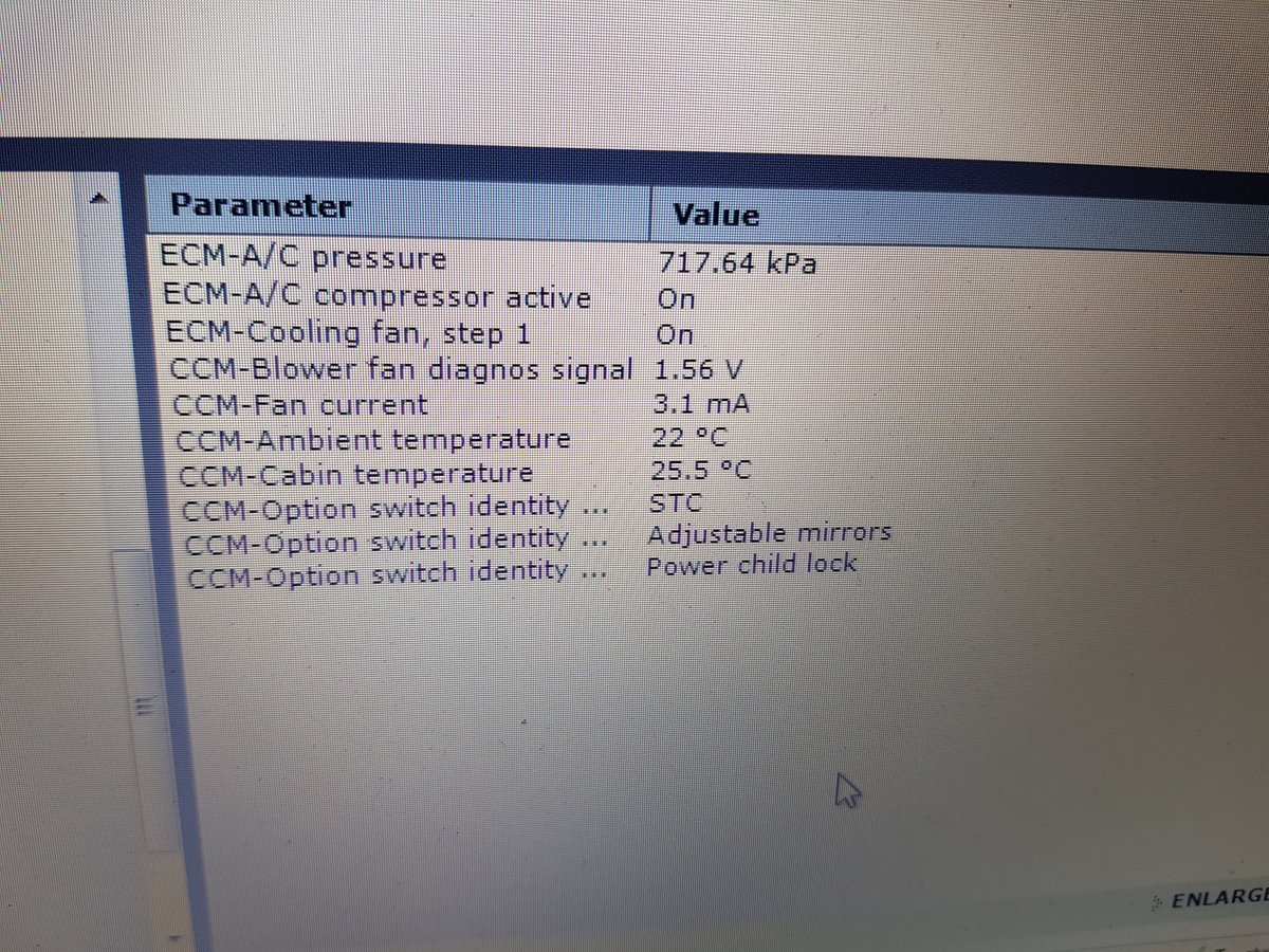

2) The small fan at the rear of the temp sensor on the Climate unit had failed. Vida diagnosed this with CCM-0003 low signal cabin fan (not to be confused with the blower fan which is another story)
The diagnostic search function in Vida said that CCM-0003 would prevent A/C operation. Upon looking at the tiny fan at the rear of the CCM sure enough it wasn't turning. I replaced the fan and Vida reported it was turning and drawing current. I drove around for a day and still the A/C was sporadic and intermittent so again back to the drawing board.
