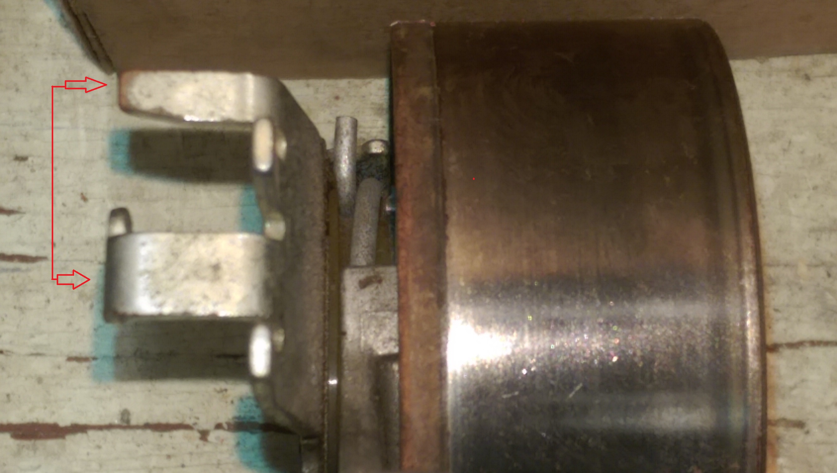

Part marked in Red fits into the block and the block keeps it from moving. If it not done right, it will move and the tension will be lost. The tensioner on the Volvo VDL Nedcars is different but the same principle.
You adjust the tension to temperature using the indicator and tighten the center bolt to 20 Nm (14.75124ft-lb).

The old tensioner seems fine and the new one does the same thing. I don't understand what's going on. After I have the timing set and the tensioner set I push down on the belt between both cam sprockets like it says to do and the tensioner goes all the way right and doesn't return.
