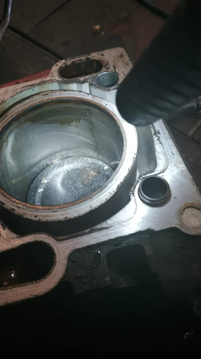

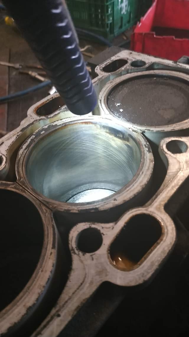

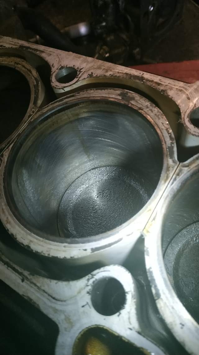

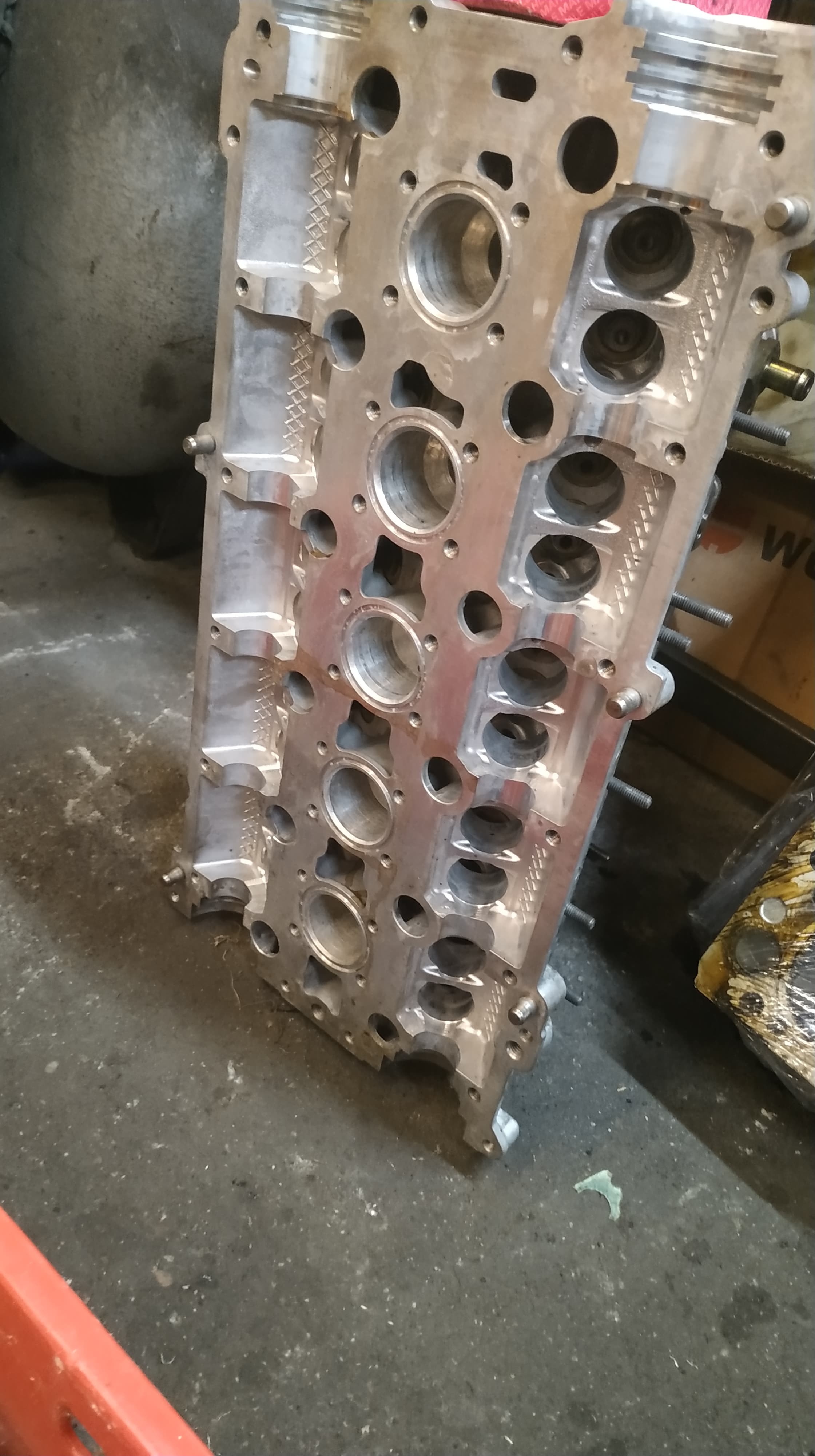

Thanks for the advice.
After finding a new Volvo specific little workshop near my city things are getting clearer.
I could write that "wors" but now we are progressing with the diagnostics and the "rebuild".
Definitely not PCV and the turbo center part is now hanging again a little but it was definitely the piston rings.
The engine is completely broken (a waste...) especially the 4th cylinder
Now they will do a rebuild.
The whole problem was coming out after some repairs and the first oil change that was made during the repairs.
I was buying the car from a guy at the beginning of this summer and was driving maximum 2k KM.
To bad that the previous owner was adding some oil conditioner to hide the problem.

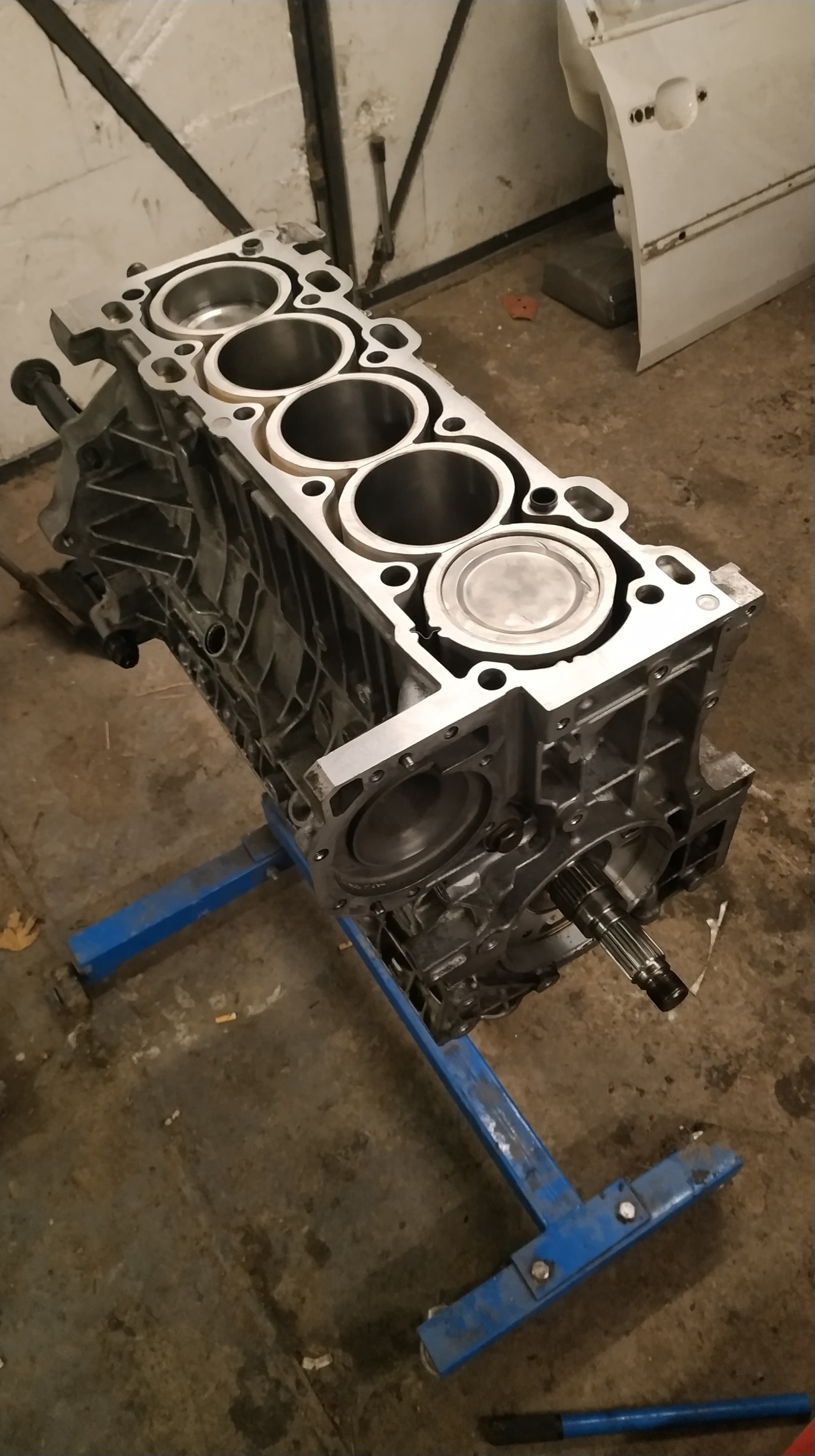

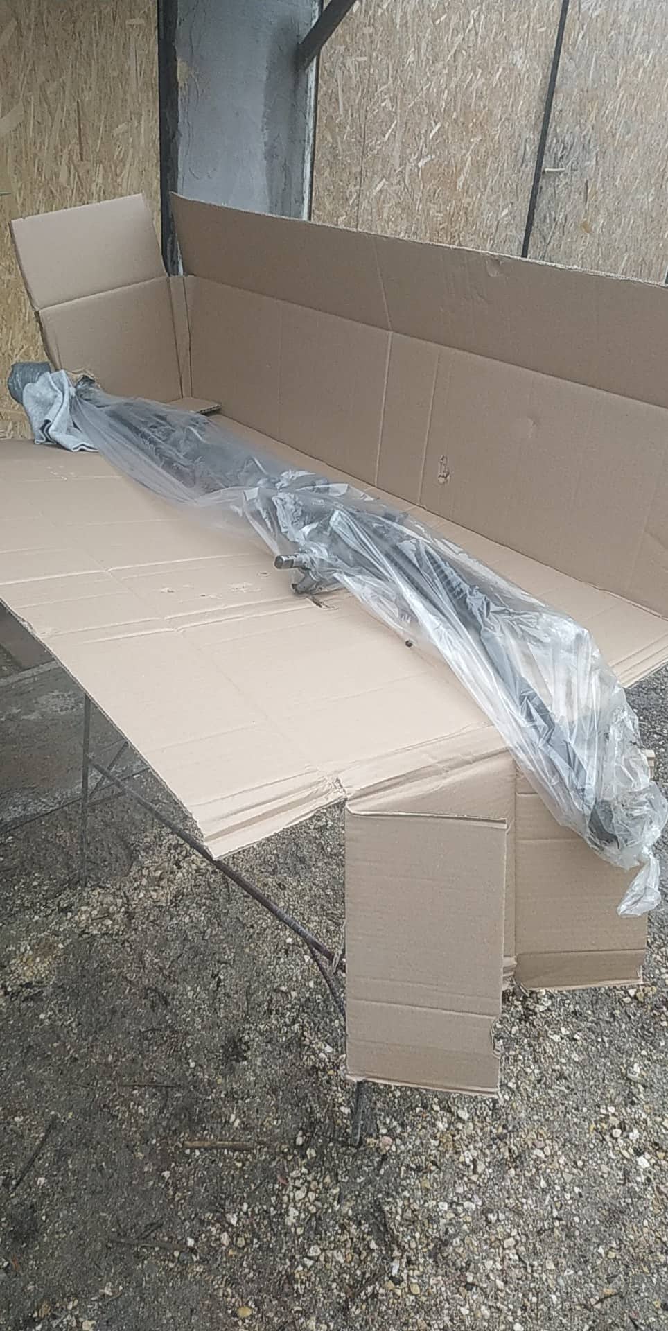

The rebuild is done.
Engine head fully renewed as the cylinders were switched to new ones and also piston rings and all related gaskets, bearings and belts were changed to a new one.
The list of other changes that were needed relating to the mileage (308 000 Km ):
I had the first 1000 Km, so the oil was changed again after the engine rebuild.
Sadly after a car wash, I'm experiencing ABS sensor problems.
Also, there was a one occasion check engine alert related to the turbo pressure sensor.
My dream car is slowly getting a shape that I want
Thanks for the care!
- Steering rack changed due to some signs of wear.
- Got a new set of front breaks installed.
- Automatic transmission fluid was changed. This one will be redone again with an automatic flush capable system.
