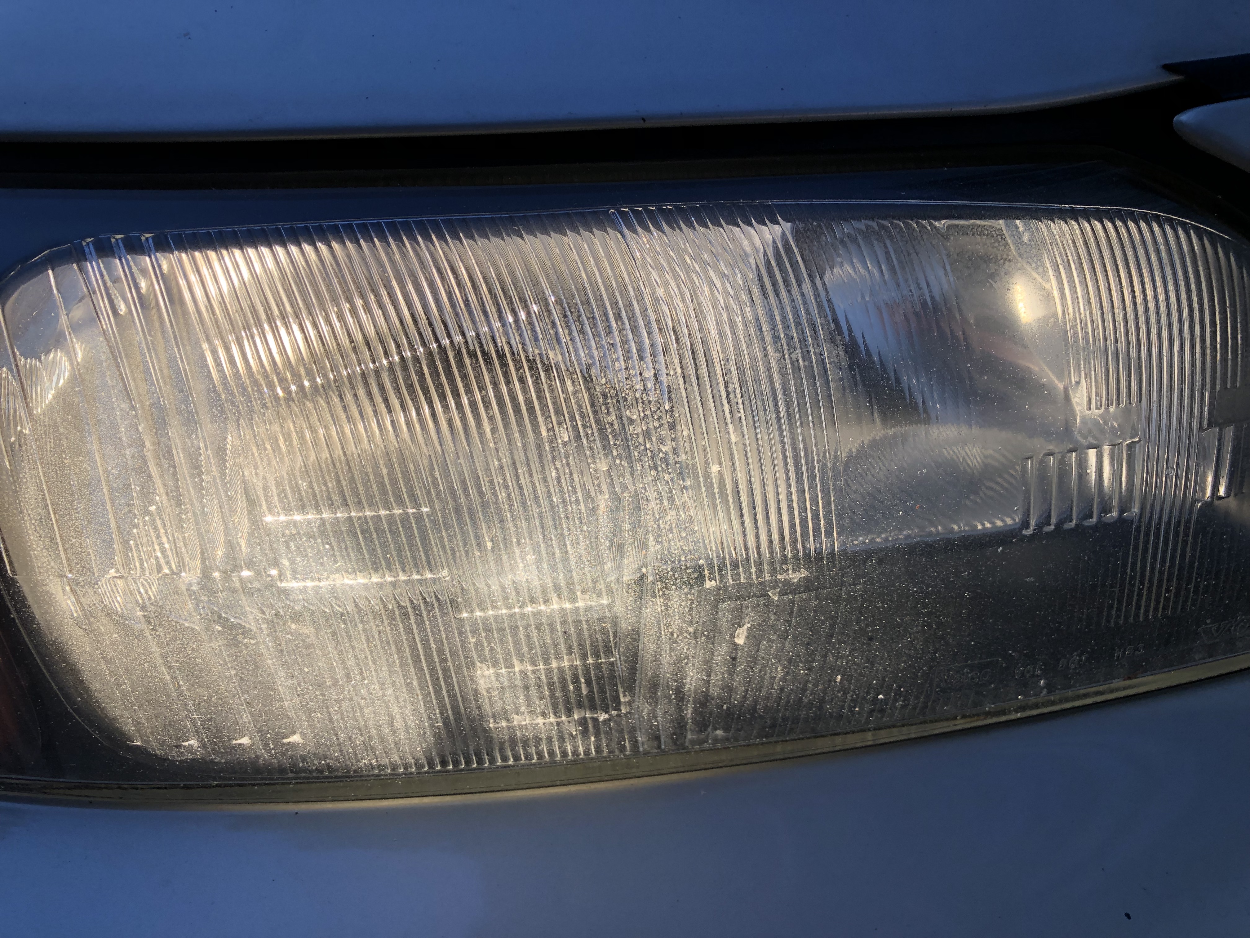

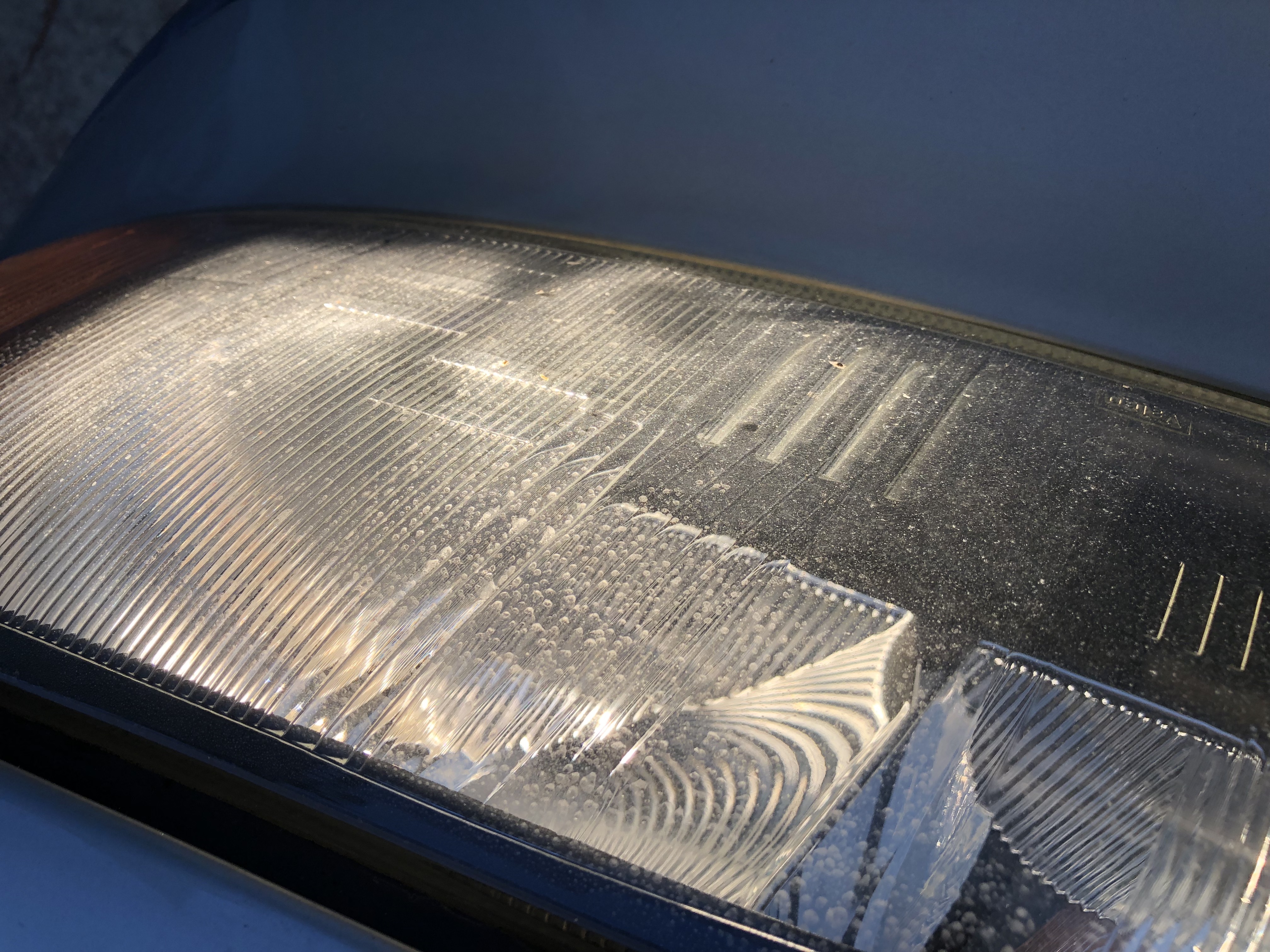

Thanks for all the comments. I installed Philips H7 X-tremeVision bulbs for the low beam. They replaced some "standard" Osram bulbs. After driving a few times at night I'm concluding that the new bulbs don't give me better light (no noticeable difference).
When I installed the bulbs I noticed that the inside of the lenses (the big glass part of the headlight) has a lot of wear on the *inside*. Other than replacing them, is there anything I can do about that?

On the inside? Could you upload a picture?

Hmm indeed, maybe try to salvage a nicer set from the breakers?
