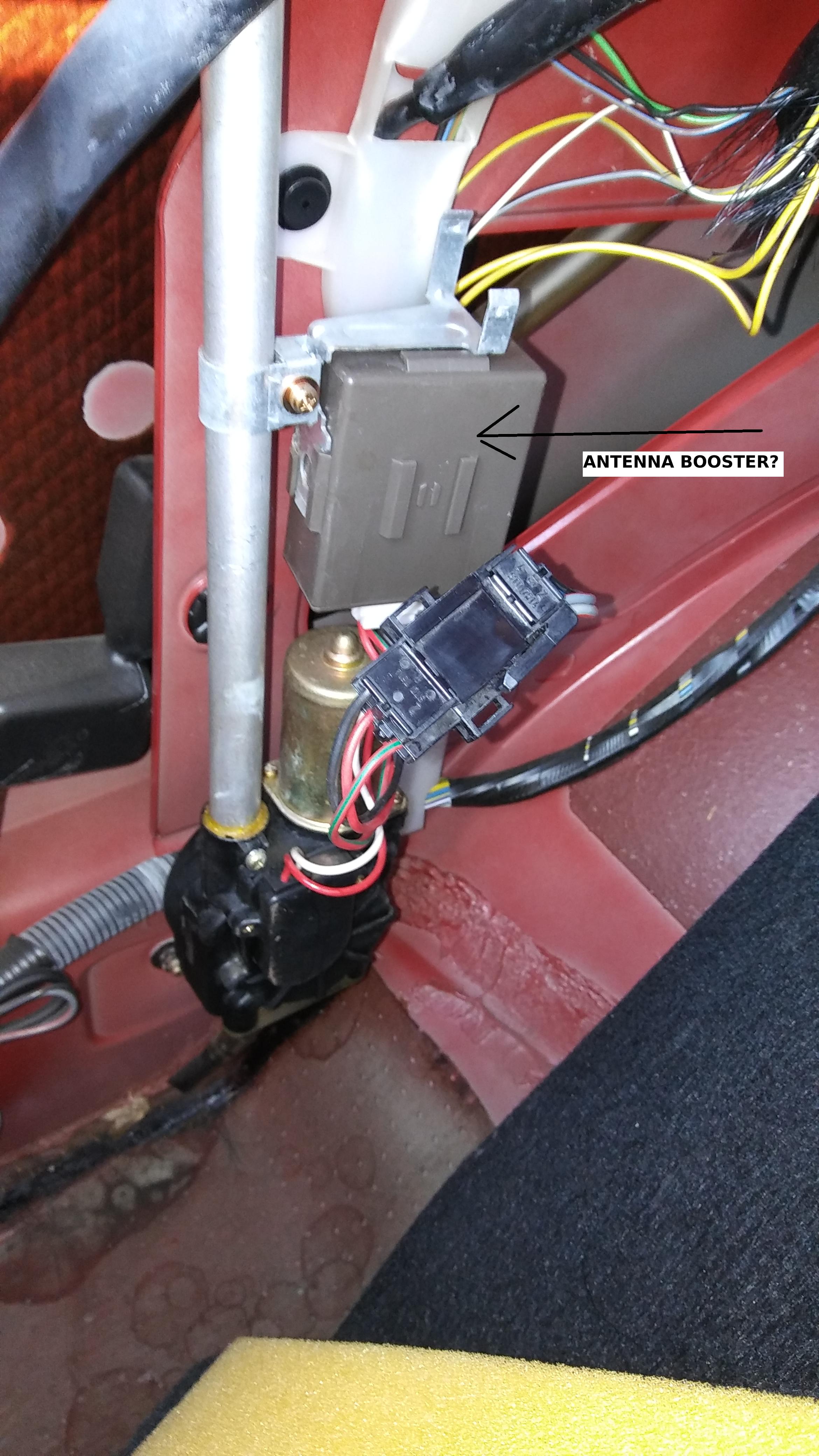

I got the radio to receive FM for a little while today but then it stopped again. I'm not sure the fault is in the antenna or the connectors as I originally thought. While running the car and the radio I again reseated all of the connectors (which was how I got it working before) in the freezing cold. I had to watch my hands to see what I was doing because I could barely feel them. I squirted plenty of contact cleaner on them. No joy. At this point I don't know what it could be. The way to test things would be to hook up another antenna-- I don't have one-- or another radio. I would not be averse to doing away with the mechanical antenna period and just having an ordinary manually-raised-lowered one. The only time I'd lower it would be to go through a carwash
The whole antenna assembly looks remarkably clean for a car that's 22 years old. There are no visible signs of corrosion that I can see. Again, AM reception works but is staticy on some weaker stations. Do '96 850 sedans have an antenna booster? I know the wagons do. That begs the question, can it be bypassed?![Image]()

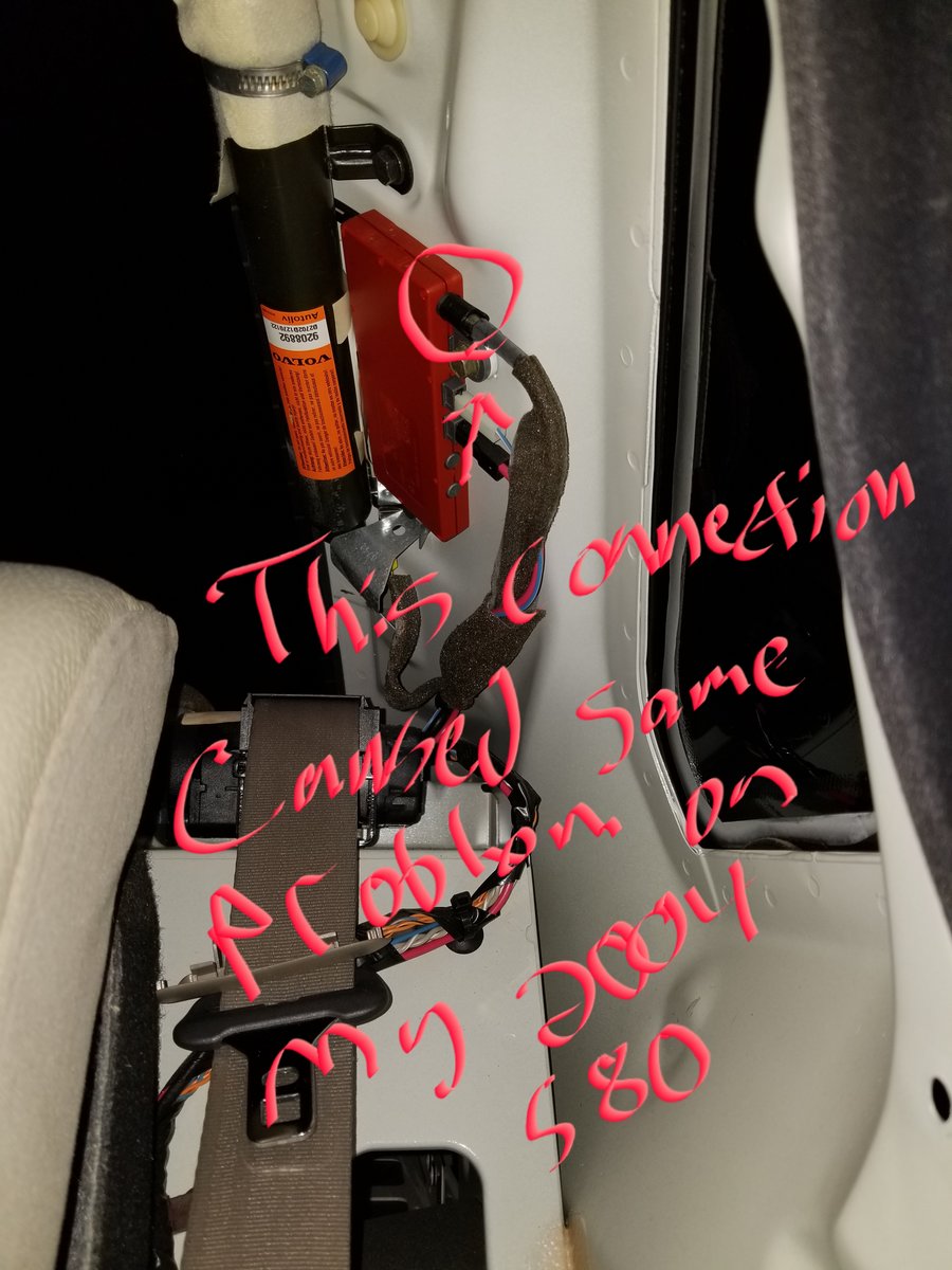

Here is a picture of my car's antenna booster. Mine had no reception for years. So when the panel was off for tint replacement I jiggled each connector until I found the problem. It is the antenna wire from the radio to the amplifier. I pulled it out and brushed it with a small wire brush and reinstalled it. My reception has been great since. The Male end on the wire was dull with oxidation. June

No. The amps were only used for hidden antennas like the
grids in the wagon side glass and back windows on S70s.
That box on your antenna is the relay for it’s mast motor.
