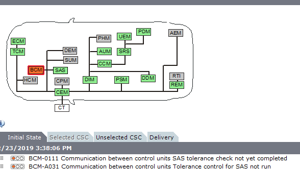

"Anti-Skid Service Required" message, BCM codes 0111 and A031 Topic is solved
veektor
- Posts: 92
- Joined: 06 Feb 2018, 11:48
- Year and Model: 2008 S60
- Location: Kansas City
- Has thanked: 3 times
- Been thanked: 4 times
I read the codes with DICE and got a whole bunch of them on first read, so I reset them, and only got these two.
I followed up with SAS calibration, and noticed that when my steering wheel is straight ahead, SAS is reading 180 degrees angle. Turning the steering wheel to the right is what gets the angle to zero when wheel is upside down. I found another post where the advice is to calibrate SAS using VIDA with the steering wheel off, but wondering if there is a better option? Or is that the way to go, then reset SRS codes afterwards? Thread in question: https://www.volvoforums.org.uk/showthread.php?t=287595
