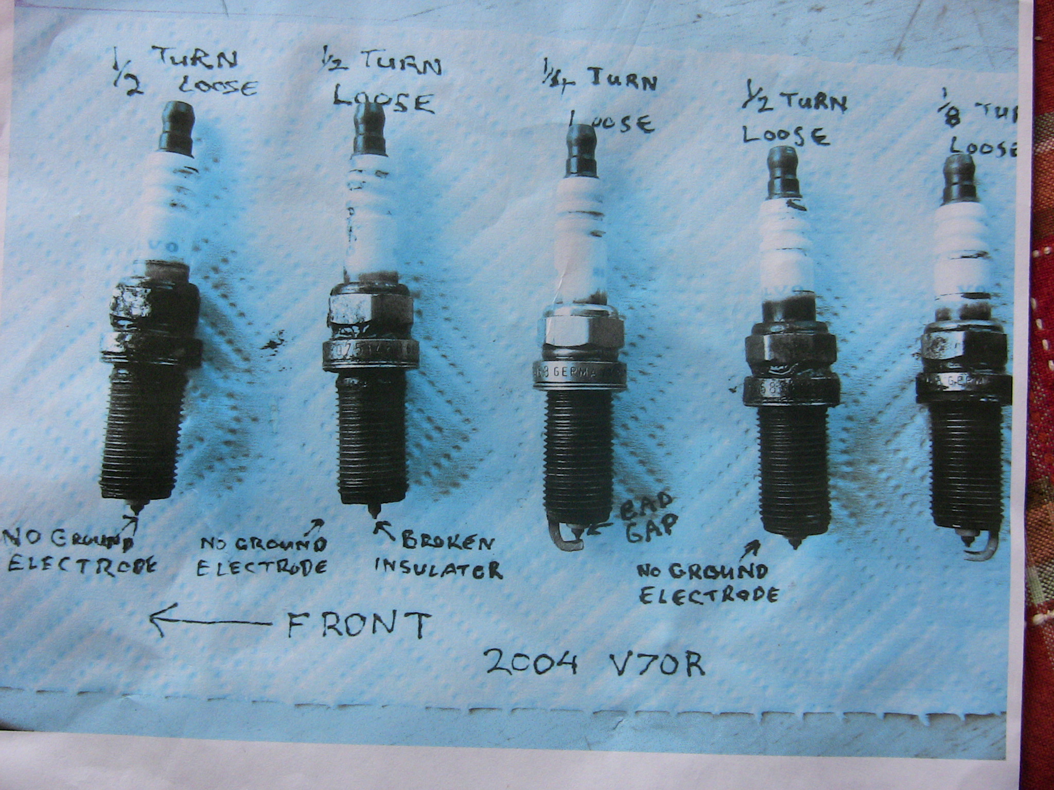

About three months after buying the car, it started running poorly. When I checked the plugs, all five sparkplugs were loose, and three of the electrodes had broken off into the engine. The dealer who failed to tighten the plugs properly would only replace the plugs, and sent me on my way. I was very concerned that the broken off electrodes might have caused internal damage to the cylinder walls, but that was five years ago. I'll do a leakdown test, and if there's anything odd, I'll do a boroscope.

It wouldn't be the turbo, that would smoke on hard acceleration. If you visualize engine breaking the throttle body is closed and there is high vacuum in the intake and piston chamber. therefore only valve seals, intake vac line to PVC, rings, head gasket. can supply oil. I would doubt head gasket and PVC (tiny 5mm line) so that leaves valve seals. I wouldn't consider rings except you could have scoring of the cylinder if the electrodes really broke off but Im skeptical of that. just because the plug is loose the electrodes can't fall off as far as I know. why do you say the spark plugs were loose and how did you find out?, the dealer wouldn't have fessed up. The normal result of a loose spark plug is seeing it shoot through the hood.

From front of car,
Sparkplug one, 1/2 turn loose, no ground electrode
two, 1/2 turn loose, no ground electrode, and broken insulator
three, 1/4 turn loose, virtually no gap, the ground electrode was almost contacting the spark tip (or whatever it's called)
four, 1/2 turn loose, no ground electrode
five, 1/8 turn loose, ground electrode intact, ok gap, fairly normal looking
