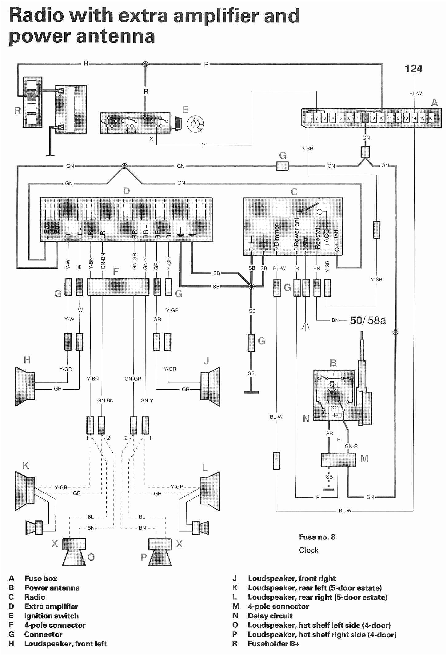

Footnote - Apparently, there were two different radios. One version powered a 4 channel amp, and the other version powered a two channel amp. See: CR-712 DIN Pinouts
Radio I have appears to power up a two channel amp, and radio itself powers front speakers only. I'll have to double check now that I learned this.
Volvo diagram for 4 channel amp version
international-truck-radio-wiring-diagram-unique-dorable-volvo-740-stereo-wiring-diagram-festooning-electrical-and-of-international-truck-radio-wiring-diagram.jpeg
But mine is like this, but a DIN is used to connect to a 2 channel amp
volvo-240-wiring-diagram-new-42-super-volvo-fuse-box-diagram-of-volvo-240-wiring-diagram.jpg
