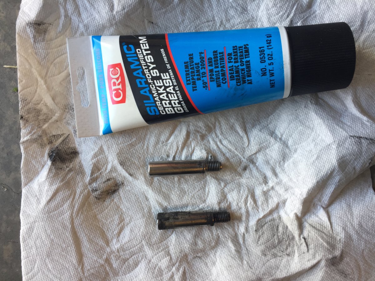

The exception to this is if the Slide Pins are not properly greased.
If the brakes get too hot then the grease evaporates and the pins don't slide well in the bushings.
To fix the problem I remove the pins and clean them and I use a high temperature Silicone grease.
Don't use a normal petroleum based grease (like wheel bearing grease) it will swell the bushings and then the brakes will drag and really make noise.
Personally I like Silaramic by CRC
Steps to clean and grease the slide pins
1. Remove the dust cap covering the slide pin
2. Remove the pin 7 mm Hex
3. Clean the steel pin using Carburator cleaner or similar (Don't spray the rubber bushing)
4. Add new grease to the bushing
5. Reinstall the pin
6. Reinstall the dust cap
good luck
