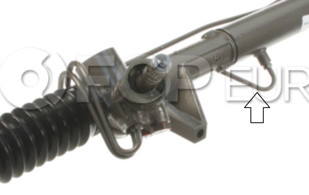

Members, I'm replacing a corroded leaking high pressure hose on my steering rack. (see attached pic) Is there a kit with fittings as I can't find a hose anywhere. Plus I don't believe I could install an OEM hose as it goes through the chassis.
Any ideas would be of great help. Thank you,

I was able to find a PS high pressure hose on amazon for a 95 940 (koyo) rack. FCP does not carry this part and the Volvo Oem is no longer available. Replacing the hose was pretty straightforward.
